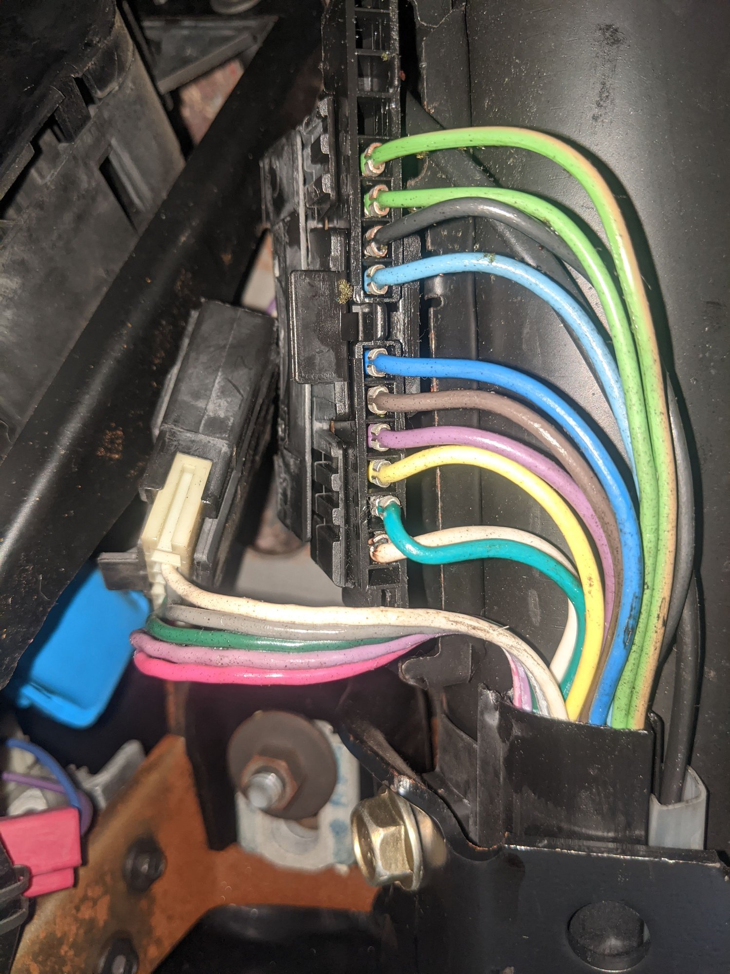

This was very helpful. Both the TS and hazards work so would you just recommend replacing the turn signal switch? When I looked under my dash yesterday I saw a connector that looks similar to the one which I am seeing when I look on the autozone website for the turn signal switch, specifically the colors on the connector. I remember yesterday a white wire at the end before the blue one being loose so I will inspect it (or even just order another).

Went to go mess around with the white wire and the pin just snapped right off the wire. Already have a new turn signal switch to put in so hopefully can get that done soon and we'll see.

Yes, unless the wire that's efffed up is the brake light one. I don't have a Firebird manual to look up the color codes to be sure.
Yes also, that is the TS sw connector. The wires you can see in the photo go up through the column and are permanently made onto, and therefore part of, that switch. If they're messed up, just change the switch. When you do that, attach a string or dental floss or something to the old one before you pull it out, and use that to pull the new one down the column.

I'm very much hoping this is the issue. Regardless, this connector needs to be replaced as some of the other pins are moving as well and the white wire (which I believe links to the brake light switch) does not have a pin anymore. Fingers crossed!

Just wanted to say thank you for your advice. Just got done putting in the new turn signal switch and voila! My brake lights work again! I would have definitely overlooked this if it was not for you so I greatly appreciate your advice.
