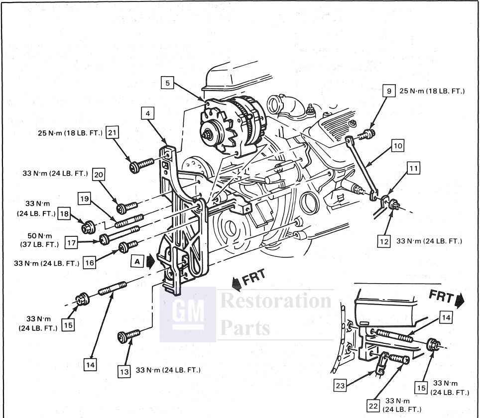

I searched on the forum and my manual but could not find the torque specs. I will be swapping my alternator to a powermaster and I want to know what I should torque the bolts to on my 90 Camaro RS. Thanks

Thank you!
