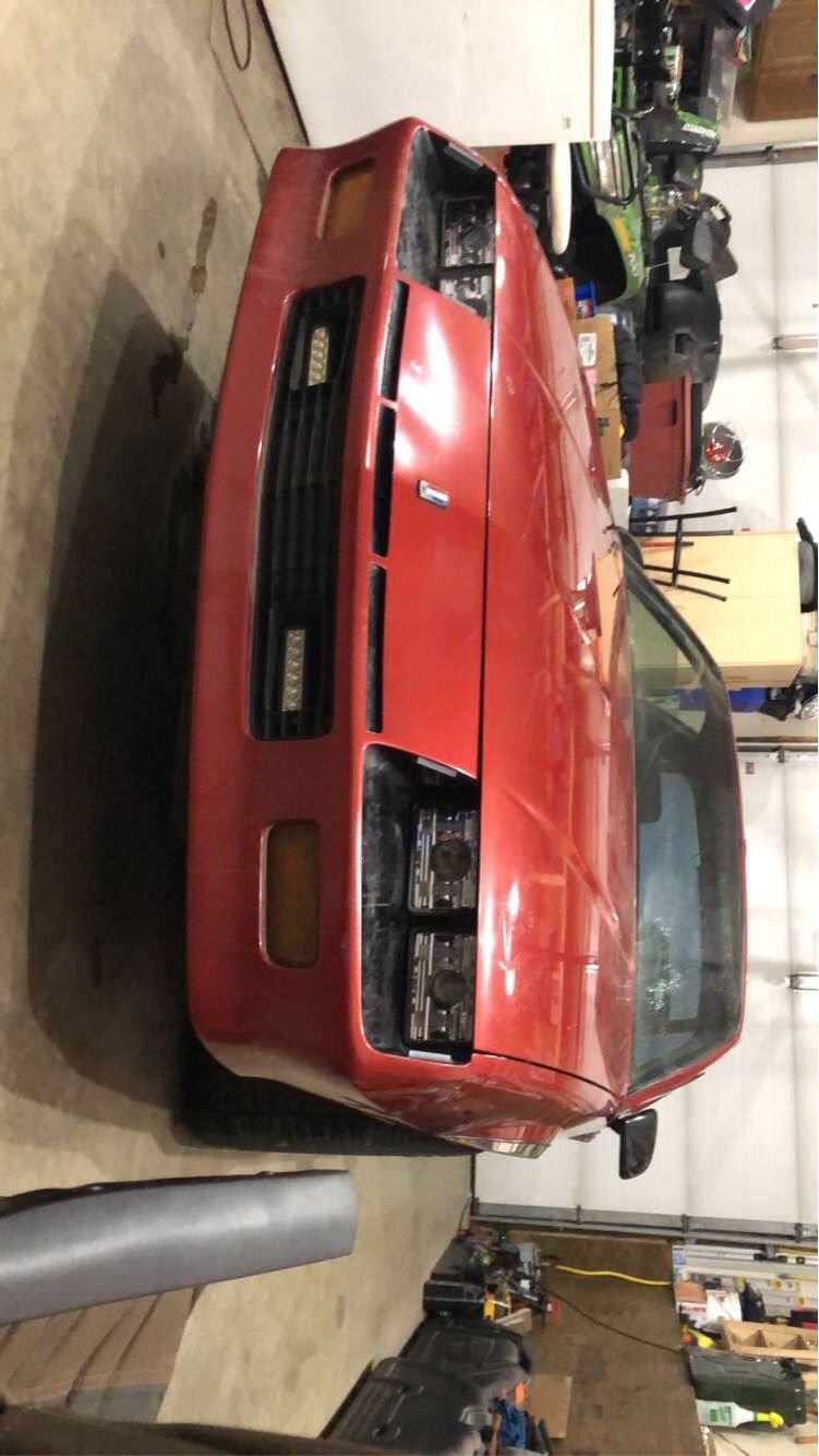

I just got in my LED headlights installed and wow the difference on the amp draw and brightness is unbelievable.
