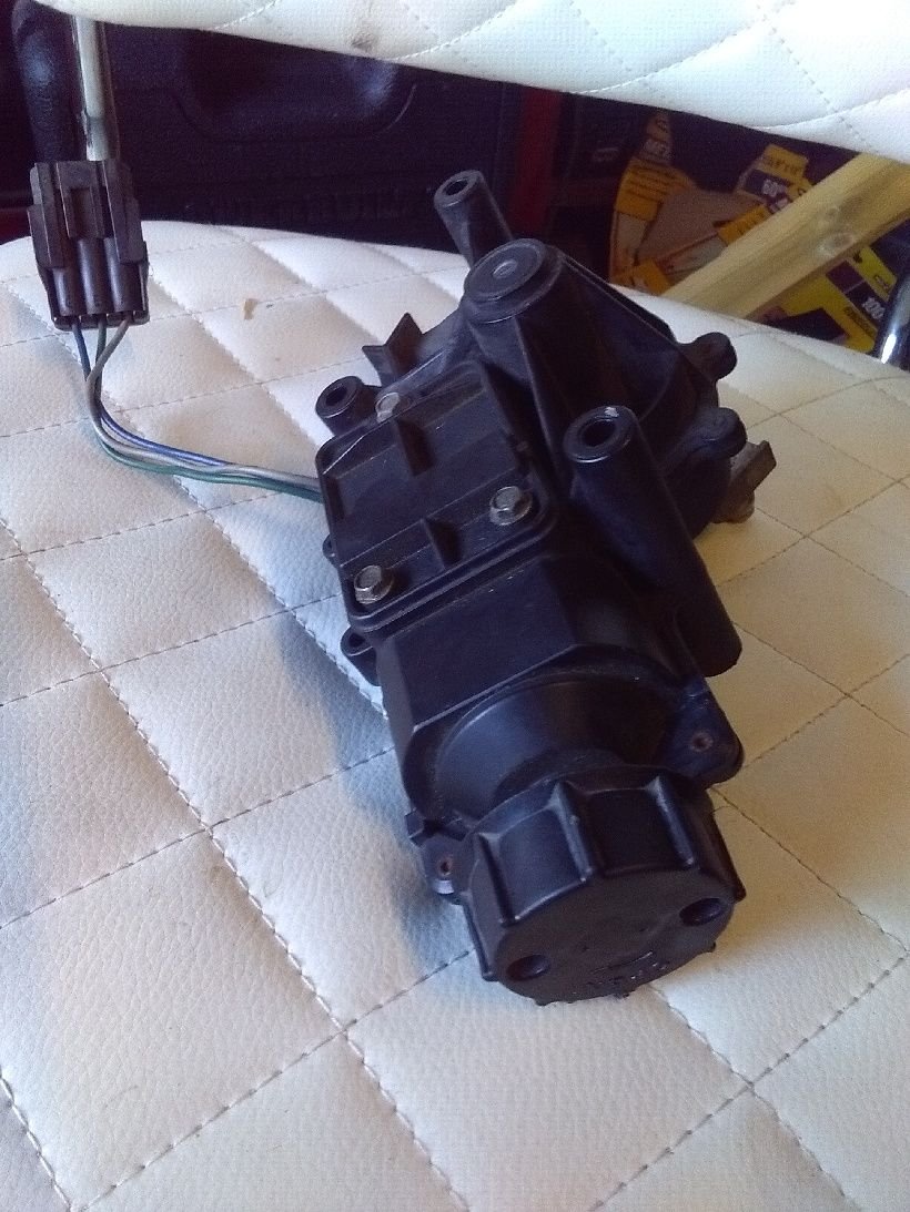

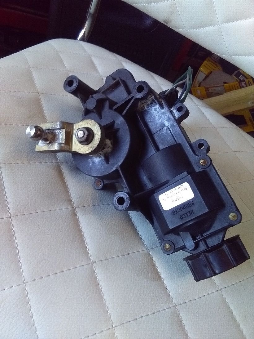

My 1986 Trans AM's driver side pop up head light has started to misbehave so I removed the motor to look into the matter. I have heard about the rebuild kits online, such as replacing the internal bushings and plastic gear with a brass or aluminum unit. I do not see many kits advertised for the pre 87 cars. After pulling the motor out I noticed it looks like the motor is "sealed" and not serviceable. See attached pictures. I firmly believe the internal gear is stripped on the inside based on how the headlight is erratically functioning. ( it goes up halfway, or the motor actuator will continuously run, etc). Can someone tell me if I must replace this motor as a whole or am I supposed to drill out the rivets holding the motor together to gain access to the gear and bushings?

Check out Top down solutions as he has parts to fix the order headlight motors.
Headlight Motor Kit: 82-86 Firebird or Fiero
  • Brand: TDS
  • Product Code: 508210
