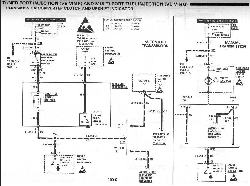

-The Light Blue wire, the Tan with a Black tracer-stripe wire, and one of the Purple wires are used for the Automatic Transmission Torque-Converter Clutch.

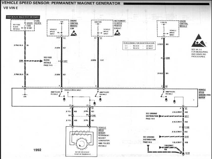

-The Yellow wire, and one of the Purple wires are used for the Vehicle Speed Sensor.
You are going to have to determine which Purple wire is used for which System.
Both the Torque-Converter Clutch wiring and the Vehicle Speed Sensor wiring go to the Transmission at one end of the wiring.
The VSS wiring goes to the Speedometer Buffer at the opposite end of the wiring.
The TCC wiring goes in three different directions (one for each wire):
-Light Blue goes to the PCM (Power-Train Control Module).
-Tan with a Black tracer-stripe wire goes to the ALDL (Data Link Connector).
-Purple goes through the Brake Pedal Position Switch and then to the "Gages Fuse" in the Instrument-Panel Bussed Electrical-Center (IPBEC).

The Schematic for the TCC wiring is shown below:
The Schematic for the VSS wiring is shown below:
