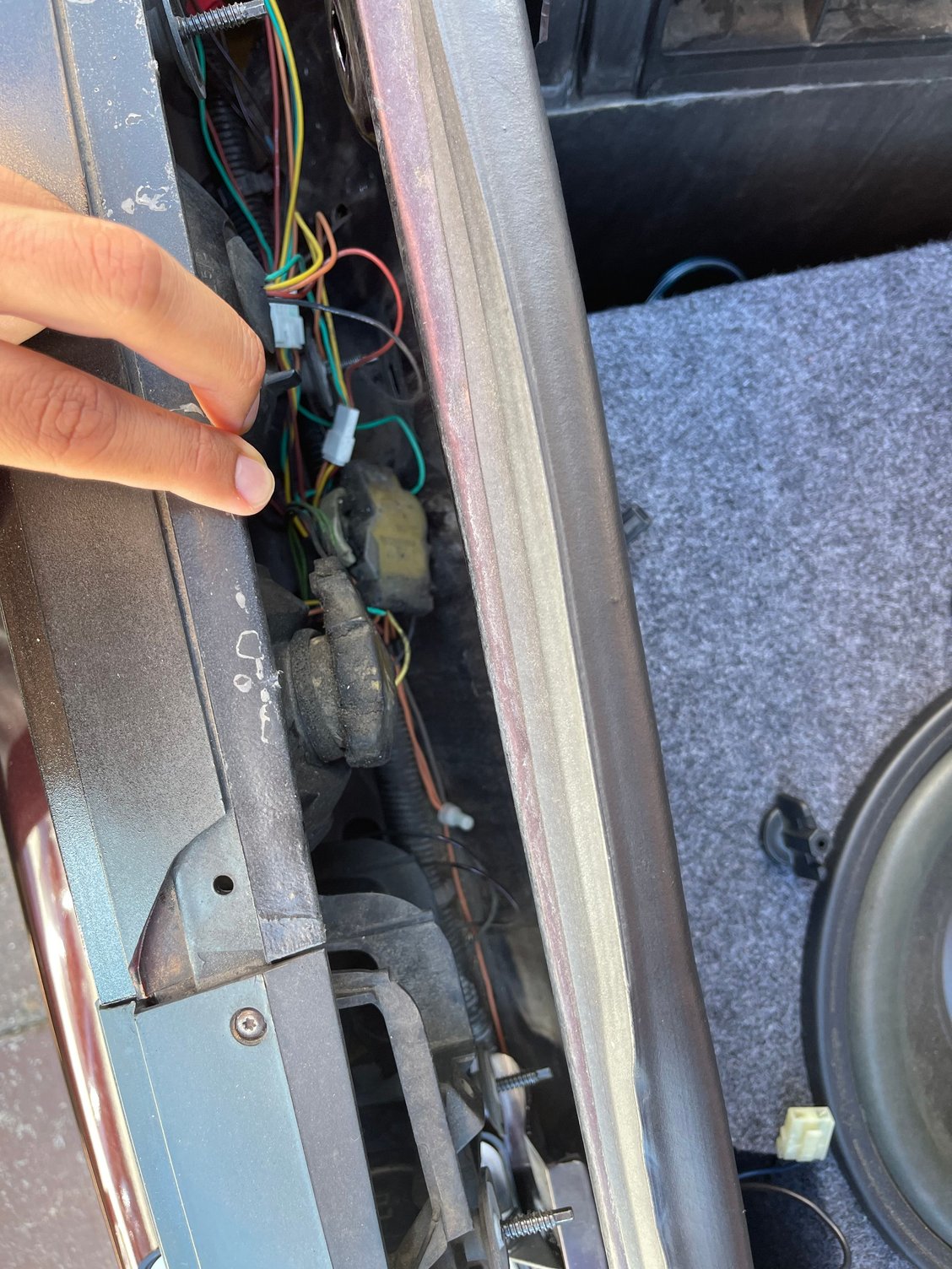

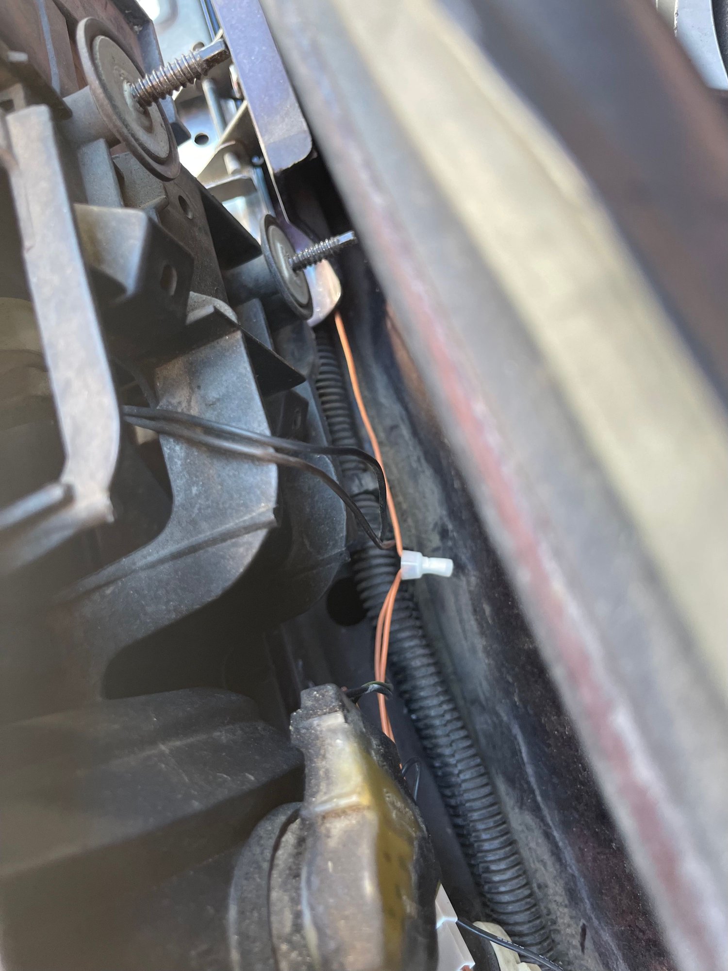

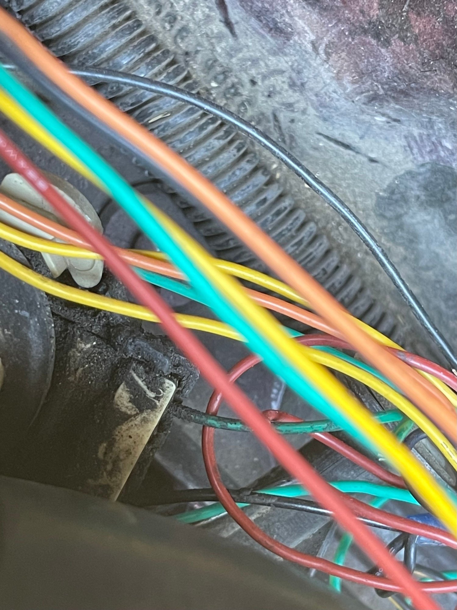

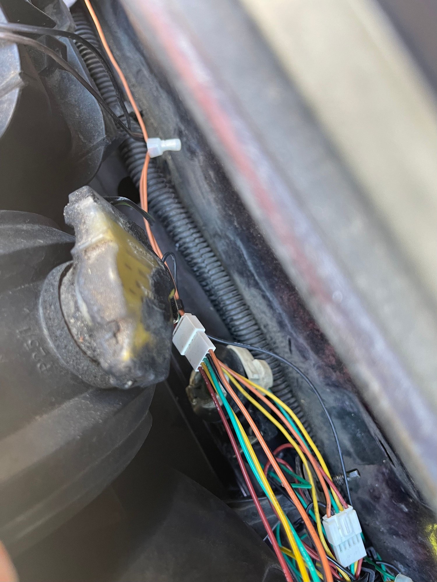

Old Jul 5, 2021 | 06:06 PM
91vertZ28's Avatar
Joined: Nov 2017
Posts: 147
Likes: 8
From: California
Car: 1991 Camaro Z28 Convertible
Re: Digi-Tails led panels installed , turn signals not flashing
so i took photos and this is the left side wiring:
and here is the Right side:
Old Jul 5, 2021 | 06:25 PM
vorteciroc's Avatar
Top Answer: 1
Joined: Jul 2006
Posts: 2,924
Likes: 803
From: 212 is up in this Bit@#
Who did that absolutely horrible Wiring for you???
Does someone not produce a "Plug and Play" adapter or replacement Harness?
Some days I feel like I should just change my Business to a "Third-Gen" ONLY Wiring Business.
LOL, I definitely do not believe there are enough Third-Gens left to keep me in Business.

Old Jul 5, 2021 | 06:32 PM
91vertZ28's Avatar
Joined: Nov 2017
Posts: 147
Likes: 8
From: California
this body shop i had install them. so i was thinking to just undo the wiring they did and re do it and route it cleaner than they did if it is horrible looking. im glad the lights work fine now though lol. uhhhh im not sure it the wiring was plug and play but the only hard part seemed the actual opening up of the lens housings . the wiring i can tey and clean up.
Sorry man.
If an Auto. Insurance Adjuster saw that work done at a Business...
I believe they would refuse to pay for the work.
Sheeeesh!
