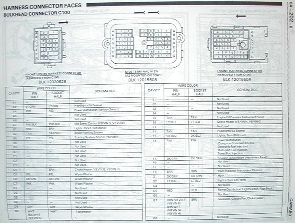

hey what’s up buddy I have a 87 Camaro used to be a 2.8 V6 now it’s ls 5.3 with a 4l60e and I’m trying to get my dash worth cluster to work I got all the wires for my coolant my gas and my temperature I’ll try to get my RPMs to work and I bought a module from DeCora digital for the speedo and I was wondering did you know how to get to RPMs to work

Grave dig. Theres a tac wire coming off of the ls harness youll have to look at the pinout for your motor. Wire that to pin D6 on the C100 bulkhead connector beside the brake booster.
