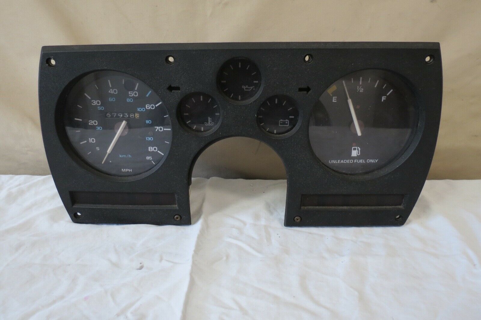

I'll try to figure out how to post a picture, but the speedometer is a needle, fuel is a needle, the rest are a light (I'm assuming a bar when it's working) instead of a physical needle
If your cluster looks like this:
You have the base instrument cluster. The 3 being smaller circles are warning lights.
The oil light and volt light should be on anytime the key is on and engine off because the engine does not have oil pressure when not running nor is it spinning the alternator to produce charge. When the engine is running, the oil and volt lights should be off.
If you had the full instrumentation, you would have two large gauges (speedometer on the left, tachometer on the right with an oil pressure within) and 3 smaller gauges (volt, temperature, fuel gauge).

Thank you! It is as pictured. I don't like that it's not one that will give an indication of where the temperature is etc. Do you know if it's possible to replace it with another model from another camaro that does give actual indications instead of just warnings?

Yes, it's possible and has been done. You will have to switch some wiring connections around however...
