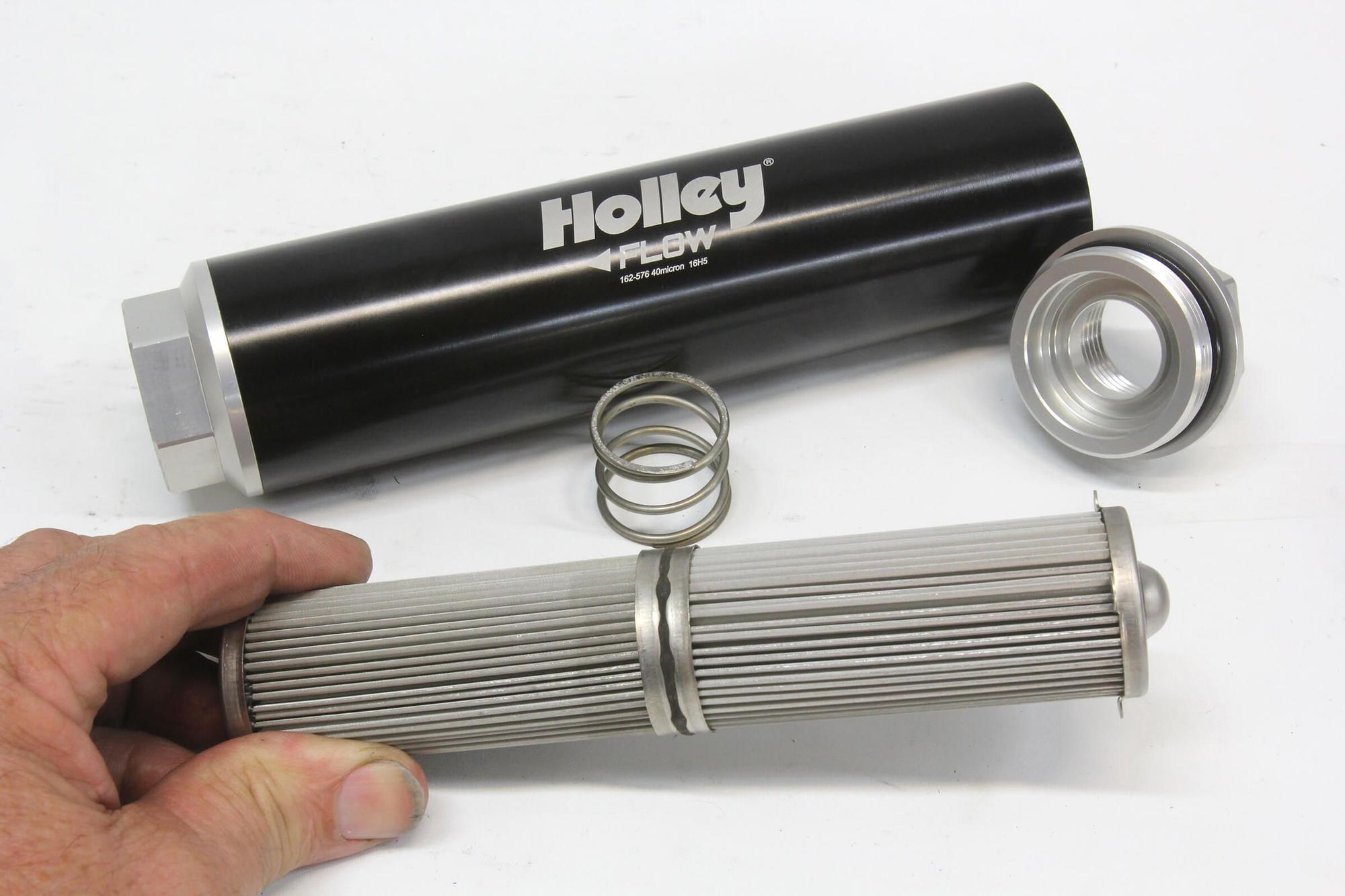

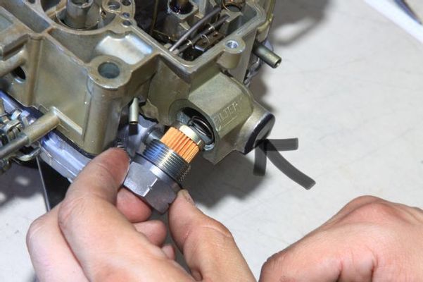

Indeed, the Fuel Filters of the past...
Were intended disassembled, cleaned-out, and have a new Filter-Element installed.
Some Carburetors still use replaceable Filter Elements...
And most of the really large. high-flow Fuel-System Filters have replacement Fuel Filter Screens or Elements:
Exactly, "And have a new Filter-Element installed"
From the OP's description, I didn't see the "New Filter-Element" mentioned, just something about "cleaned fuel filter on carb" , which is why I wasn't going there.........
