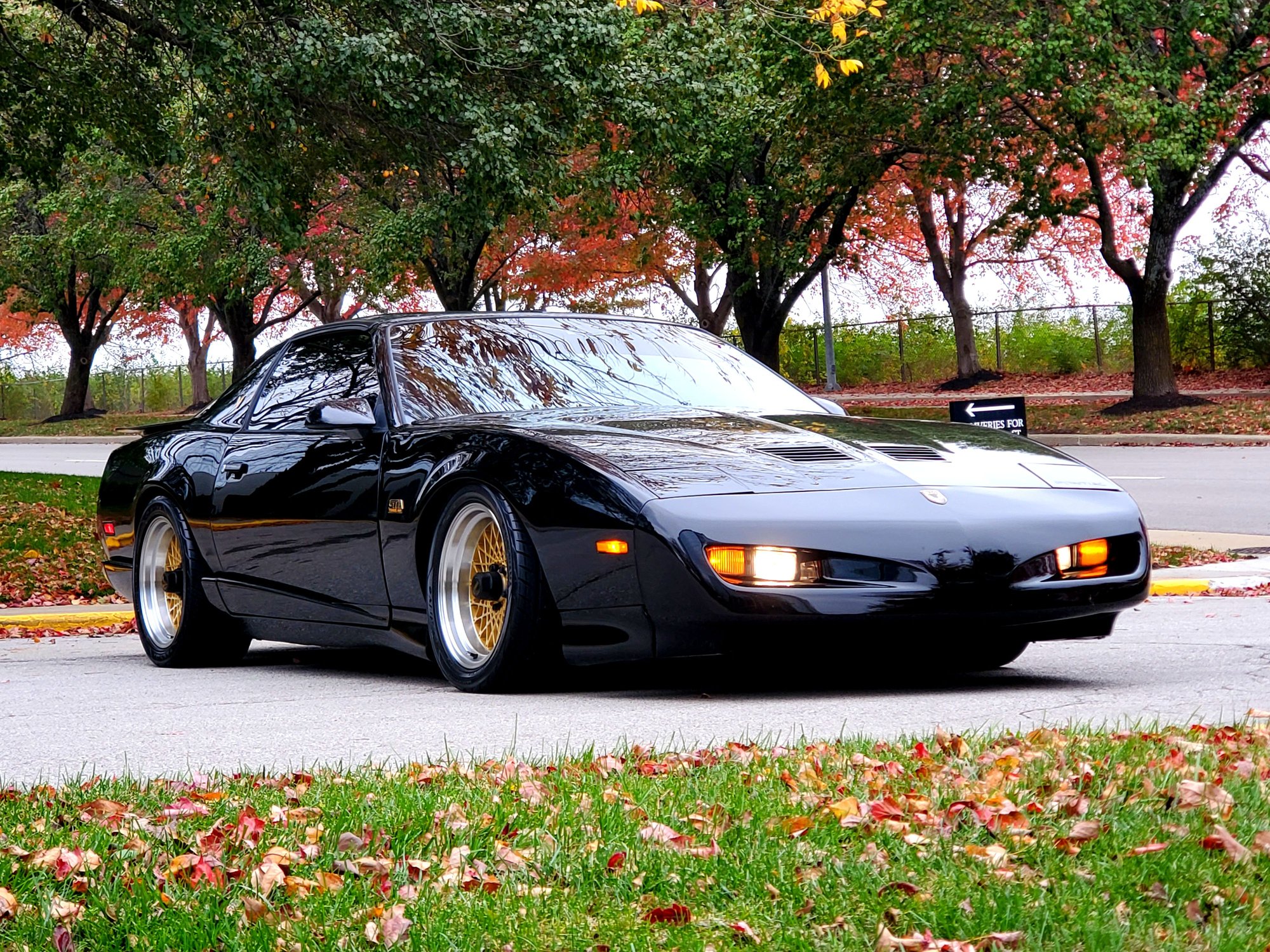

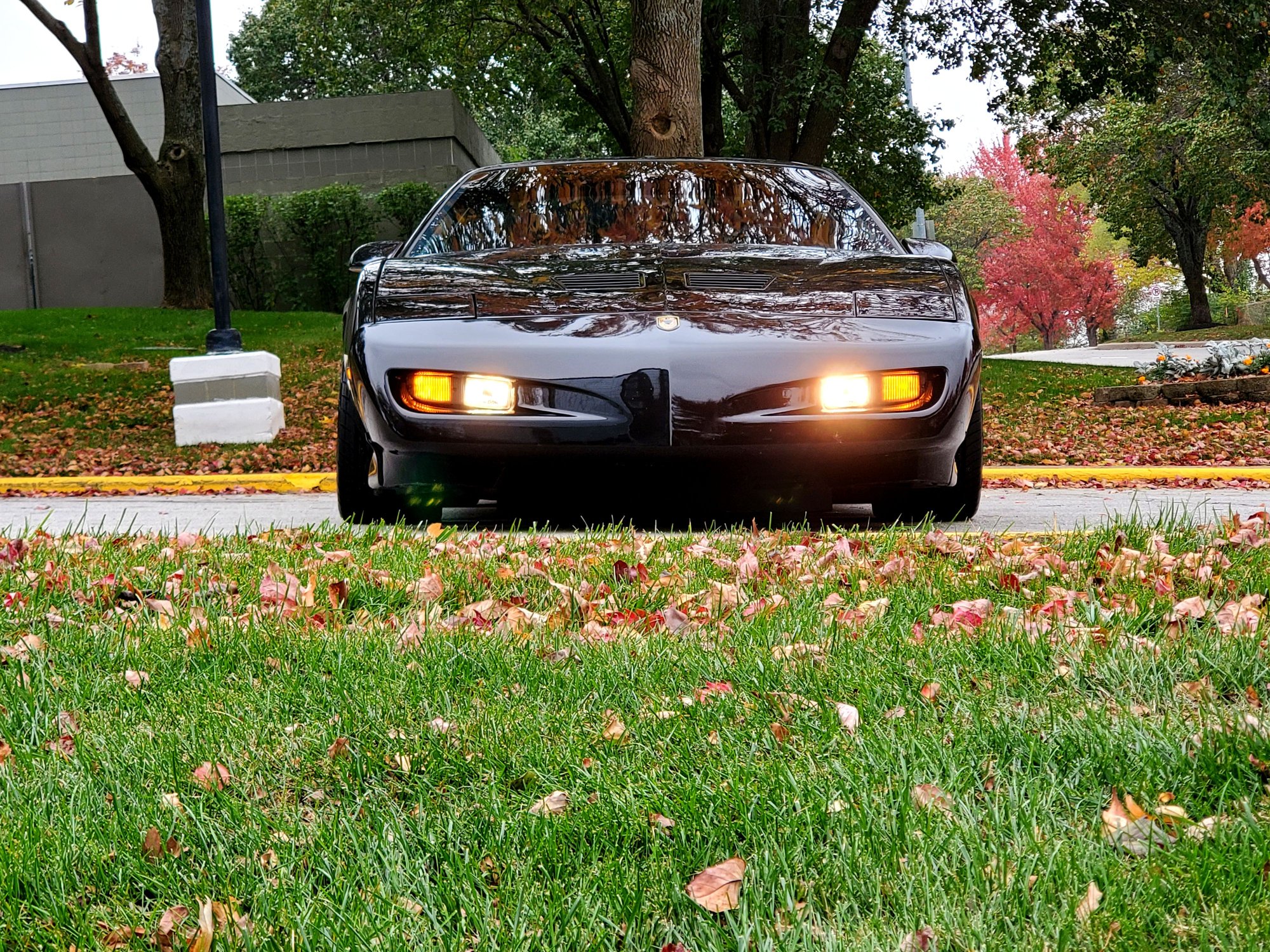

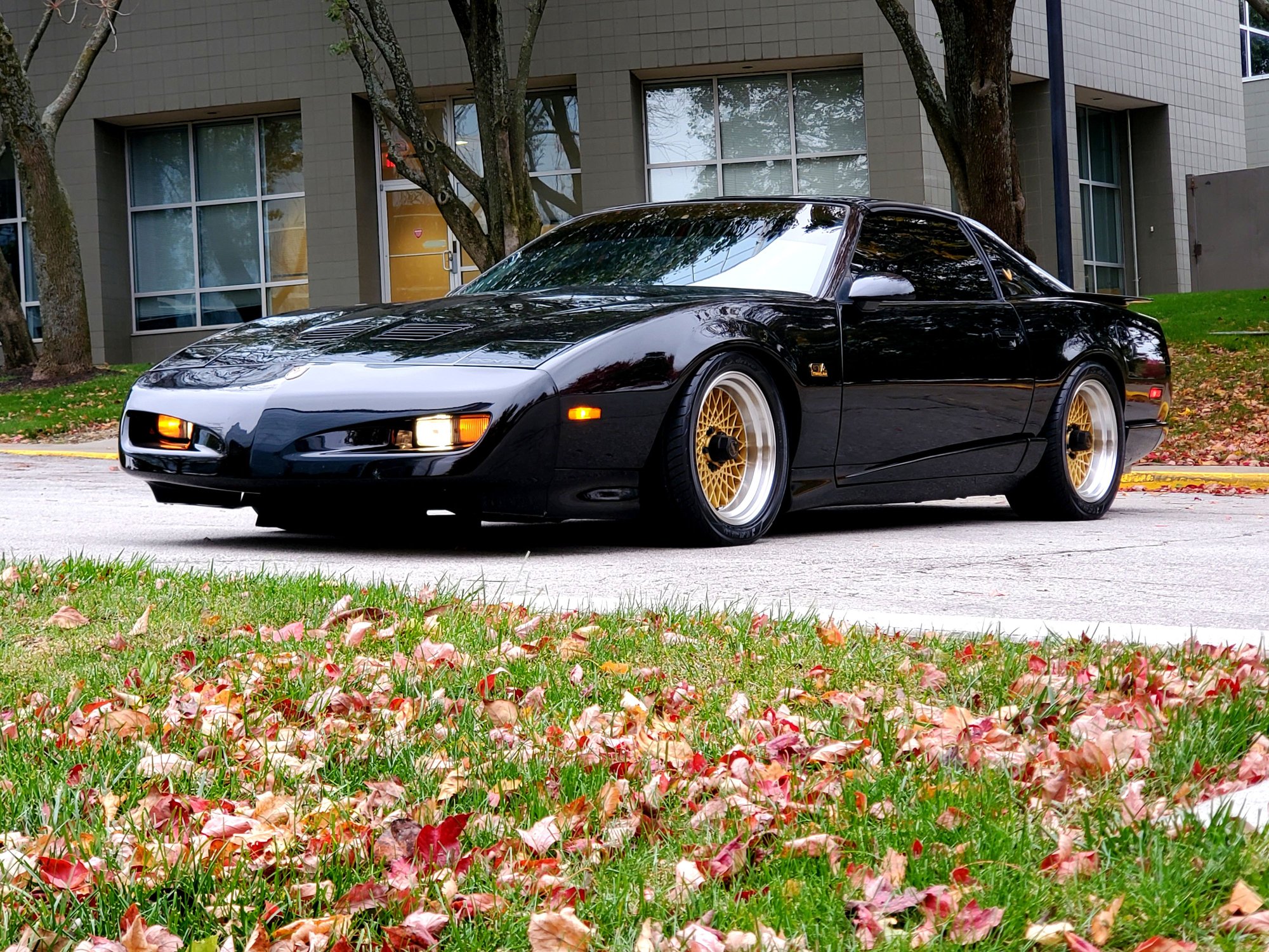

I used this bulb for the fog lights in my car. I had to put a hole in the back of the mounting housing and bracket to accommodate the heat sink on the back, along with hole sawing a small piece of the bumper. I also pulled the lens off and removed the shield in the lamp housing since the LED projects light only to the side and there is no direct light coming from a filament, the shield was rusty looking and I didn't want it.
https://www.vleds.com/shop-applicati...imited-h3.html
I got the 6k color temp bulb since I prefer a more white light. This mod was so nice, I actually wound up using these for headlights for a while since my HIDs were getting bad and I could not see as well. I also have wired my fog lights to act like DRLs
Also I used the VLED switchbacks in the turn/running housing. There was no modification necessary with the correct bulb number purchase and the adapter harnesses. The running light is white and switches to amber when signaling, then there is about a 1 second delay when you stop signal until the white comes back on
https://www.vleds.com/shop-applicati...n-wa-1157.html
With the two lights on they are very bright and the same color temp. I like felling that I am more visible now compared to the stock lighting, except there is no chance for things melting from a hot halogen bulb
