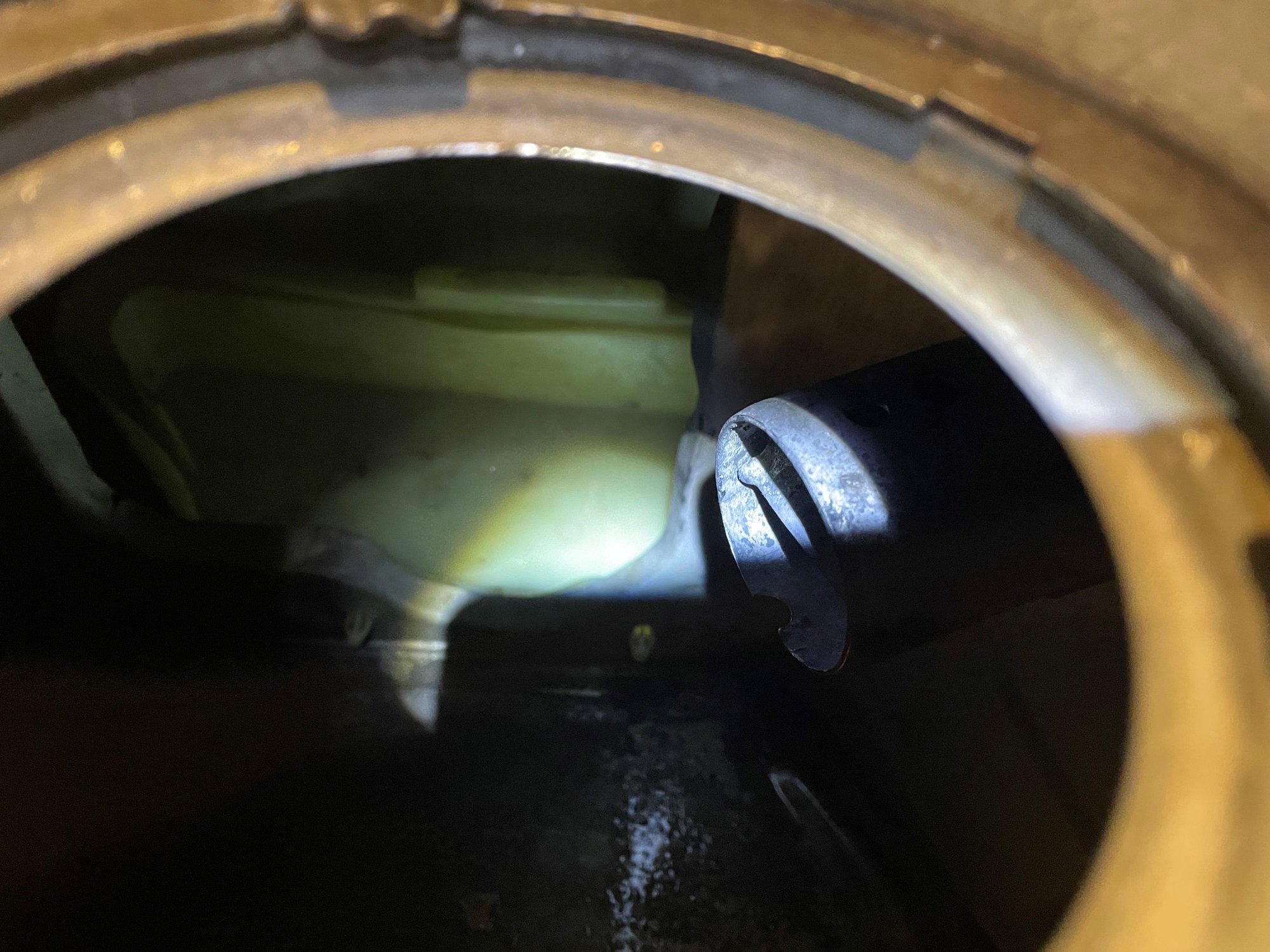

Figured out the issue, apparently the fuel tray is broken and was blocking the sending unit from moving. Should I replace the tank or just remove the plastic tray?

Since you asked, were this mine, I think I'd get a new tank VS trying to extract the broken baffle out of that one. Yes, I know the new tank cure is fraught with peril itself, (a search will reveal a bunch of threads about fitment issues with what's available nowadays for new tanks) , but once fitted it'd at least be in it's "as designed" state with the baffle. I can't say with 100% certainty, but I think I remember reading here somewhere that the baffle is to keep the pump from sucking air while making turns with half a tank or less of fuel, hopefully someone who knows for certain will pop in and let us know if my memory is correct or not on it.......

I like OrangeBird's recommendation; but I would go to a 4th-Gen Tank and Tank-Unit (Pump/ Sending-Unit).
And like I said, always test the Sending-Unit outside of the Tank first.
