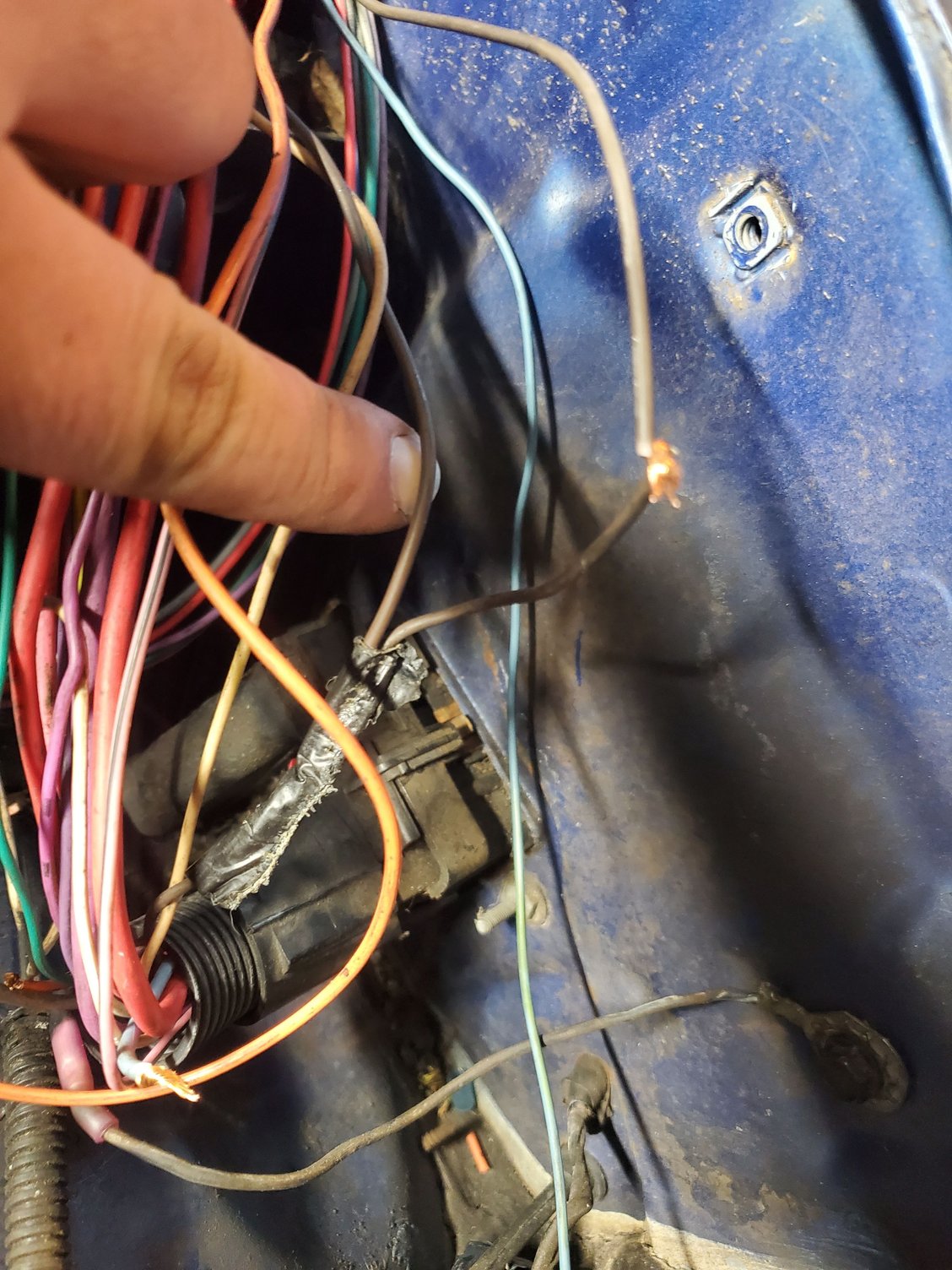

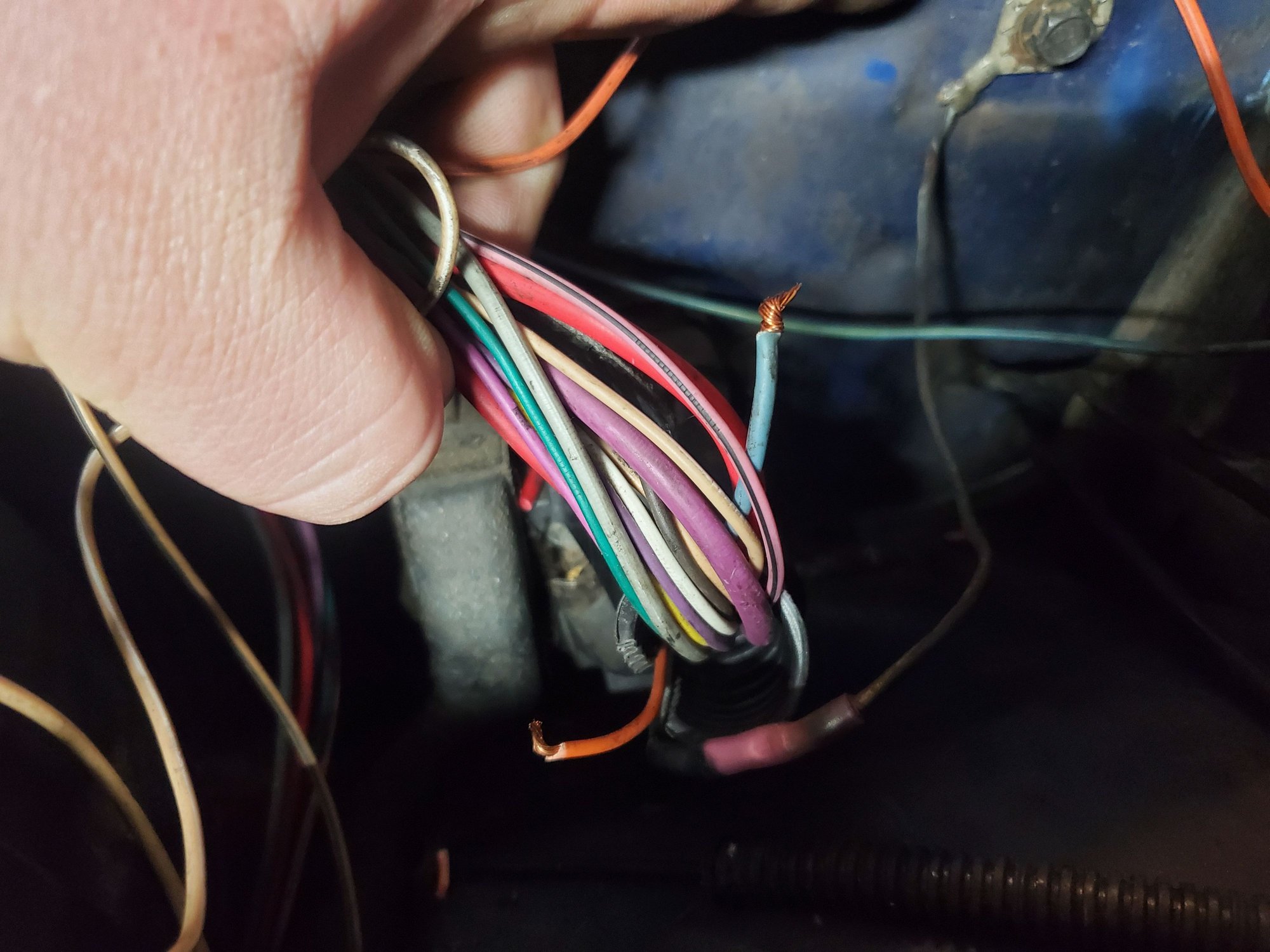

1990 rs 305 was a tbi switched to carb the problem I'm having is I was pulling the ecm out and cleaning up the wiring because previous owner had the wiring all hacked up when I got to the drivers side harness I found cut and loose wires my main problem is the cluster with the key on headlights/running lights off the dash lights are on at least half of them with the headlights/running lights on the dash lights go out and the only gauge that reads good is the voltage gauge oil barley moves and fuel stays on empty and bounces up a little when driving other then that nothing turn signal lights work and dim the rest when blinking other then that all other electrical works fine idk if I bumped a wire or pulled one loose any help or feed back is greatly appreciated

I can't understand any of that either. But the photos tell a fairly complete story.
First off, I would NEVER have bought a car with wiring hacked up that bad. If that level of sodomy had been applied to, say, the engine (probably has) or the body or the brakes, it might be more obvious. If the carb conversion was done with a similar level of professional attention to detail (probably was) I'd be afraid to get inside it, especially when it's running (probably doesn't, at least not right) for fear of it catching fire. As it is, you are now the proud victim of the stupidity of the lowest form of human garbage, and you even paid for the privilege. Hard lesson to learn.
First remedy I would employ is to untwist all those twisted up wires, and splice them back together PROPERLY to their ACTUAL other half. Kind of a no-brainer here: blue to blue, orange to orange, etc. That means, solder and heatshrink, NOT crimp splices. With the mess you have there, there's not even ANY POINT in trying to troubleshoot ANYTHING yet; any wire might be connected to any other wire (and probably is), which can of course cause all manner of unpredictable behavior. Nobody out here is going to tell you, your gauge does this when you turn the headlights on, that means the PO must have twisted the dark green wire and the purple wire together. "Internet fix my car for me NOW" can only take you jsut so far. At some point you have to use some common sense. Which undoing all that buggery and involuntary carnal knowledge would be an obvious place to start.
Next thing I would do is locate the FSM for the car, so you can see what each wire is/was and where it goes/went. Makes it AHELLUVALOT eeeeeeezyer to work on it if, say, the tail lights don't work, and you go to the wires that are supposed to be tail light wires, and see what's wrong. MUCH less trouble than looking at a handful of COPPER WOOL and trying to figure things like that out.
Some people in this world simply should not be allowed to own a pair of dykes. They should be locked up in a federal pound-me-in-the-a$$ prison FOR LIFE if caught with them.
