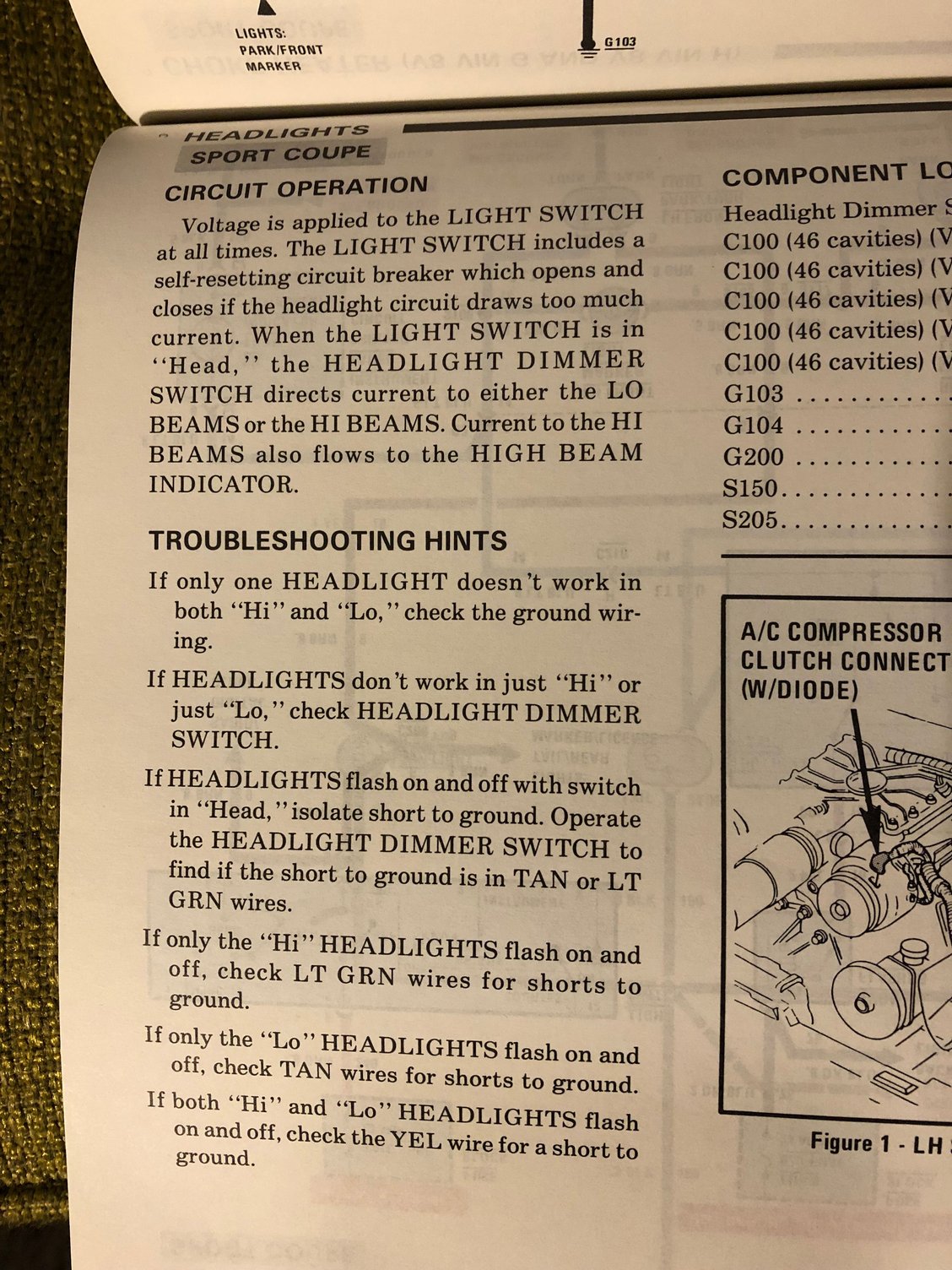

The switch is mechanical, manufactured from plastic or some similar product and is 30+ years old, so sooner or later it's bound to head south. (Mine quit without warning) The pics below are from my 85 service manual. You might find answers there, but a look at a shop manual specific to your car is your best bet. Best of luck.
