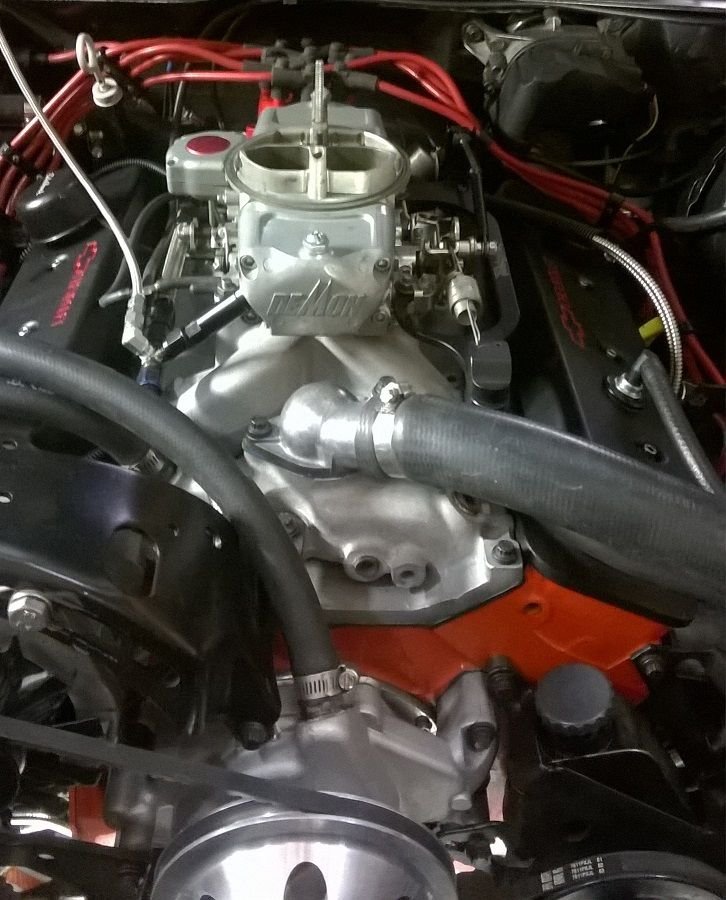

It's been a while since I tried to source one of these. I don't even recall or have records of what I've been using other than to think it was an OEM part in some application.
The image below is what it looks like although the spec is not the same.
That's a Hypertech switch which looks to be unavailable.
I'm looking for any single switch that'll work in or around 180°.
The connector doesn't really matter but a switch with a stud would be preferred as it would tighten up the connection that's right between the header tubes. The plastic version above doesn't like the heat.

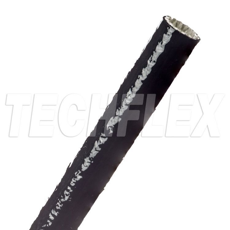

I'll wire you up one with High Temp Wire Protection:
I boot the Switch... Raychem Sleeve the Wire, than Fire Sleeve it in 1/4" sleeve:
I would add the connector a few feet away from the heat

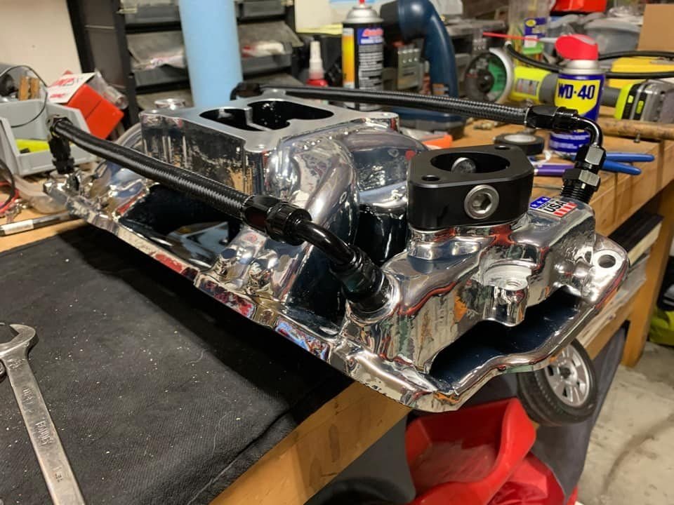

Will say that I very much dis-like the Cylinder-Head Location for the Switch for multiple reasons.
I prefer an aggregate of the Coolant/ Water Temp below the Thermostat, over on poor location on one Head.
Please send me Images of the Engine, and the Intake-Manifold Water Ports please!

Combined with a short length of this:
The combined components above could be the answer I'm looking for.

I run an RPM Air Gap intake. There are three available NPT ports on the t-stat crossover.
The heater core is piped through the top of the water pump and to one of the ports on the crossover.
All that's available or being used (at the front) are visible in the picture below.
I've often thought about the temp switch location in the head. It is an OEM location though. As in the gauge sensor in the opposite head. I've learned to reconcile those values and have developed a well functioning system. Changes I'd approach with caution however I'm not without wanting to look at the options.

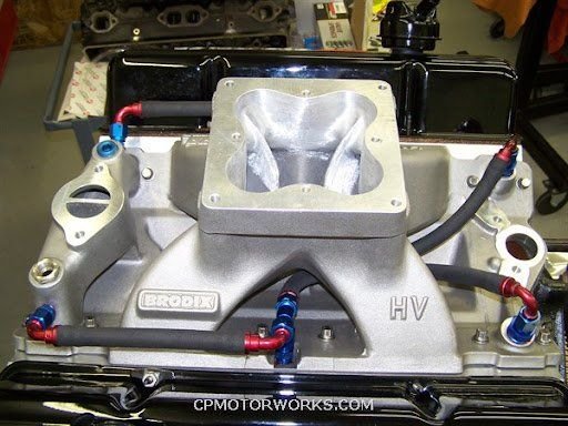

I offer these to Most of My customers for Water Temp Sensors, Thermo. Switches, Etc...:
This is Because I usually set up 4-Way, 6-Way, or 8-Way Water Cooling In the Intake-Manifold and Heads:
I've read pros and cons of similar setups. I believe the cons mostly come from disrupting the as designed coolant flow through the deck surface and how and where it mates up with the heads. From my understanding the head gaskets play a significant roll in the coolant management.

Vortec, where did you find that neat block? You always have the coolest stuff.
Slick stuff for sure but readily available.
Never considered one for my application but it would make for an interesting location for the fan switch.
I'd be curious as to what the temperature delta would be between the stat housing and the aft location on the head. At the very least it would require a re-think of the switch set points.

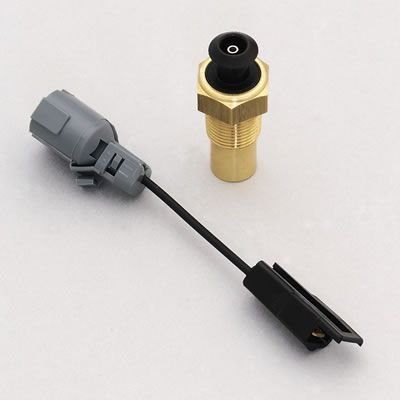

Looking further into what I've got and what I want to do, I discovered, or re-discovered actually as I already knew but had forgotten(!), that I have all that's needed to make it a go in a control sense.
The Dakota Digital Controller can run it all off of the Auto Meter gauge sending unit the LHS cylinder head.
