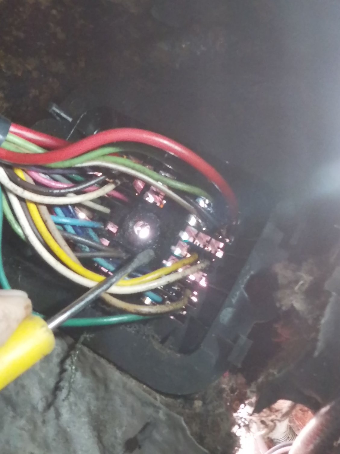

The Only thing that I could think of, is to push a small Punch against the bottom of the Bolt (through the Hole of the Threaded Insert)...
As well as Unscrew the Bolt at the same time.
See Image below:

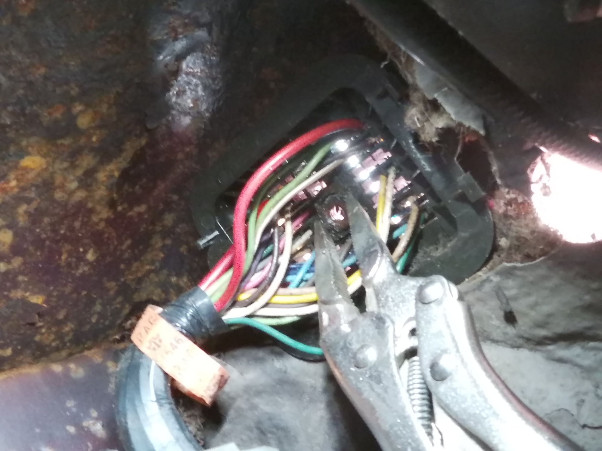

I came up with a new plan. If you use a small carbide on the Dremel you can clearance the right side of the connector.....right where I'm pointing. Left side is ok. That makes just enough room to get the needle nose vise grips in on that T-nut and hold it. YAY, SUCCESS!!
