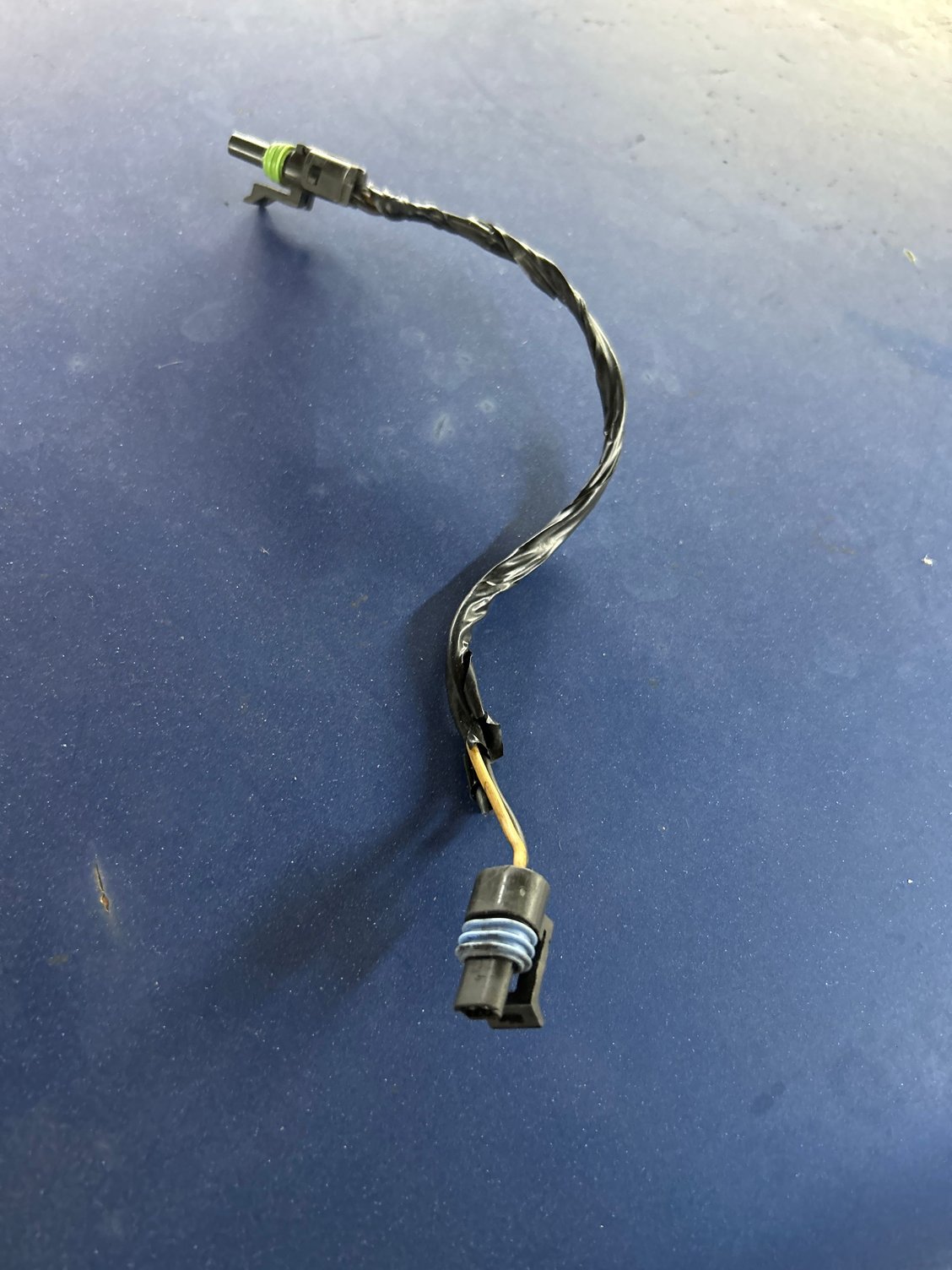

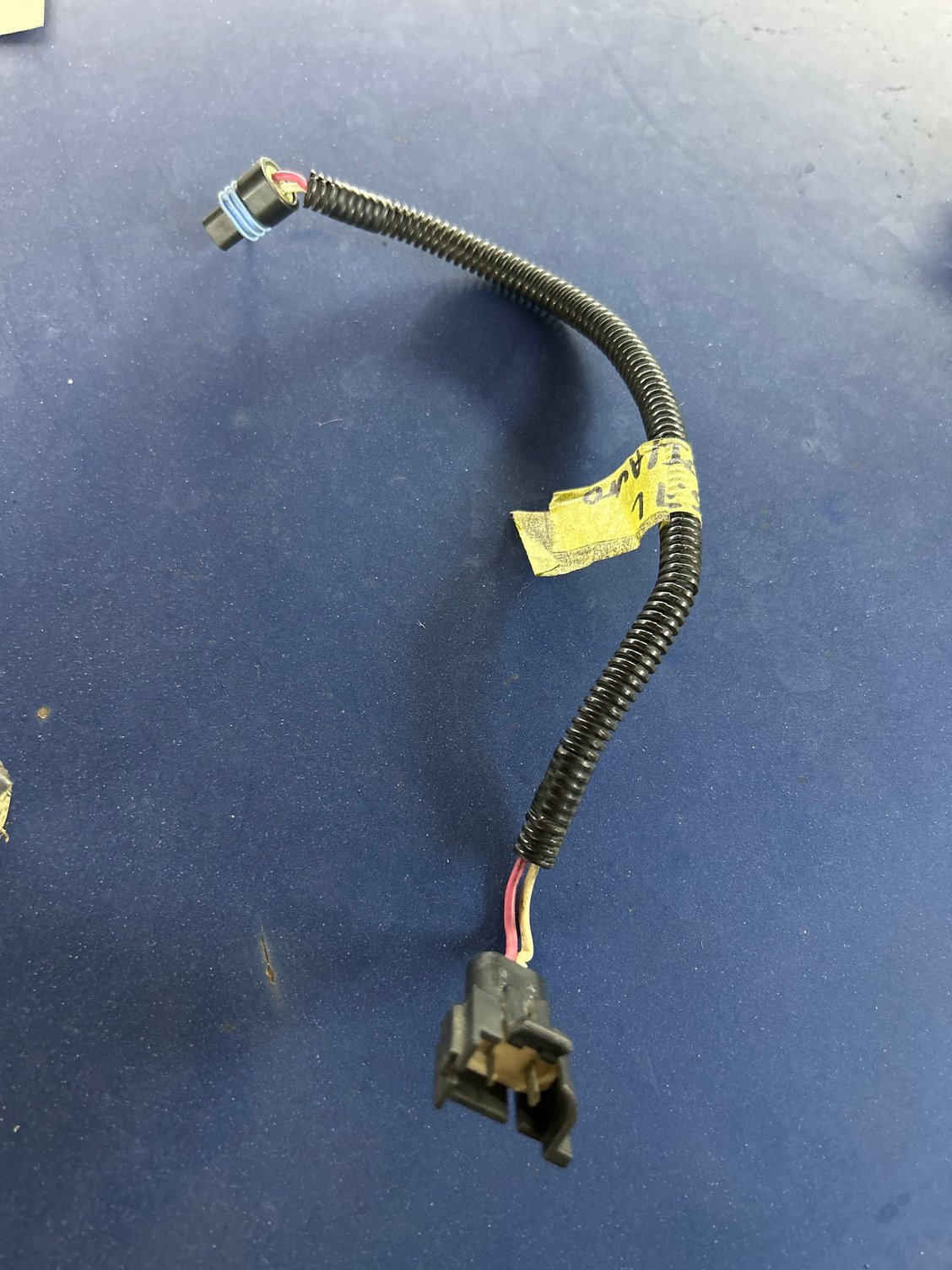

Hey all I have a 92 z28, currently doing a rebuild 383 and while trying to install the distributor I was unsure of where some cables plugged into. If anybody could help it would be greatly appreciated. Images are attached of the cables.
this one was attached to the main harness, I dont know where it plugs into
I believe this one goes from the distributor module to the ignition coil
what I dont understand is that both cables have the same connector on one end, so which goes where?

Top goes to mat, the other goes from icm to coil.

thanks so much, never wouldve found it myself
