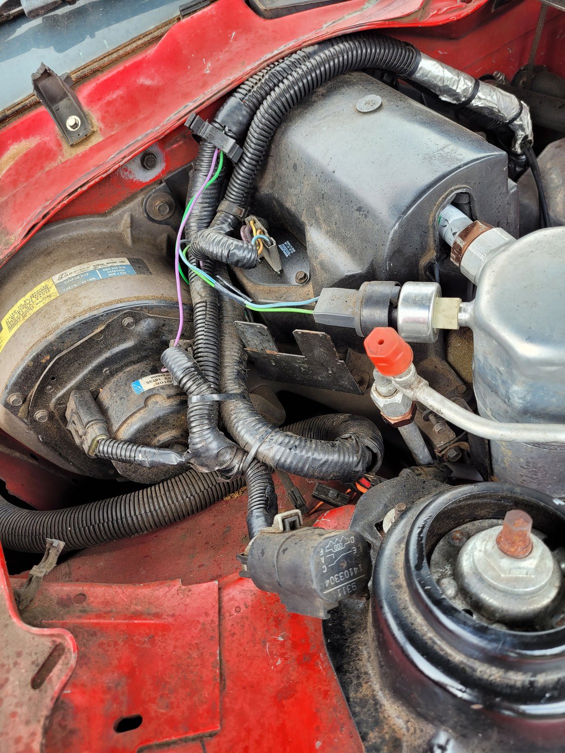

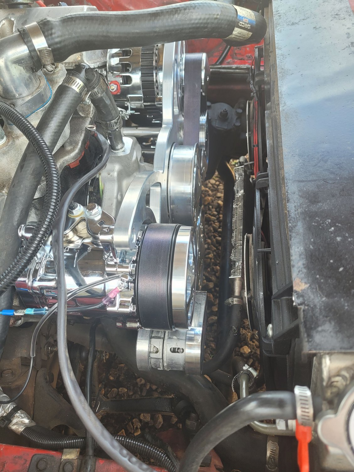

hello i just installed a serpentine belt on my 1990 camaro. the compressor only had 1 wire. i installed the positive wire to it. that wire runs to the back of the ac controls. i think it was green if i remember. i installed a ground wire to a screw on the compressor. not sure it was needed but yall can see in the pictures. im not getting any power to compressor and the blower fan isnt coming on. if i run a wire from positive terminal of battery to the wire on compressor it comes on so there has to be a relay somewhere. anyone got any ideas or location of this relay? also im posting a picture of a relay next to the accumulator. is this what im looking for?

The relay you're looking for is on the driver side firewall.
The one in your picture is the relay for the fan blower motor.
The driver side firewall typically the one closet to the fender is the relay you're after.
You said you ran the positive for the compressor to the green wire at the back of the ac controls?
Or do you mean you connected to the green wire for the connector that used to plug in the old R4 compressor?
If you ran to the back of your ac controls you bypassed the high and low pressure switches.
