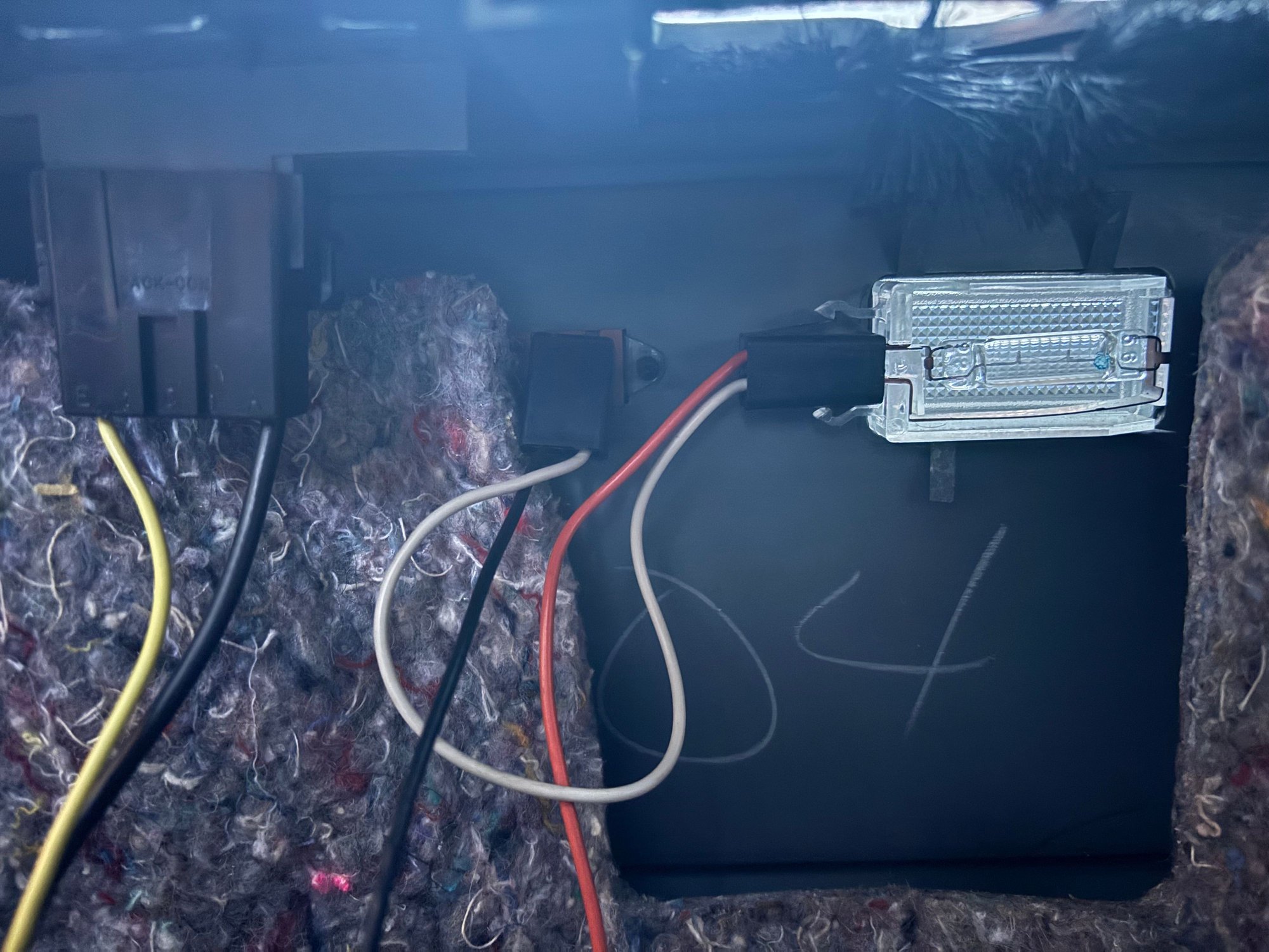

It either goes to the cargo compartment light assembly or the cargo compartment light switch. Both should be behind the insulation mounted to the rear interior cover just right of your hand. Either, yes, a short but most likely disconnected by accident when reassembling.

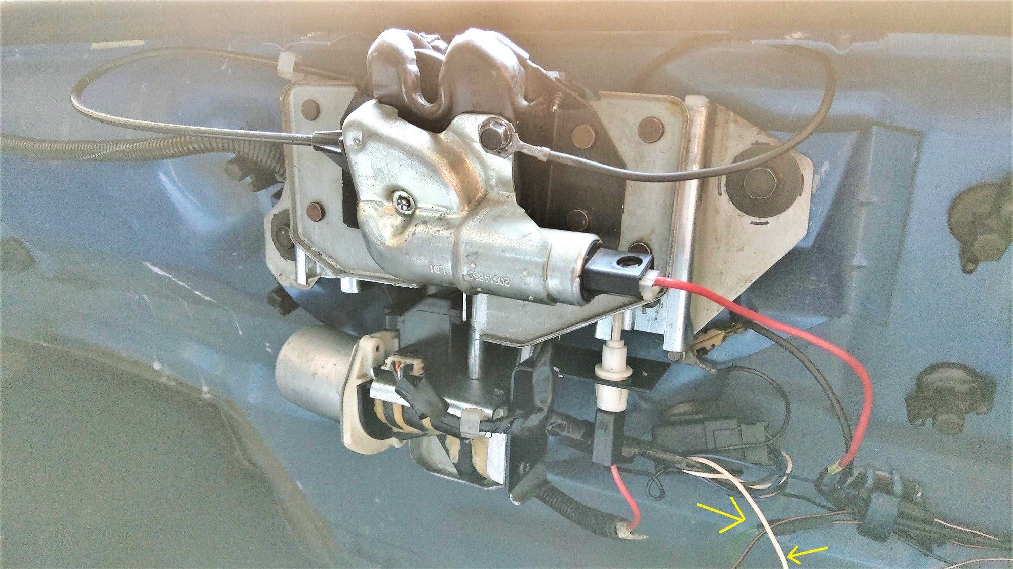

The switch should have the other half of the pigtail. Hard to see in this pic, but its green and (i think) brown w/ wht tracer. You should have a pair of male/female plugs. If you done have the cargo light. Then your connector goes to the brn/wht wire. which should have the female plug.

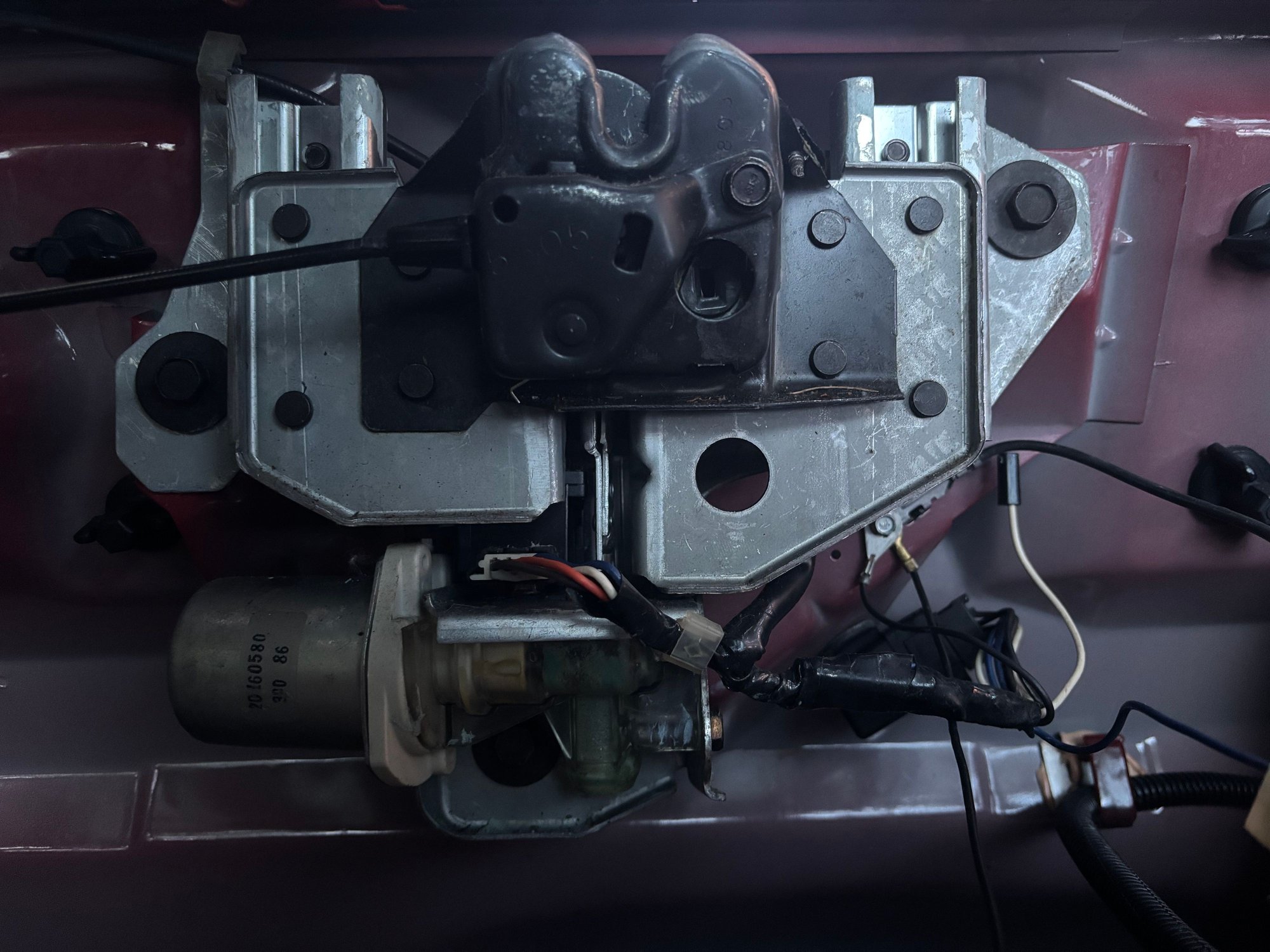

I must not have a stock door hatch in here because mine does not look the same. Maybe it’s just a different model? This is what I see in the back of mine

Maybe its got something to do with mine being a vert, idk. Its probably not used in your application.
