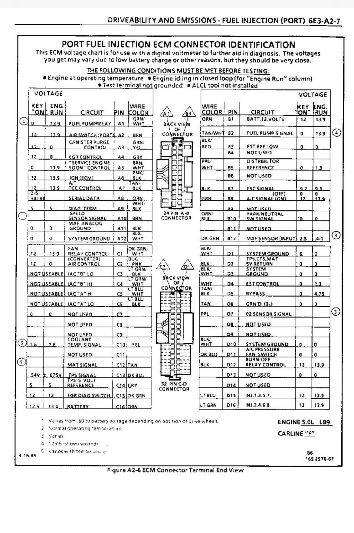

A10 of the ecm gets a 2k ppm signal from the Dakota digital
