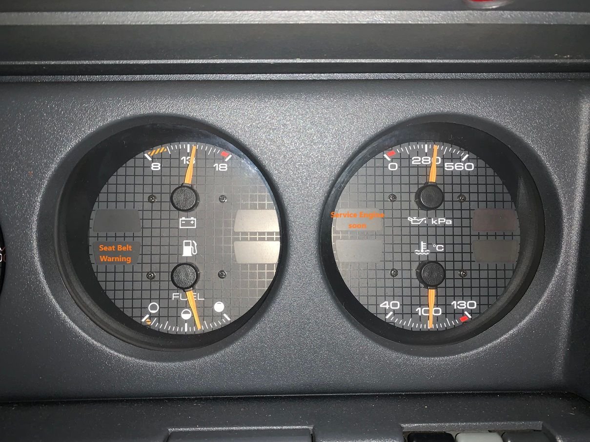

Here is how stock gauges should be treated in any car.
The needle normally runs here on the gauge. Now it isn't running there. I might want to look into this.

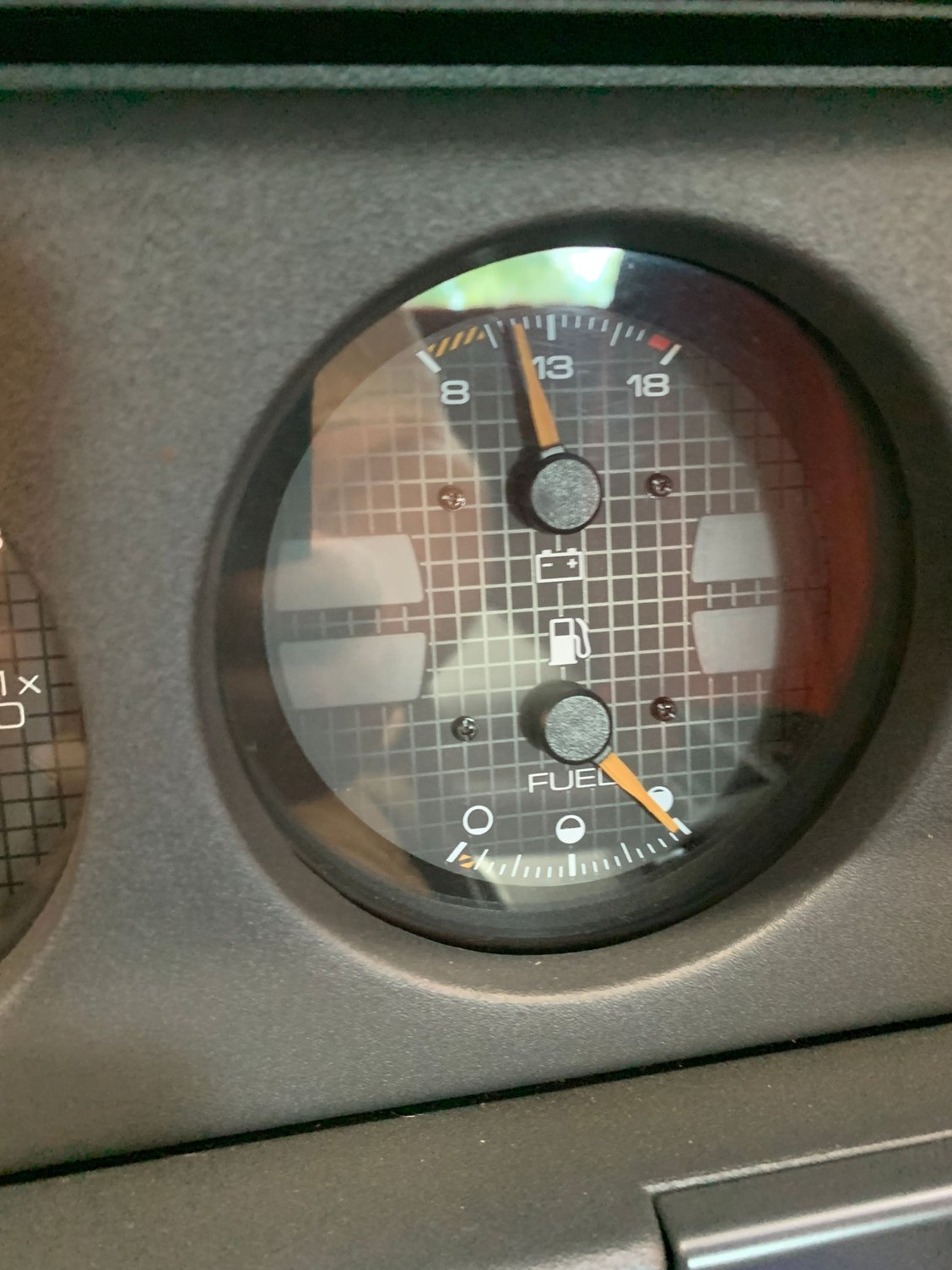

I'm glad this thread came along. I was paying a little more attention to the gages than I normally do and noticed the voltage gage reading low coming home from a car show.

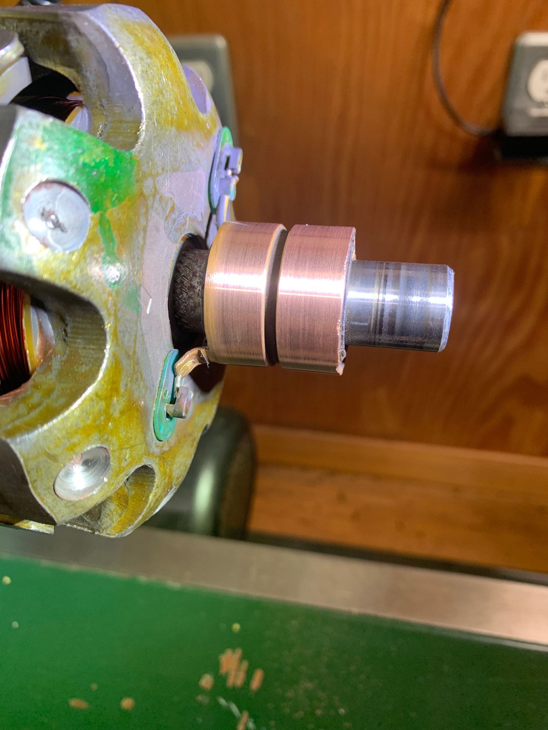

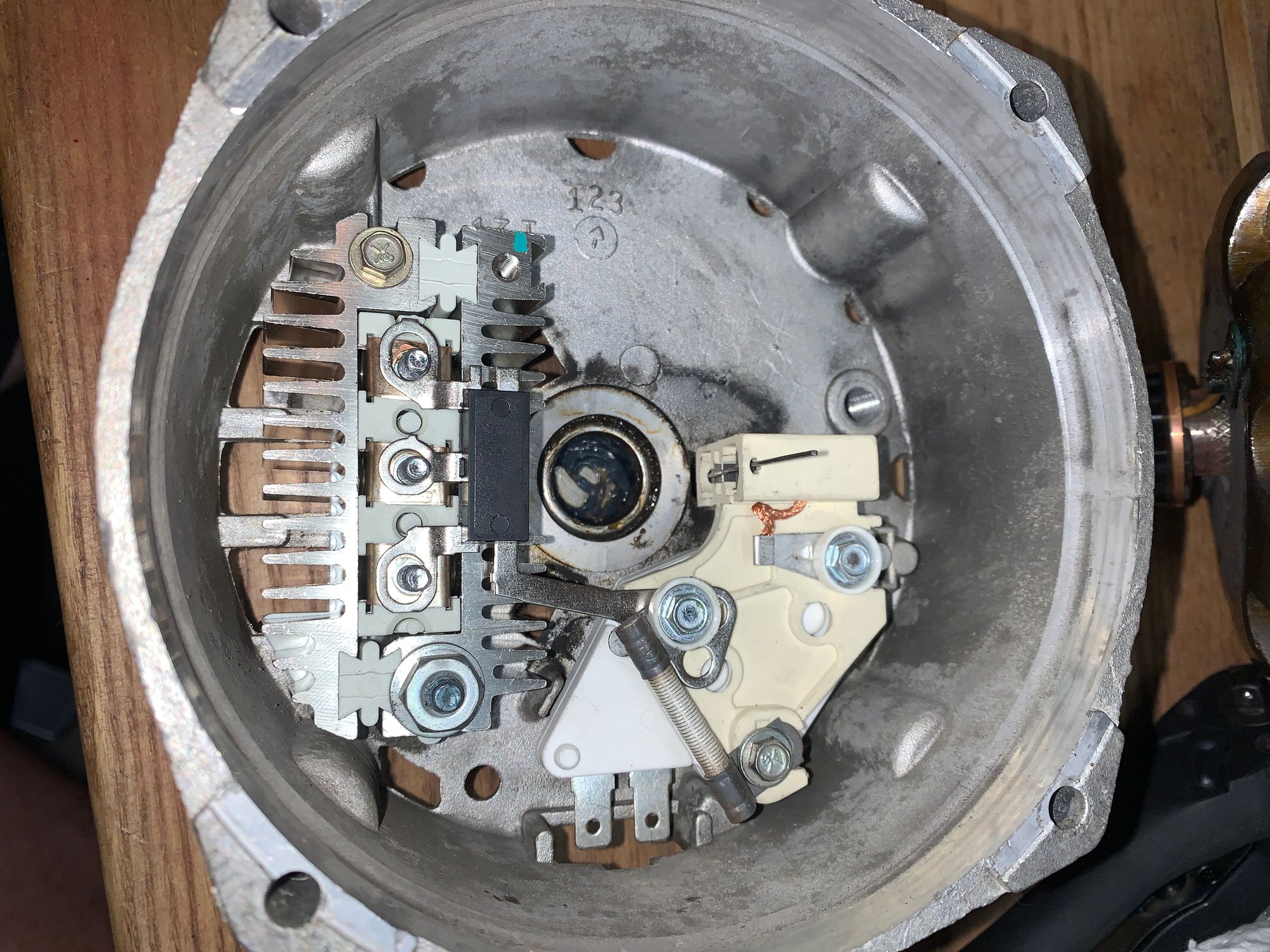

I also ordered a rebuild kit from Tuff Stuff and installed the parts in the old alternator thinking I would just reinstall the original alternator back in after it was rebuilt.
I cleaned up the slip rings.
I then installed the rebuild kit parts.
After the rebuild I installed the original alternator and it did not charge. I even jumped the 1 and 2 terminals to the battery thinking that I might need to excite the field windings for the first initialization run, but no joy.

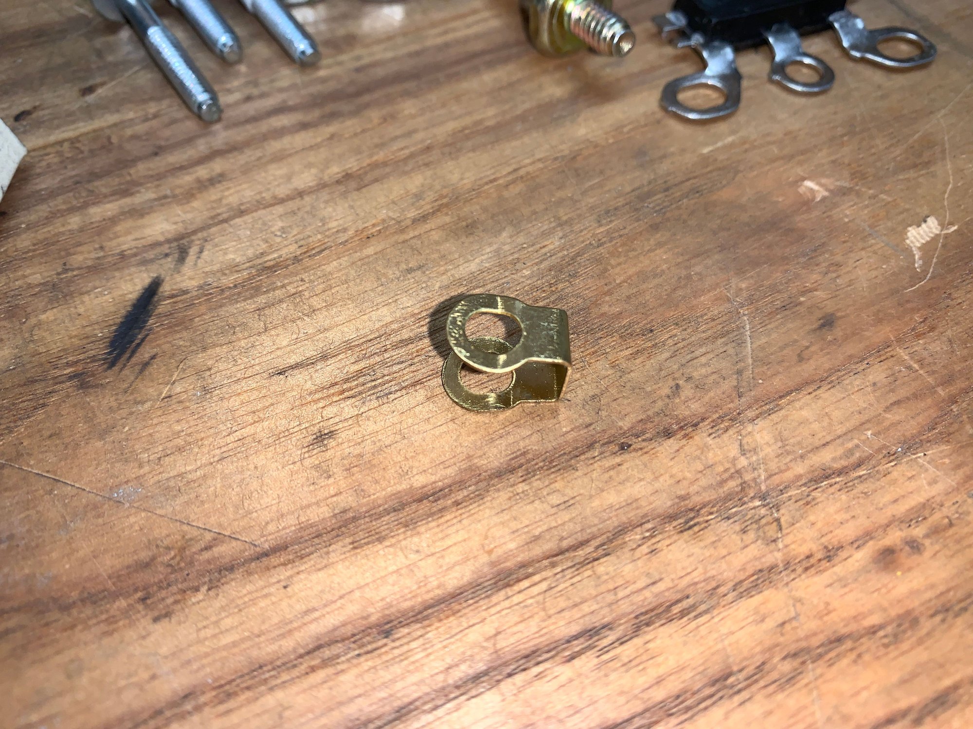

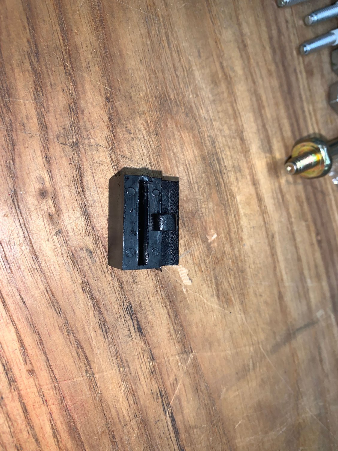

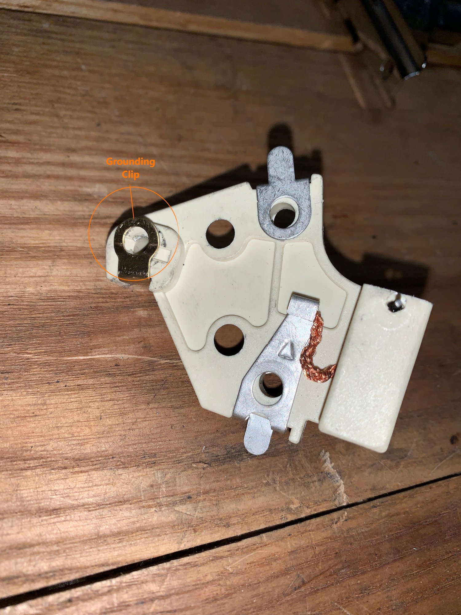

I noticed a couple of items in the rebuild kit that I couldn't see on the parts layout diagram and so I didn't install them. Does anyone know what these two parts are called, and where they should be installed?
Plastic block or spacer.
When the weather cools down and I am not out touring I'll have another go at the rebuild. For now it's working well.
Yes I did install the stator windings and removed the wire that keeps the brushes in the brush holder, after the rotor was installed.
If anyone has any thoughts about what I may have done wrong, please let me know.

The "block" and the clip look like they're for making it a 1-wire alt. The "block" would then have a jumper inside it, and would plug onto the connector from the outside. The clip would go across one of the regulator mounting screw pads.

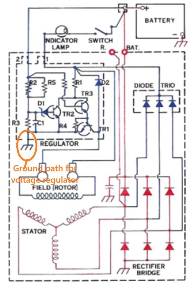

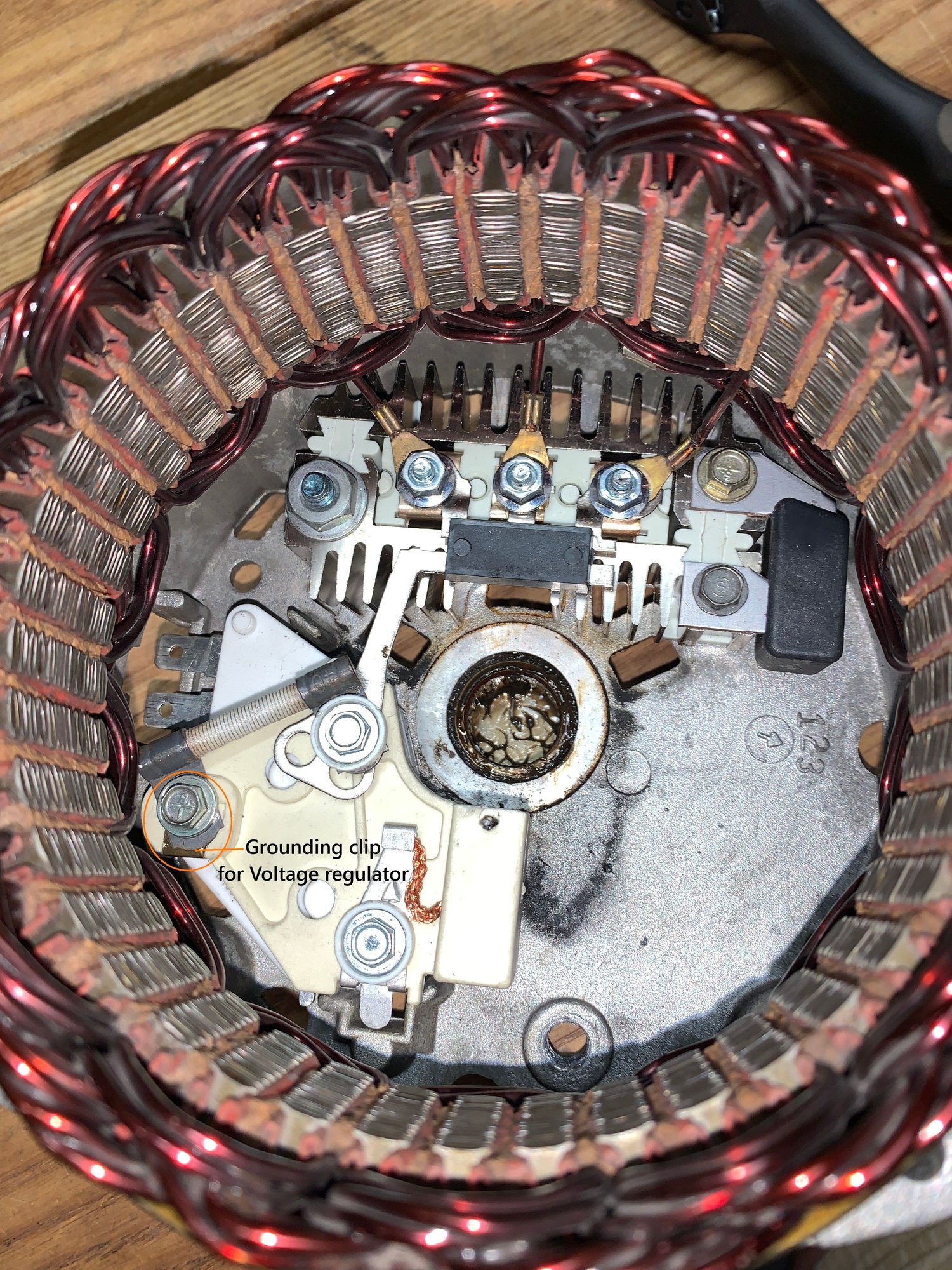

The issue did indeed turn out to be the clip as it needs to be installed on the brush holder to provide the ground path for the voltage regulator. Thanks Sofakingdom.
The clip needs to be installed here.
The black plastic block as stated is just a dust cover if the alternator is a one wire configuration.
The original alternator is now back in and working properly, and it has the same patina as the rest of the engine so I'm happy.
