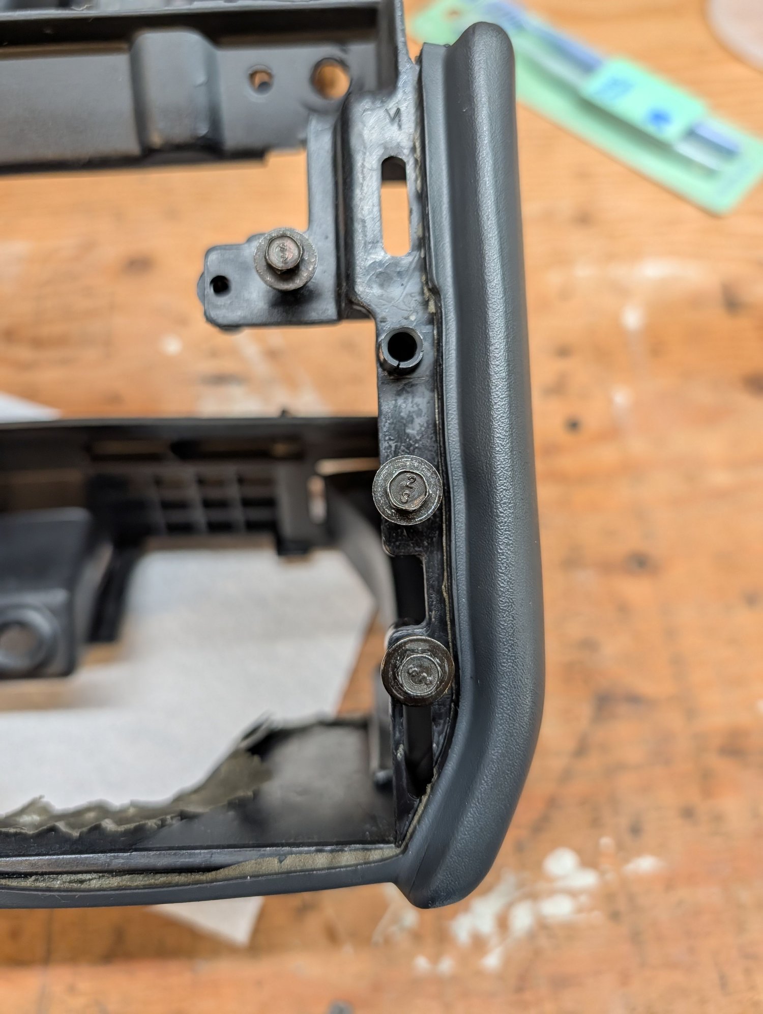

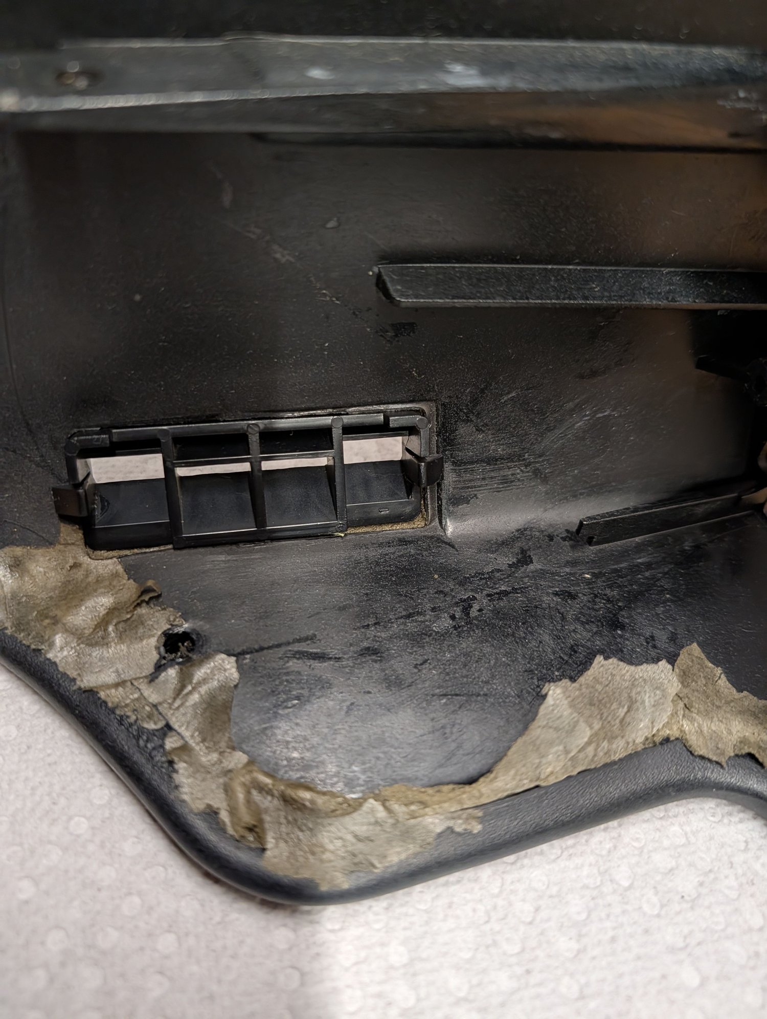

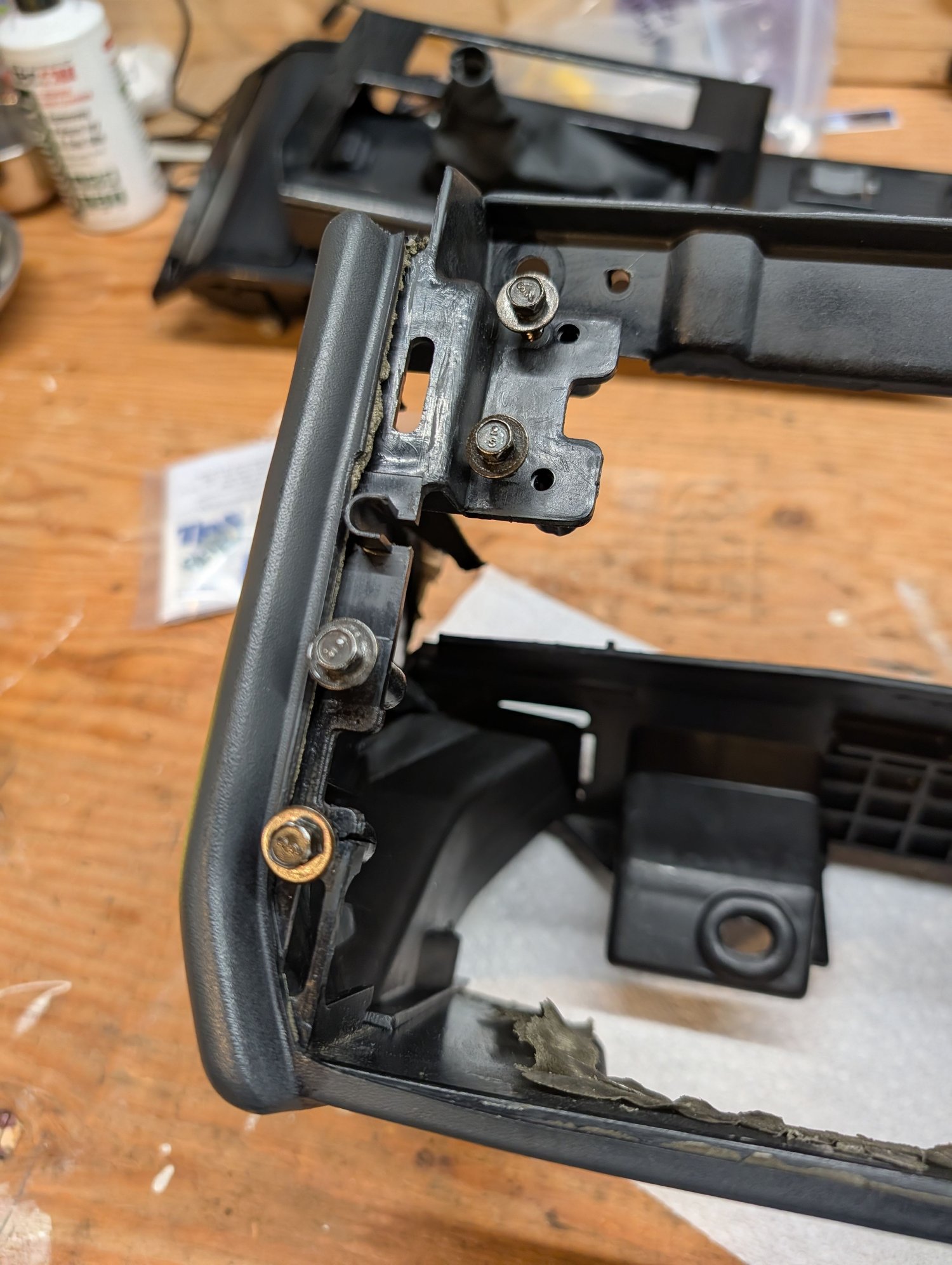

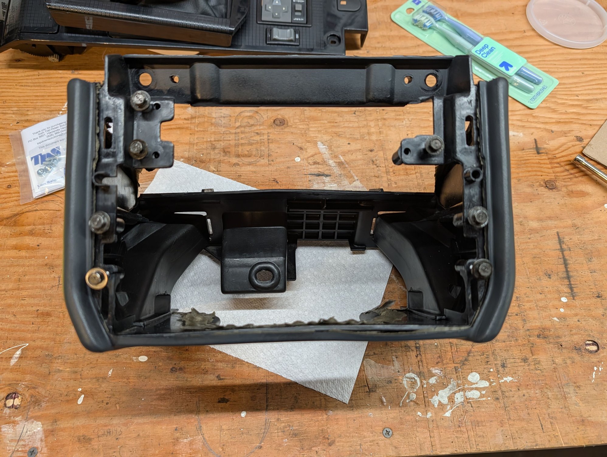

Mine happens to be sitting on my work bench at the moment, and it's in pretty good shape. I may try to super glue the cracked screw holes and/or look for other means of reinforcement.
Also a word to the wise, do not try to remove the lower vent covers (last pic). I did to clean them, and cracked a tab on both. I pressed them back in and super-glued the tab, but they wont come out again without breaking. I did successfully remove the black vent channel for cleaning.
Let me know if you need any other shots.

Excellent! Thank you very much.. Just what I needed.

Yeah, this happened to me too when I took out the gray colored vents to clean them. Luckily, I had some spare vents from the junkyard and replaced the one that got broke. Removing them never again.

When these cars could still be found at the local pick it yourself yards, almost every ‘85-‘92 Firebird I came across had cracked or broken tabs on those vents even if the radio pod was in good condition. The gray vinyl/rubber urethane material likes to shrink over time and it pulls against the vents cracking/breaking the tabs.

Which plastic rod did you use? And did you weld it on the back or on the finished side? Mine is cracked in the same spot, you can just barely see it in this pic.
Does anyone know the type of plastic used for the mounting tabs on the radio pod?

It says on the back side what plastic that is. I think it's ABS. Can't remember but it does say. I used the white rod. They're color coded for their specific material. It worked very well. You first melt in the zig zag metal rebar, then use the rod as a filler just like a metal stick welder. Then sand it. Works far better than any glue. Were a respirator.
