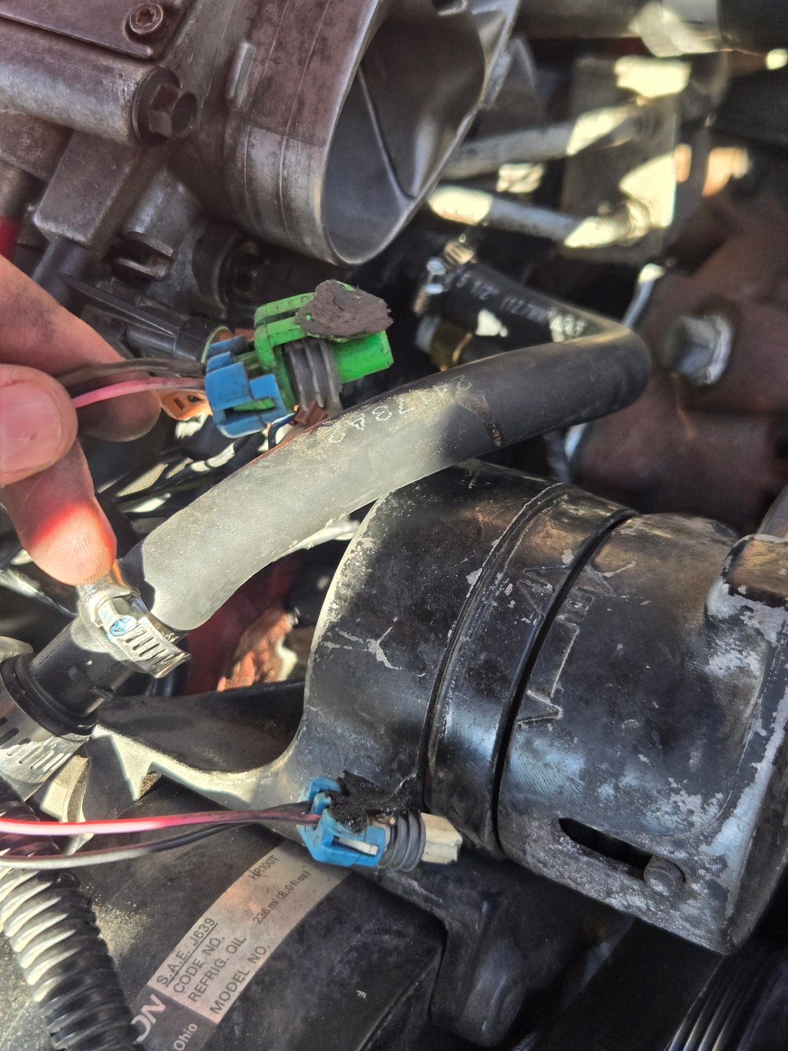

I have these 2 wires that have just been hanging here for years, the car has been sitting for a long time and it runs super rich, im wondering if these have anything to do with the issues i am havung with the car, can any one here identify these? Thank you
Green plug with brown and pink/blk wire
tan plug with blk/purple wire and pink/blk wire

Looks kinda like the ones that would have gone to the AIR diverter valve when it was still there. Hard to tell for sure though, with the photo being up so close.
