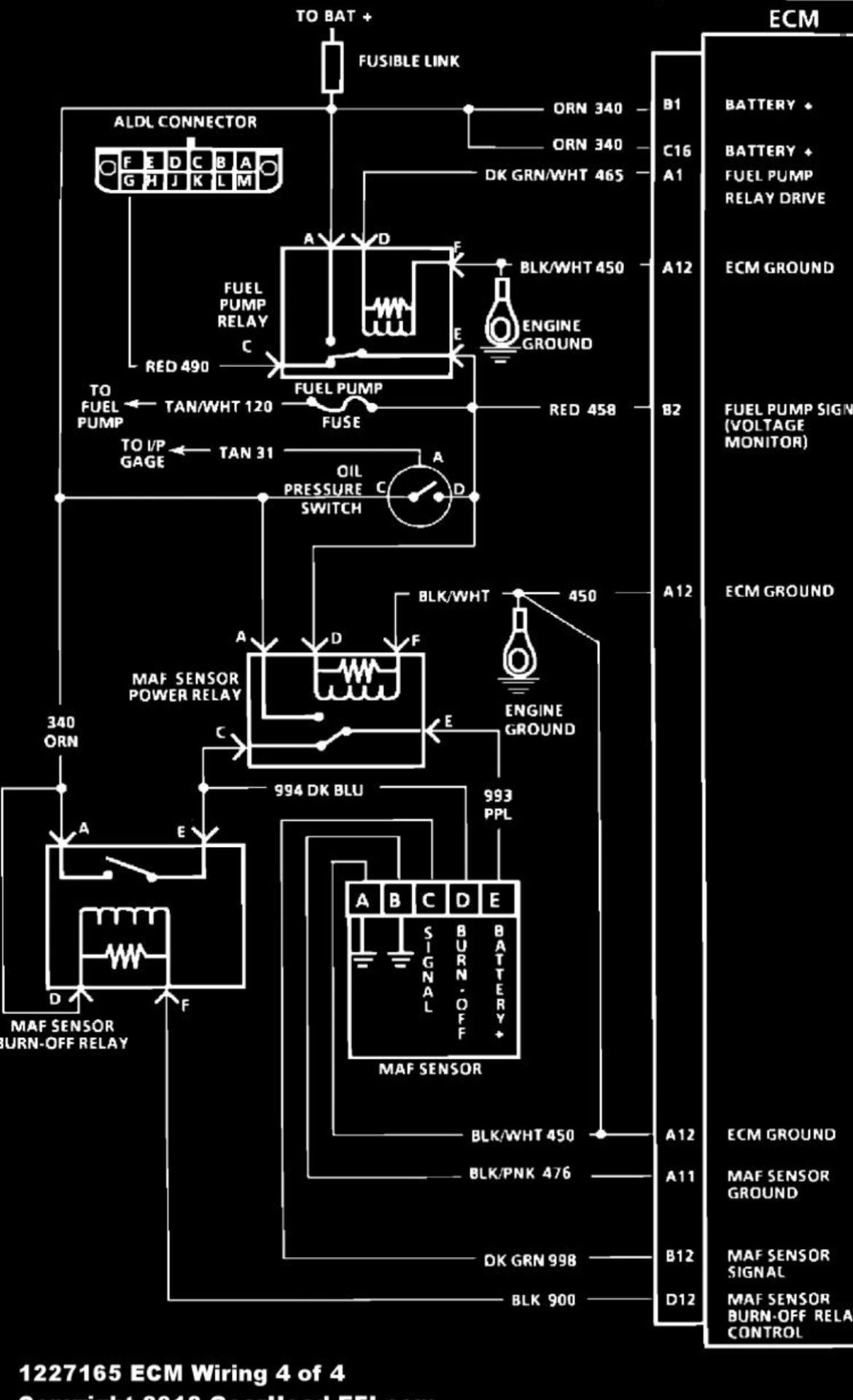

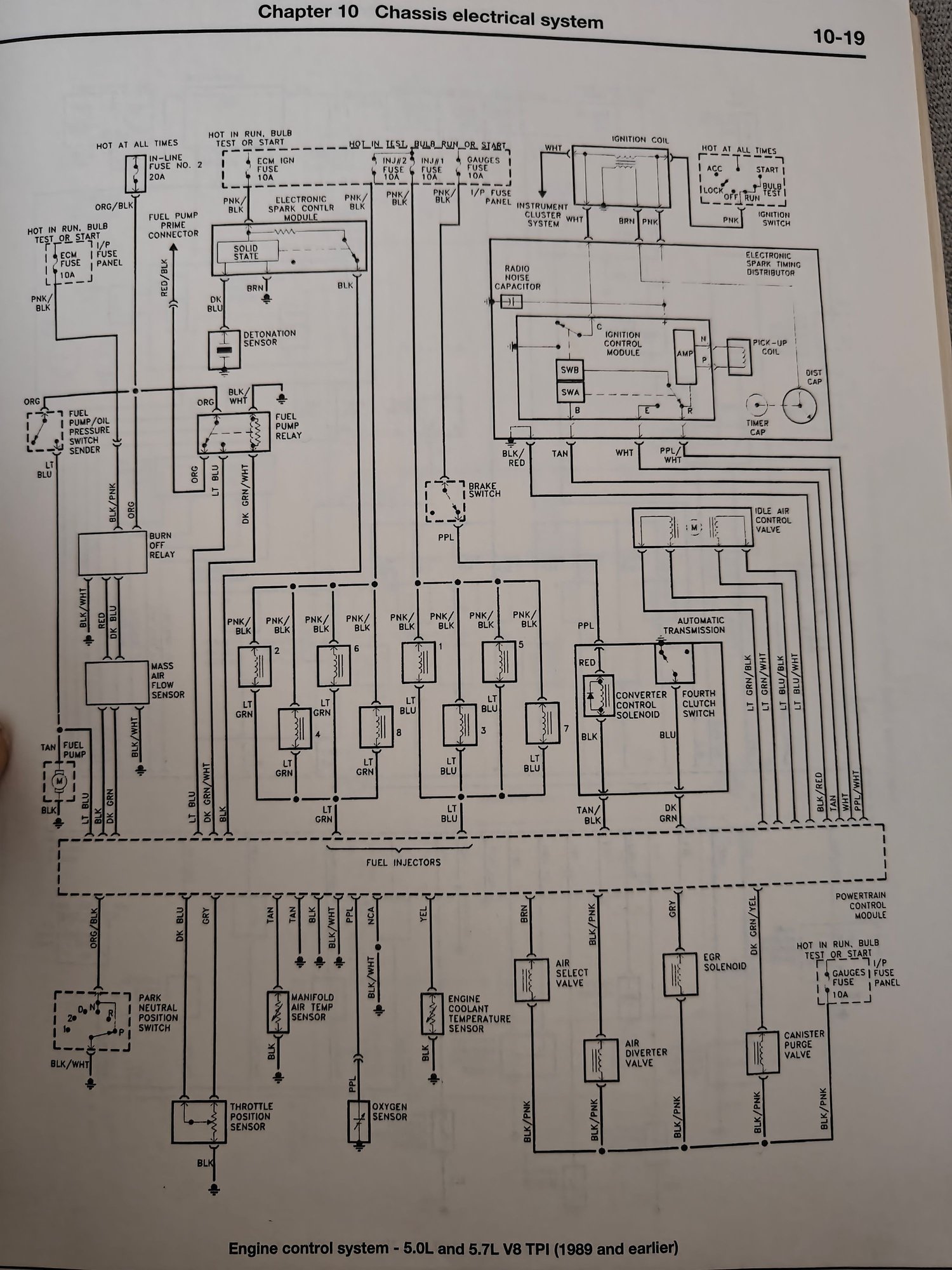

Hi, could somebody tell me is my Haynes wiring diagram correct or not. I have seen different wirings to fuel pump. This shows that oil pressure switch would cut off fuel pump electricity even relay is working.
Another schematics i have seen that relay and switch is connected pareller.
So witch one is correct or is there mnay different versions of wiring?

Re: 87 iroc fuelpump wiring
https://www.thirdgen.org/forums/elec...-firebrid.html
watch the video on this thread, This schematic is not how it’s wired.

Clear, thanks. That's what I thought it was. So I can remove this oil switch if i want and it won't affect the operation of the car.
