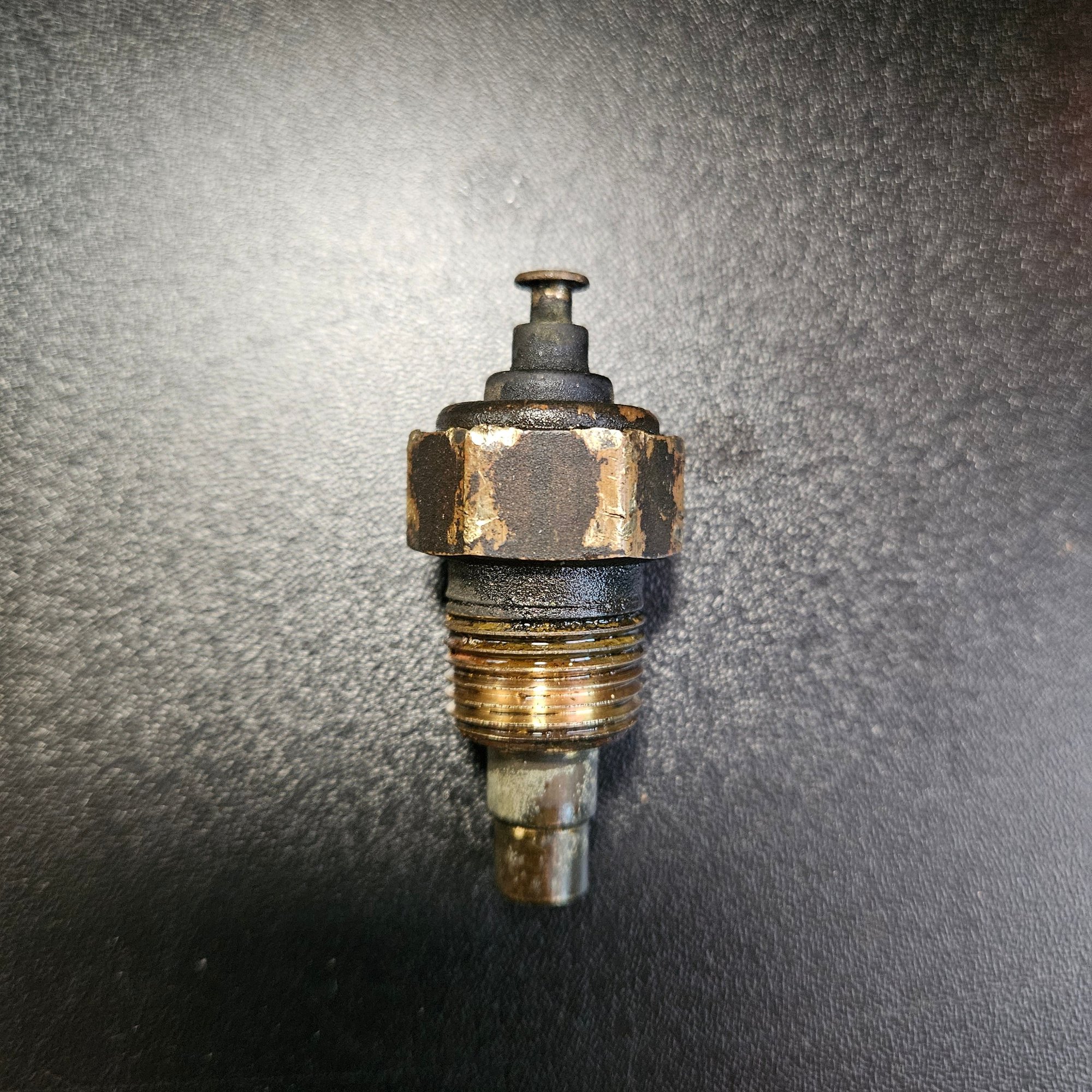

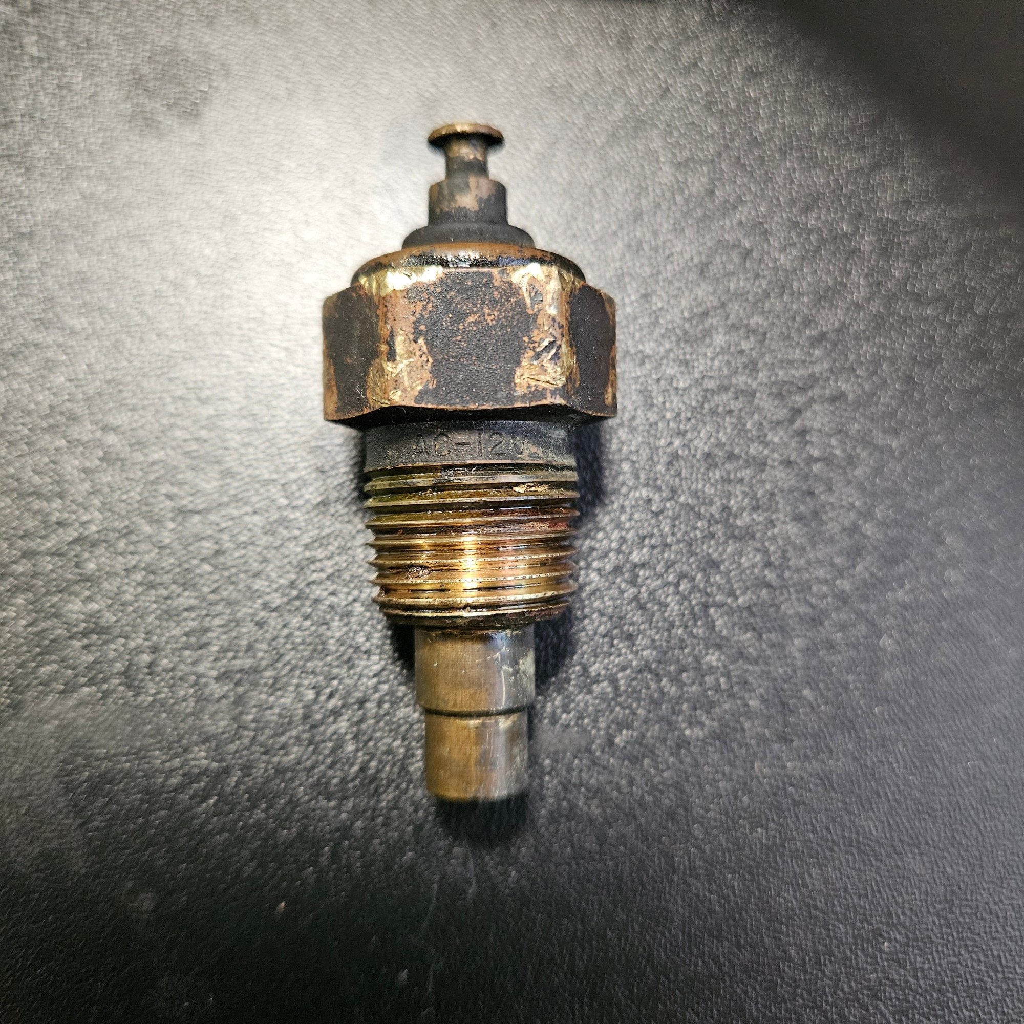

Originally Posted by Nova73
Wanted: For a 1986 Chevy Camaro 2.8L V6 MPI engine
Hi All! I am needing the sane part! I just found one from a Corvette!
This is the original that came out of my 89 camaro 2.8 v6. Im also needing the smaller radiator fan switch. Any leads where i can find!

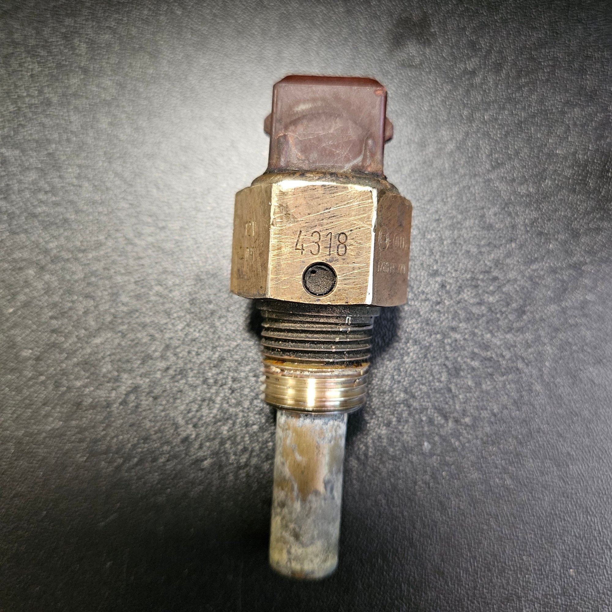

Old Mar 10, 2025 | 09:05 AM
racheallu49's Avatar
Joined: Mar 2025
Posts: 5
Re: Cold Start Temperture thermo time Switch
I need a radiator switch also. Any leads?
Radiator fan switch out of 89 v6 2.8. . Looking for this part. Any leads?
are you sure that’s not a coolant temperature sender for the gauge ? Looks like a older one with nail head connection not spade.
Hi. I have the temp sensor which i replaced. This particular part is in the side of the blick on drivers side!
