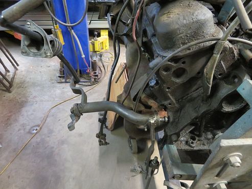

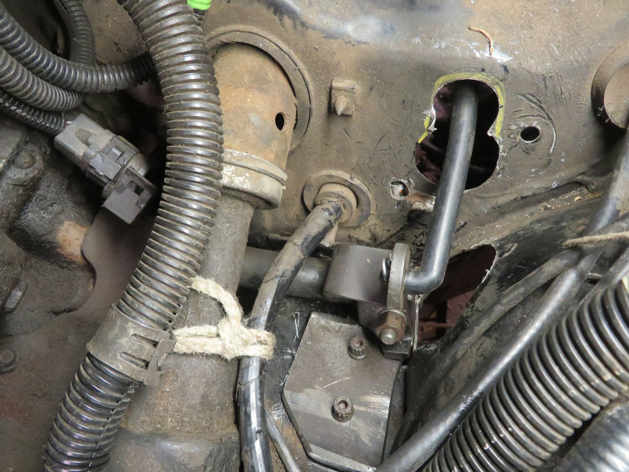

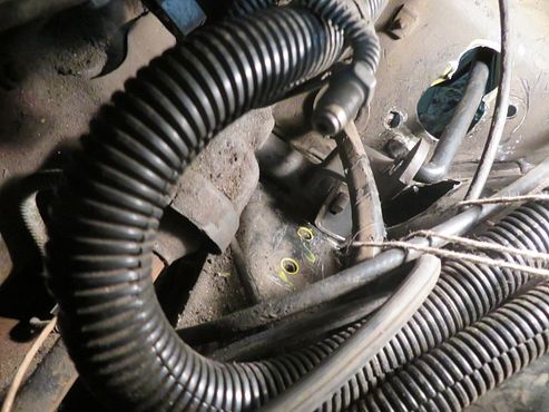

This is my 1st 3rd gen, and it was a gift almost 10 yrs ago, given because of a wiped out TH700. (Long story I won't bore you with). And because I also had left over, a 1980 301Turbo motor, I decided to marry the 2. Some say I'm crazy, (probably true) another long story I won't bore you with. But along with the Pontiac V8 swap, I also make it mandatory for any of my performance cars, to have a clutch. Maybe it's just me, but it's a "generational" thing. Anyway, I finally opened up this project just a few yrs ago, but with-in a few months, had -ta put it on the back burner, due to house priorities. And because I'm not gettin any younger, and neither is my 100 yr old house, I've realized the house will "never" be done, so I'm back to putzing with this 84 project... in my "spare" time. (LOL).
So you asked which tranny, and I'll tell you it's a WC T5. And there's story's about that too, but I think it would be easier, if you checked out the section of this forum titled "eng. swaps...Pontiac V-8s". I started posting at post #558, and have some pics in the following postings. #607, 612-613,618, 656, and 664. If you're interested, (or horrified) you can check them out. Beginning then, and in it's current state, I'm just trying to "roughly" configure the swap, before I spend too much money on it, until I have the clutch, and other swapping items figured out. I've just about finished the "tilted" T-5 tranny conundrum, and am concentrating on the clutch linkage right now. But progress is slow, due to other home projects, scheduled maintenance, (unscheduled maintenance), and other distractions that take me away from it. And lastly, I've got a yr or 2 before retirement, so that takes away my time too. (Working for a living sucks.) I have other sites I'm a member on too, and started a more detailed thread on this project over there, cause I don't think most here appreciate it. But because here they have a dedicated category for this type of swap, I have done some postings, for the 3 that "are" interested. Some members have been helpful, (like you), and I appreciate the efforts from them, and the 3rd gen site.
And below, I'll stick a couple 3 pics of my grungy progress.

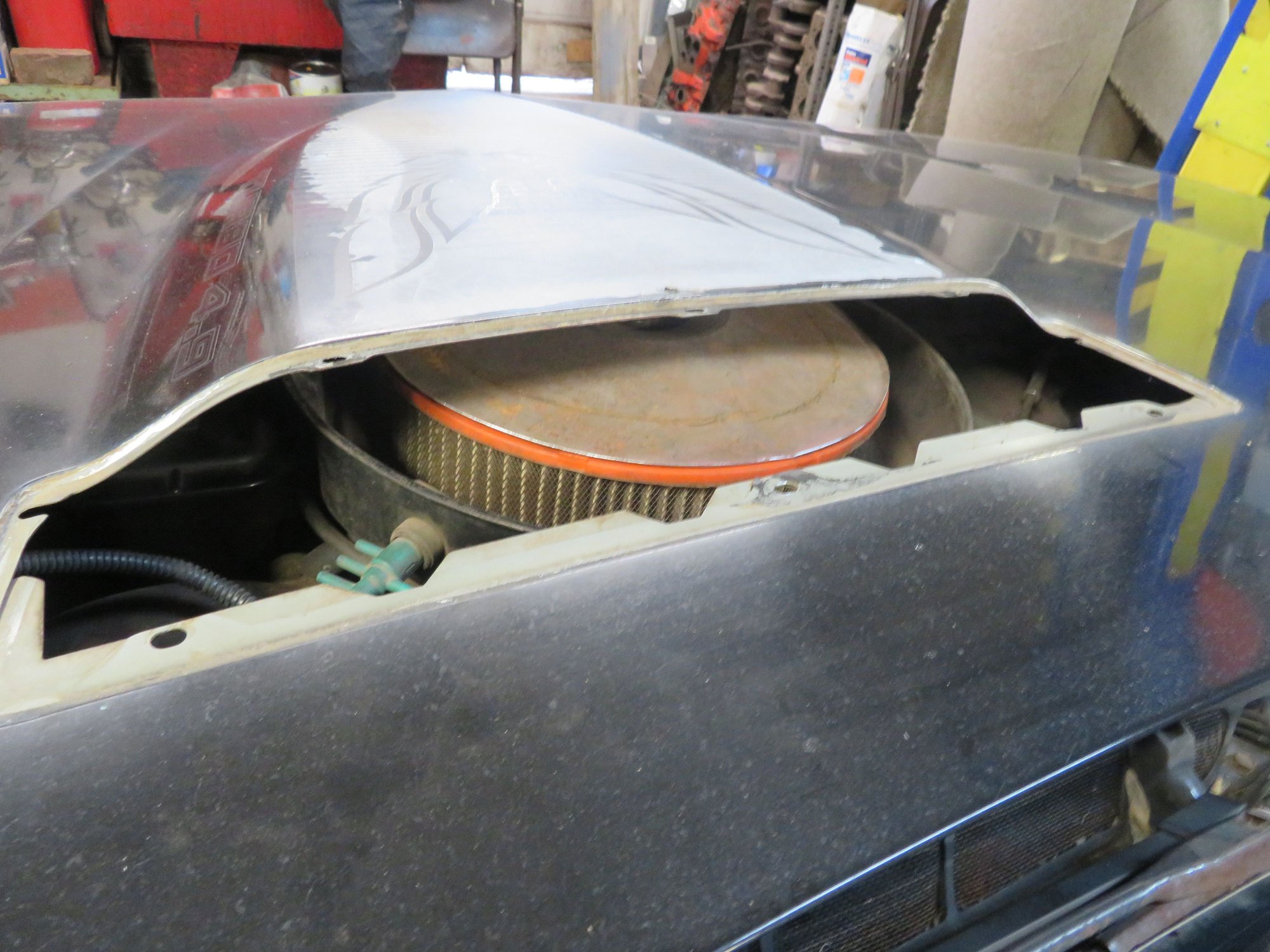

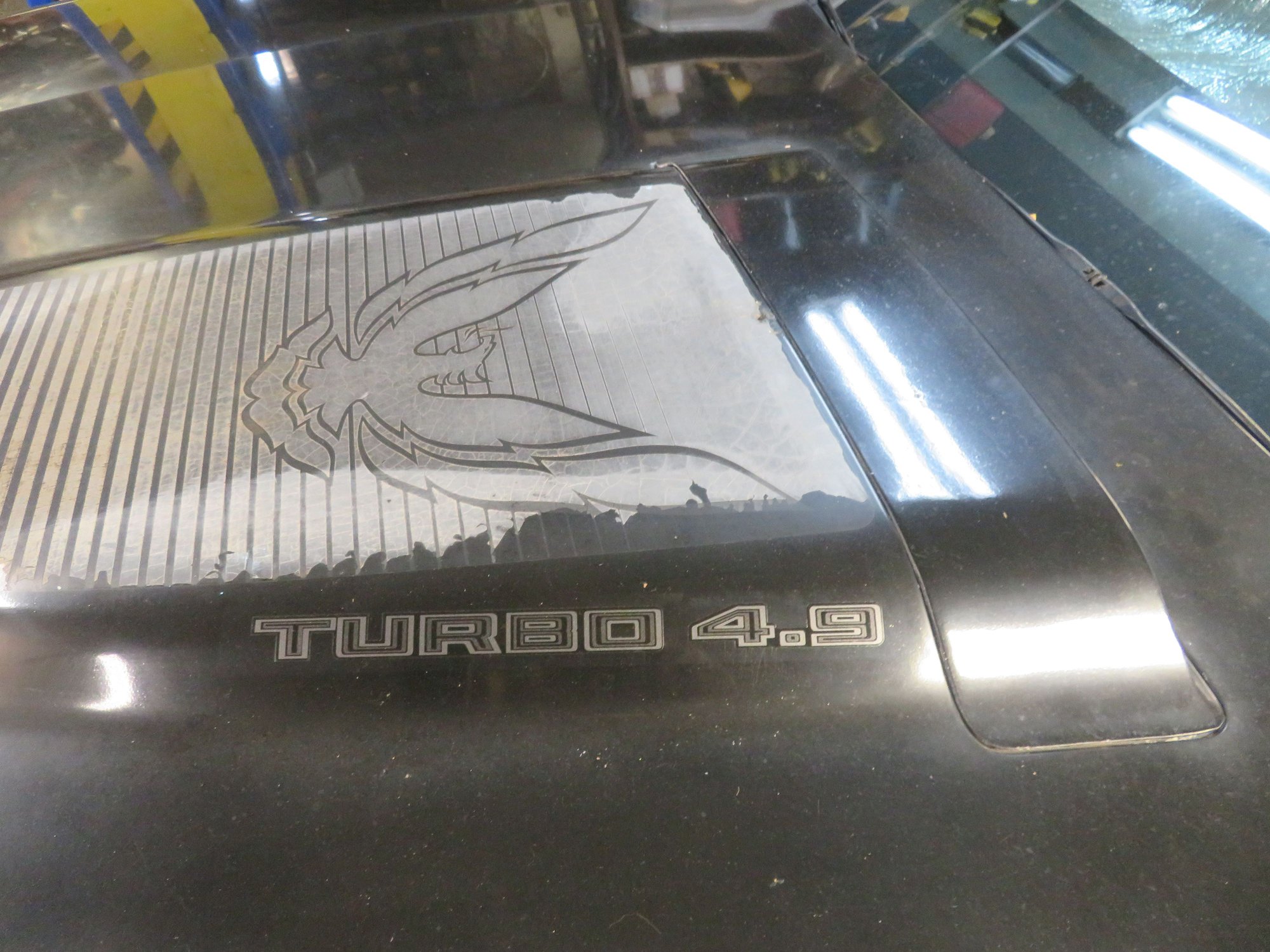

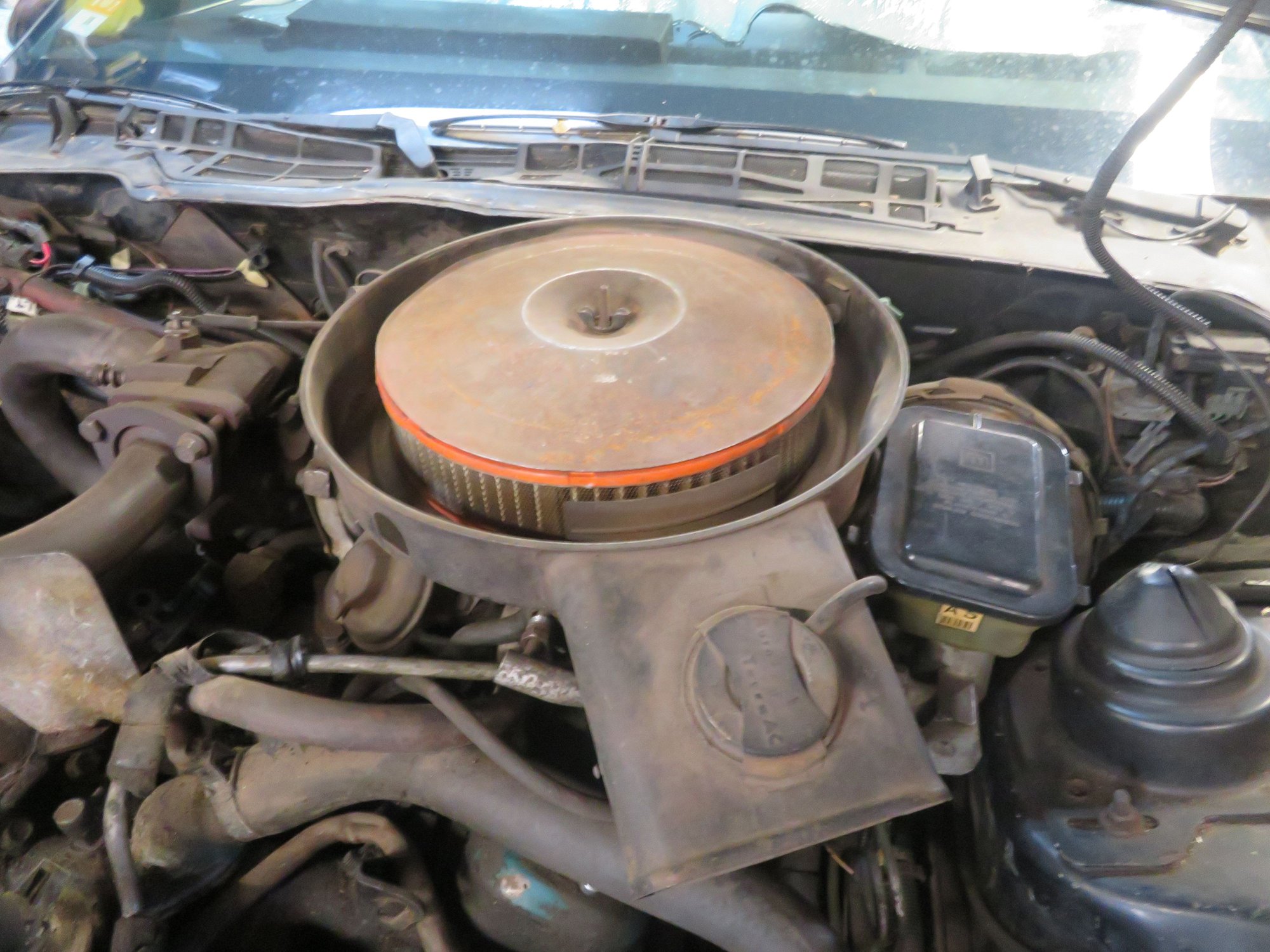

You mentioned the "Power Bulge" hood, and is the main reason for my project. I already had the 301T, and it was the perfect addition to fill up the hood bulge. Not sure if I posted it here, but here's a few pics of it, in its "preliminary" stages. Everything to be worked out...as I go along. As for the clutch, I started off installing the factory hyd. system, (reluctantly), then came across the mech. parts, that I totally forgot I had, buried away. 40 yrs in the same garage, you tend to accumulate more than you need. But I'll bet you can relate.
(Why are these photos so "HUGE". I tried posting from Photobucket, but it wouldn't allow it,,,for some reason. So I did it thru these attachments. Maybe the staff here can help.)

so hawks and american powertrain make a hydraulic release system that are not factory style. The master bolts to fire wall w stock hardware and connects to the stock pedals. The release bearing replaces the slave cyl. This enables you to use any bellhousing like your BOP style. So worst case, you have options.

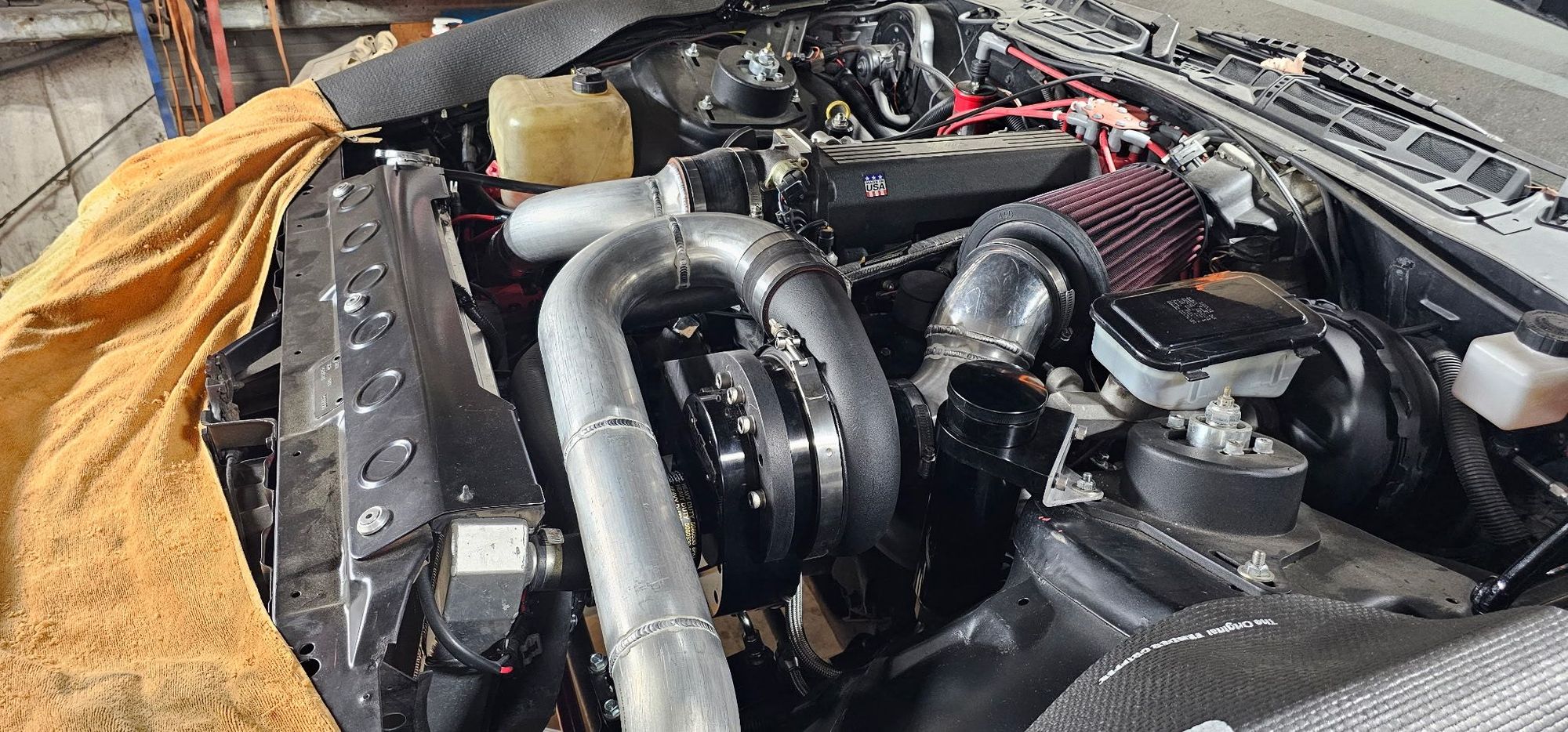

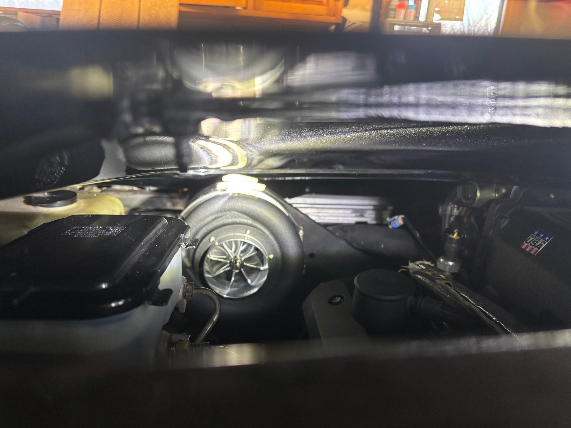

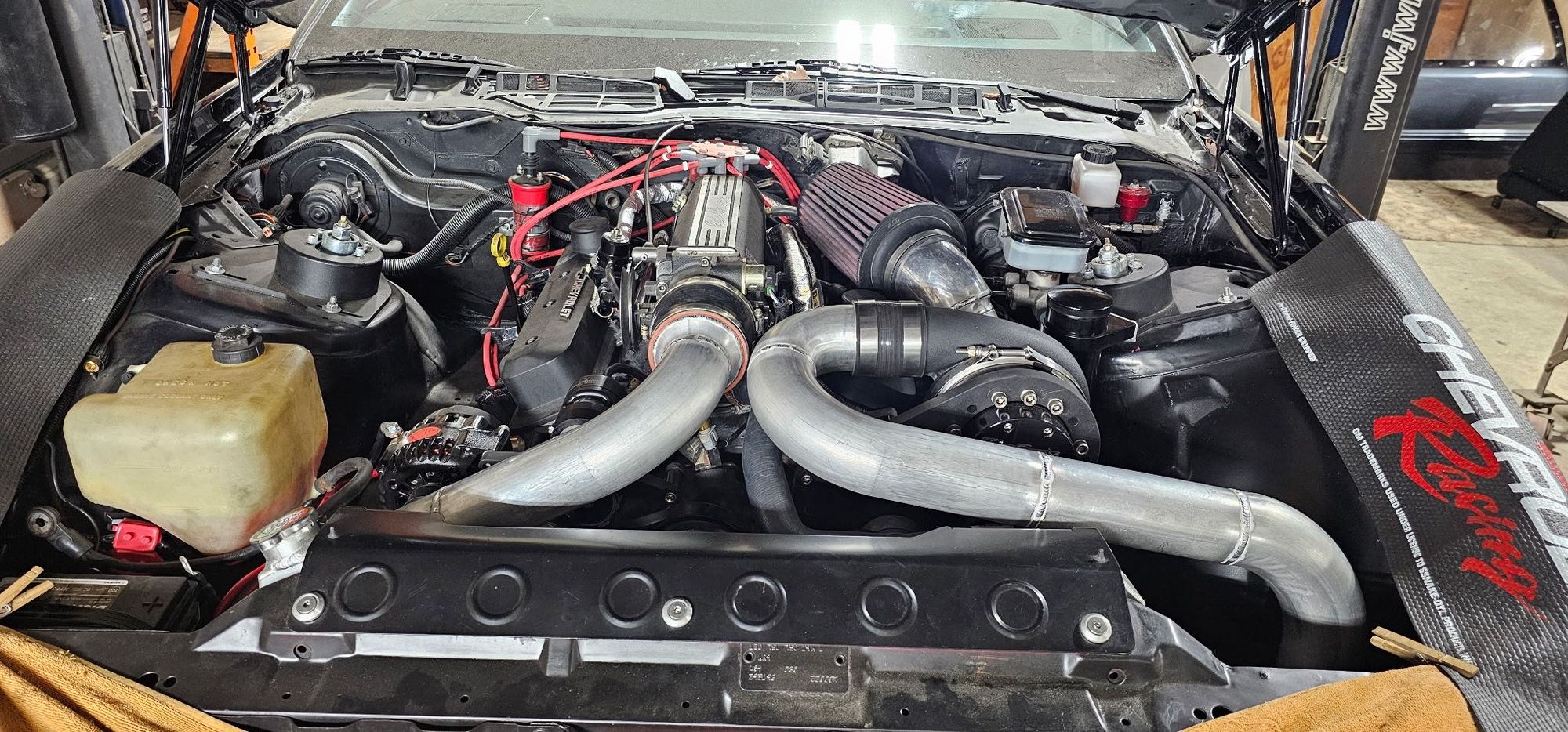

What you've done here is really cool. When i put the supercharger on my car i mounted it up under the buldge and have the air filter up where yours is. The buldge is the perfect home for something cool.

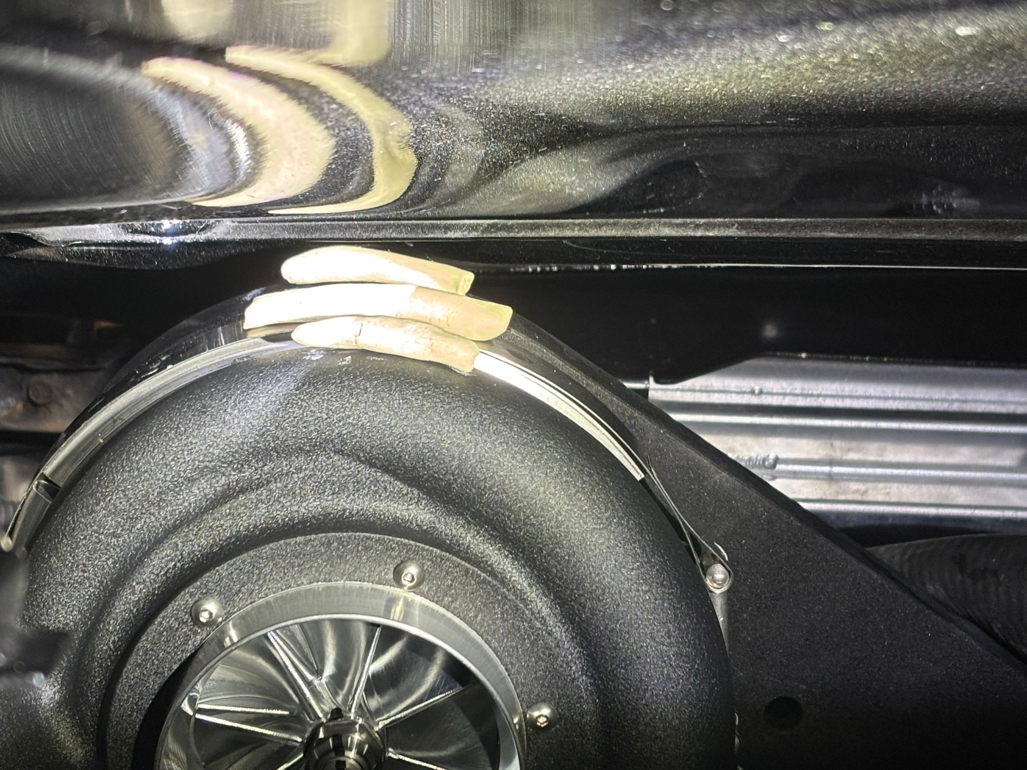

Interesting, with the supercharger. Wondering how it's offset, under the hood bulge. Any pics? Better yet, do you have a build thread?

no build thread. Thats a world of organization i don't have!

LOL. Wow. Talk about cuttin it close. Looks like we both have a few thousandths to spare. Radical ride, dude.

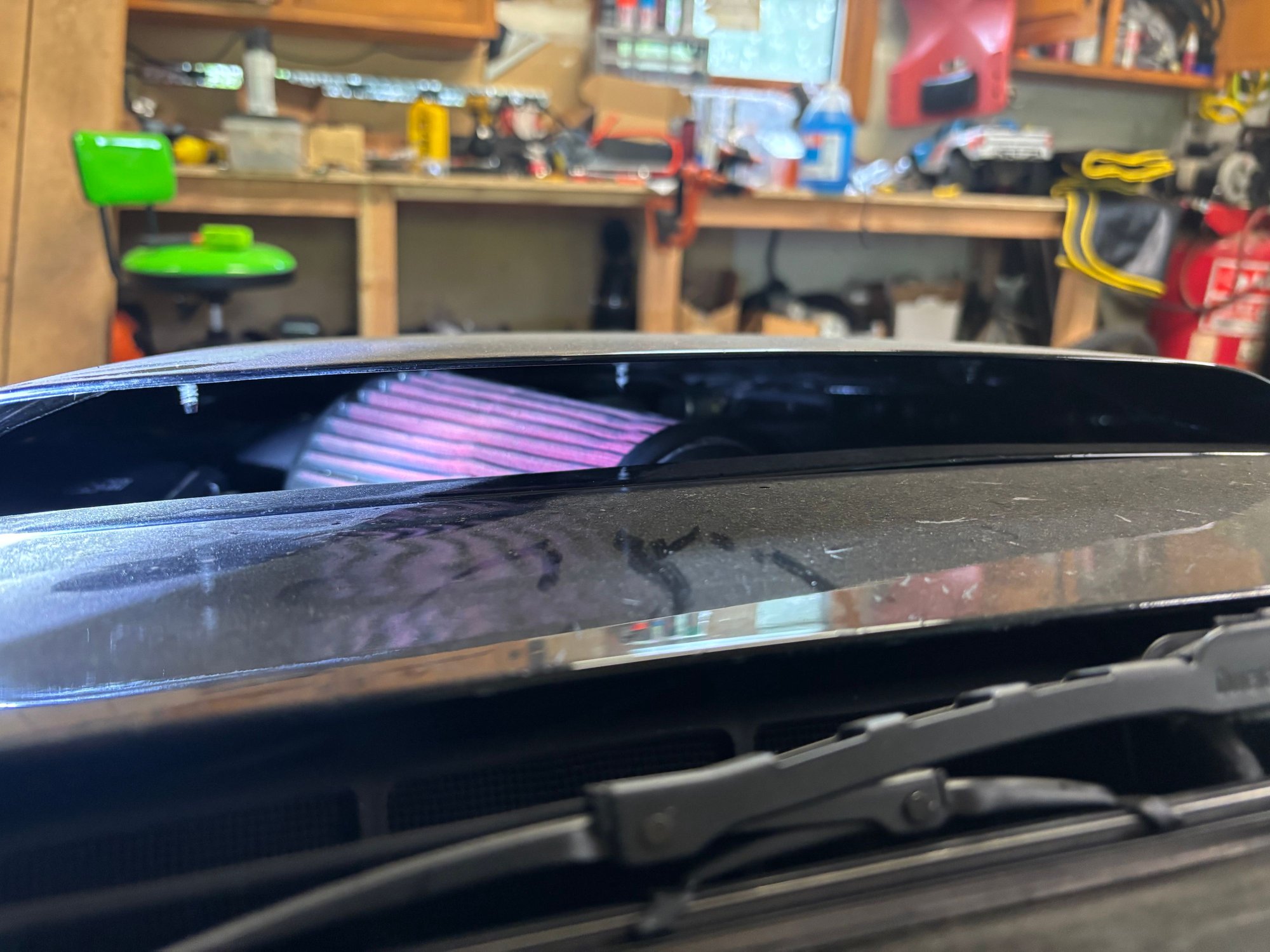

these are taken pics from just out of the opening in the bulge by the wipers, i used my kids modeling clay to gauge clearance. Yeah, it was tight.

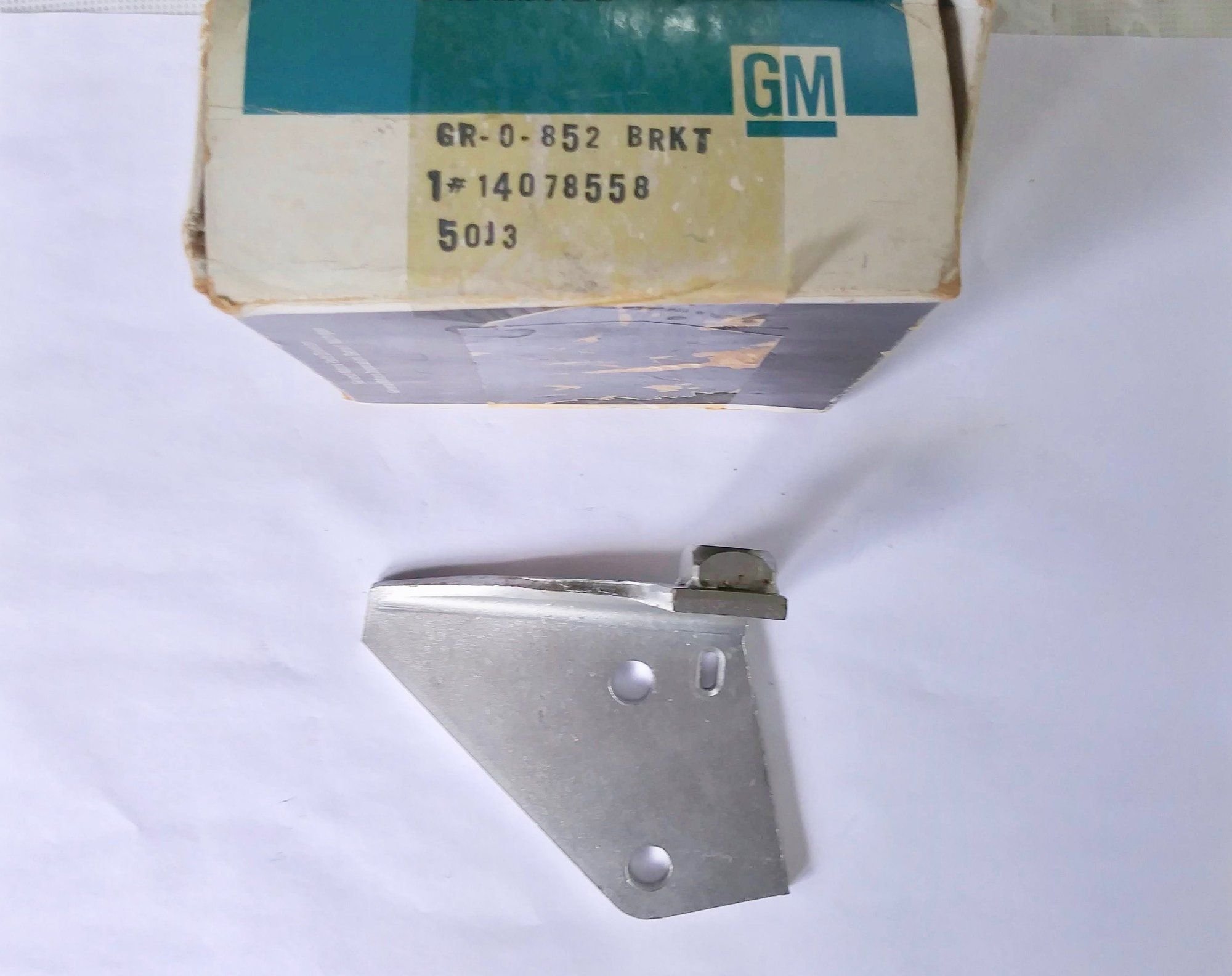

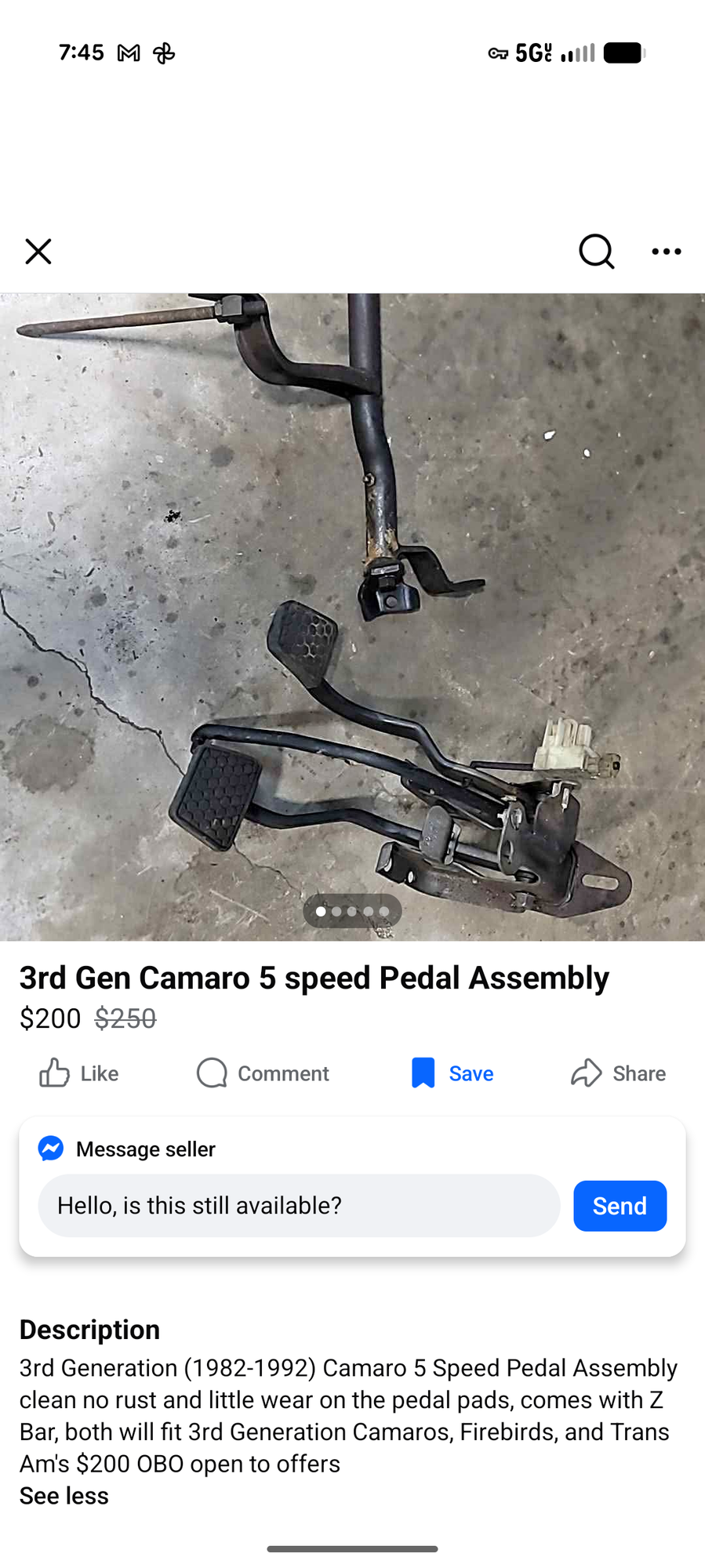

I'm not familiar with the specific piece, but thought I'd share this in case it contains what you need.
https://www.facebook.com/share/1HqasaECWc/

I'm not on FB, so i couldn't open the link.

Located in Saddle Brook, NJ

factory 14078558
Man this little plate looks simple as hell. If anyone can take a few key dimensions off a real part, I'll model it up and post the design drawings for free.

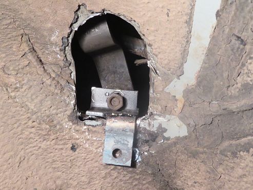

Thanks cody, but I already made one. (Wish I didn't have to) And @ CamaroZ, you have a photo of what I already have. Needed the other bracket, missing from the frame end of the Zbar.
Nothing is pretty yet. Just roughing things in. Thanks for the replys.
