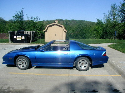

This is how I solved my clearance problems after my 327 swap. Just got around to uploading the pics.
Also I just bought some 89 Iroc wheels, smokin deal. So my question is what is the best clearcoat-paint remover to use to refinish and polish them ? BTW I have 4 RS wheels for cheap, cheap....one more thing, on my 89 rs with cast drums do I HAVE to use the 1/4" spacer? or is it optional?
Thanks in advance, Thought I might post a pic or 2..

Thanks Madmax, It's been awhile since Ive posted any. I would have like to have seen the cowel scoop when I was looking at my options but I couldnt find any pics showing it in the unfinished state.....Hmmmmmmmmmm maybe thats what I should name my car..
Anyway it really moves alot of air..I couldn't imagine trying to look over a 4" scoop, mostly for straight ahead driving I think.
With my setup and a 1" spacer with the edelbrock 14x3 AC signature series, Just the top of the ac clears the hood. I think I will go to a 2" spacer.

brodyscamaro
Yep it's the 2.5...I used pop rivets to mount it. Fairly easy job. although I did find out our motors are not centered in the engine bay.....they sit slightly to the drivers side...
