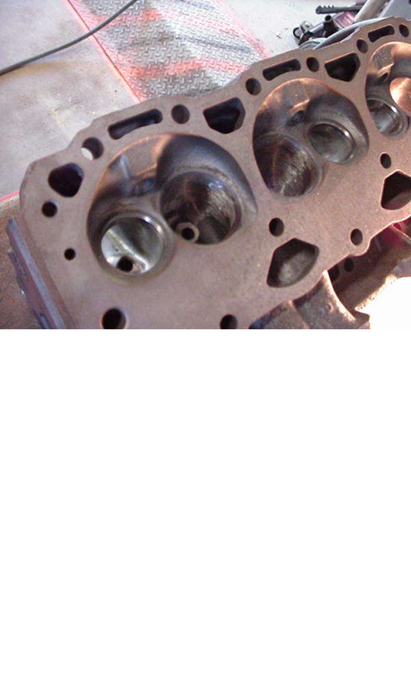

One thing I would do no matter what. If you look just under the valve seat, you will see a few machining ridges. Take those out. I bought 2 SA Porting kits and went very slow. I don't have pics of before, but here is some of after.

Here is another

yeah, that looks like it would have needed some work done. thanks a lot. prolly didnt take you too long either. worth it though.
