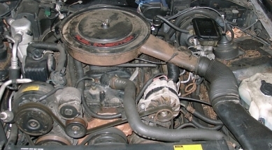

here are some pics of the TA im using for the swap
