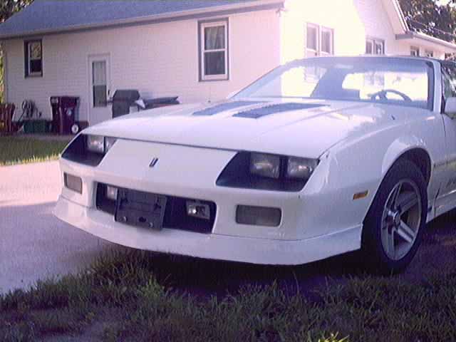

Is there anyway possible to still use the Tuned Port intake on a BBC. In other words is there anyone out there that makes an intake manifold that lets you still use the Tuned Port.
I am considering a 396 to drop into my 86 Iroc. I still wanna have it look sorta stock. I know to the trained eye, you can tell the difference in a big block and a Small block, but I really don't want to go with a carb. Everyone has a small block in there thirdgen, I want to be different, so I really don't wanna go with a sbc.
If there is no one that makes that type of intake manifold, what are some of my other options?
And a pic of the project.
