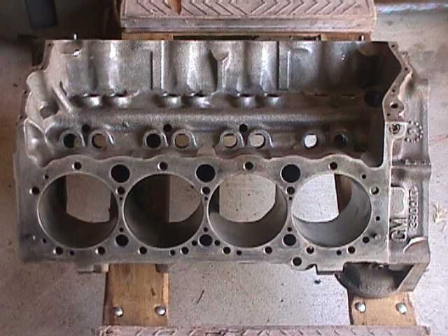

Look in the rear of the block on the driver side you will see some numbers, which would aid in identifing the block:
Look at this block below see where it says GM, then you see the numbers (330817), thats where you need to look, then go to mortec web-site and find your block.
http://www.mortec.com/castnum.htm
