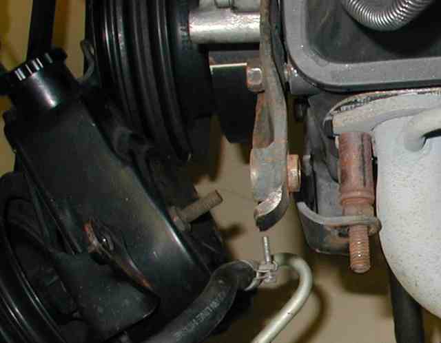

Has anyone ran into problems with a motor swap and adding headman hedders. I need to figure out how to secure my power steering pump so it doesn't wobble. It's bolted on right now but on the driver side it's loose (nothing to bolt up to). Not sure if the March Front Mounted Power Steering Pump bracket would fix the problem or not.

I am having the EXACT same problem right now. I can have a long bolt and a spacer that I used to keep my bracket away from the block but now I can't remember how my pump is mounted. I hope someone replies because I am curious as well.

I made spacers to exactly duplicate the thickness of the manifold, and put all of the stock brackets back exactly where and how they belong, using the stock hardware. That's what I've always done with headers. I don't try to rig stuff, it always ends up costing more, being more work, and causing more trouble than just doing it right in the first place.
Works perfect. Air conditioning and all.

thats exactly how i have mine setup

Thanks for the pictures, it seems to me now that I am missing a bracket completely. I am definitely going to fix that when I get home.
