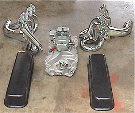

go for the big block all i need is the block
keene
Old Oct 30, 2003 | 01:14 AM
ckeene502's Avatar
Posts: 253
From: Elkmont, AL
k
