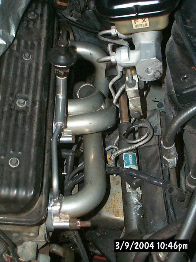

Papa's got a brand new bag .
Old Mar 9, 2004 | 11:16 PM
  #60
pasky's Avatar
Joined: Apr 2003
Posts: 3,563
Car: 1991 RS Camaro (Jet Black)
Engine: 95 383 CI (6.3) LT1
Transmission: 95 T-56
More here:
http://www.geocities.com/pasky13/headers.html
Ghetto header bolts . Actually had to use 3 different types haha.

Ugh, the passenger side headers are a pain, I was out there for about 2-3 hours trying to line it up and getting torn up by mosquitoes and ended up bending my dip stick holder, sigh, it came off the little retainer holder, will this leak eventually?

Pasky, you might want to look at the brake lines by the number 6 primary, looks like it might be touching or very close to the header. Looks good though.

Yea, it was late and didn't want to bother, I saw that last night and already bent it out of the way, nice eye .

Finally got the passenger side headers in. That sucked royally. That very last bolt towards the firewall was a pain in the ***.
I had to use an allen wrench and a peice of pipe to get it, it literally took me 3 hours total manuevering that thing and having it slip out 20 times with me going under the car to get the allen wrench again. I
Its very tight on that side, the headers are real close to the heater hoses on the side of the car. Im thinking of bypassing the heater hoses, its that close.
