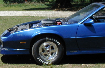

adam, my Holley contender with a 800 holley wont even come close to fitting. Had to get a 4" cowel hood to run a decent air cleaner,,,wich is vital
Old Jul 22, 2004 | 04:54 AM
Riley's35089rs+'s Avatar
Joined: Nov 2001
Posts: 2,743
From: heartland
Car: 89rs (previous 2.8)
Engine: 406
Transmission: 700r4 (for now)
bit high

Wow Riley....is a Holley contender taller than a Air-Gap type intake??

i needed the spacer to clear the distributor as well as the bowels on the holley...

with spacer

The carb looks the same, but your intake looks quite a bit taller than mine. I guess we'll just have to see what happens. I doubt I'll have distributor clearance problems, so just a low rise air cleaner will likely do the trick.
