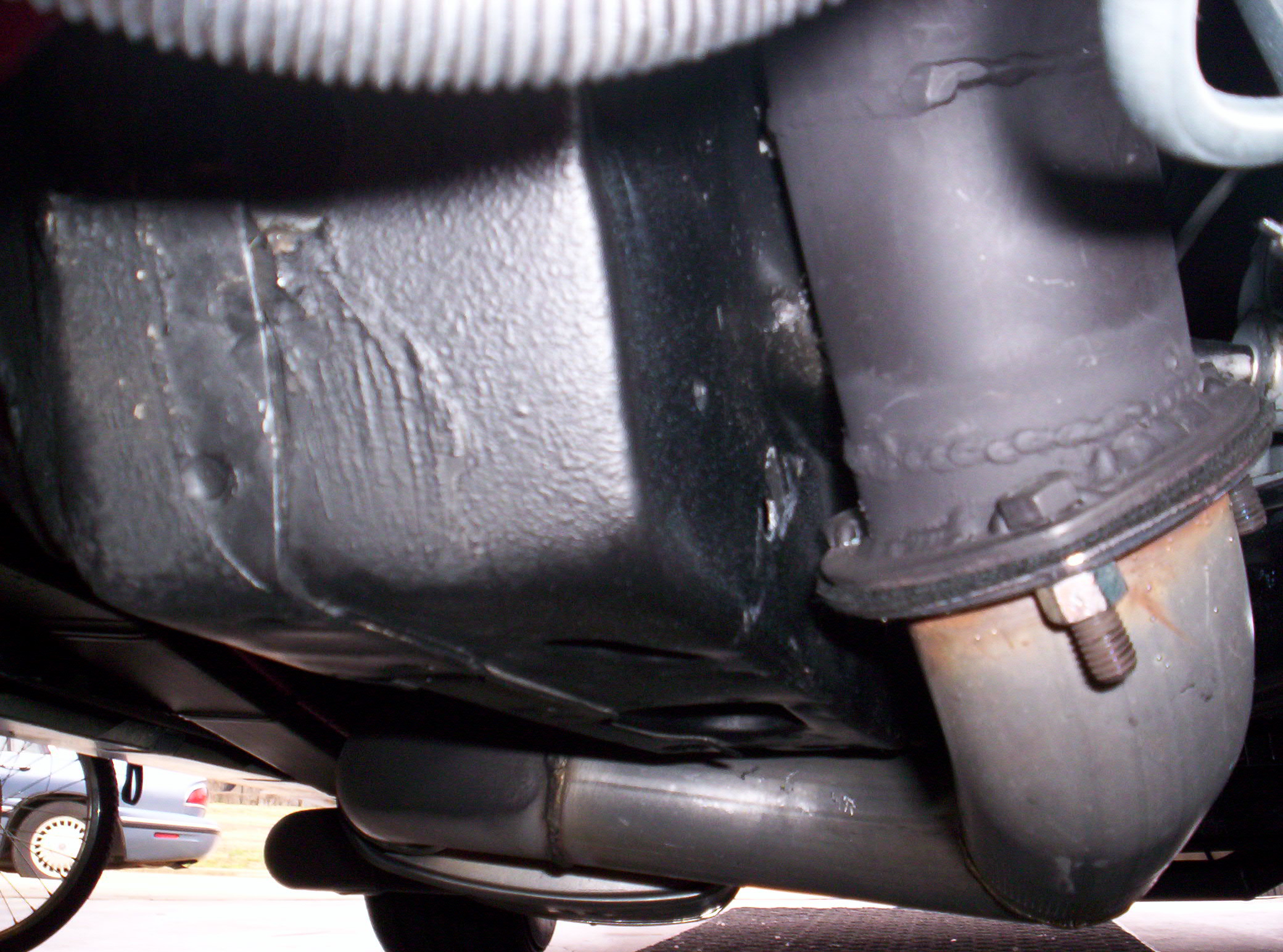

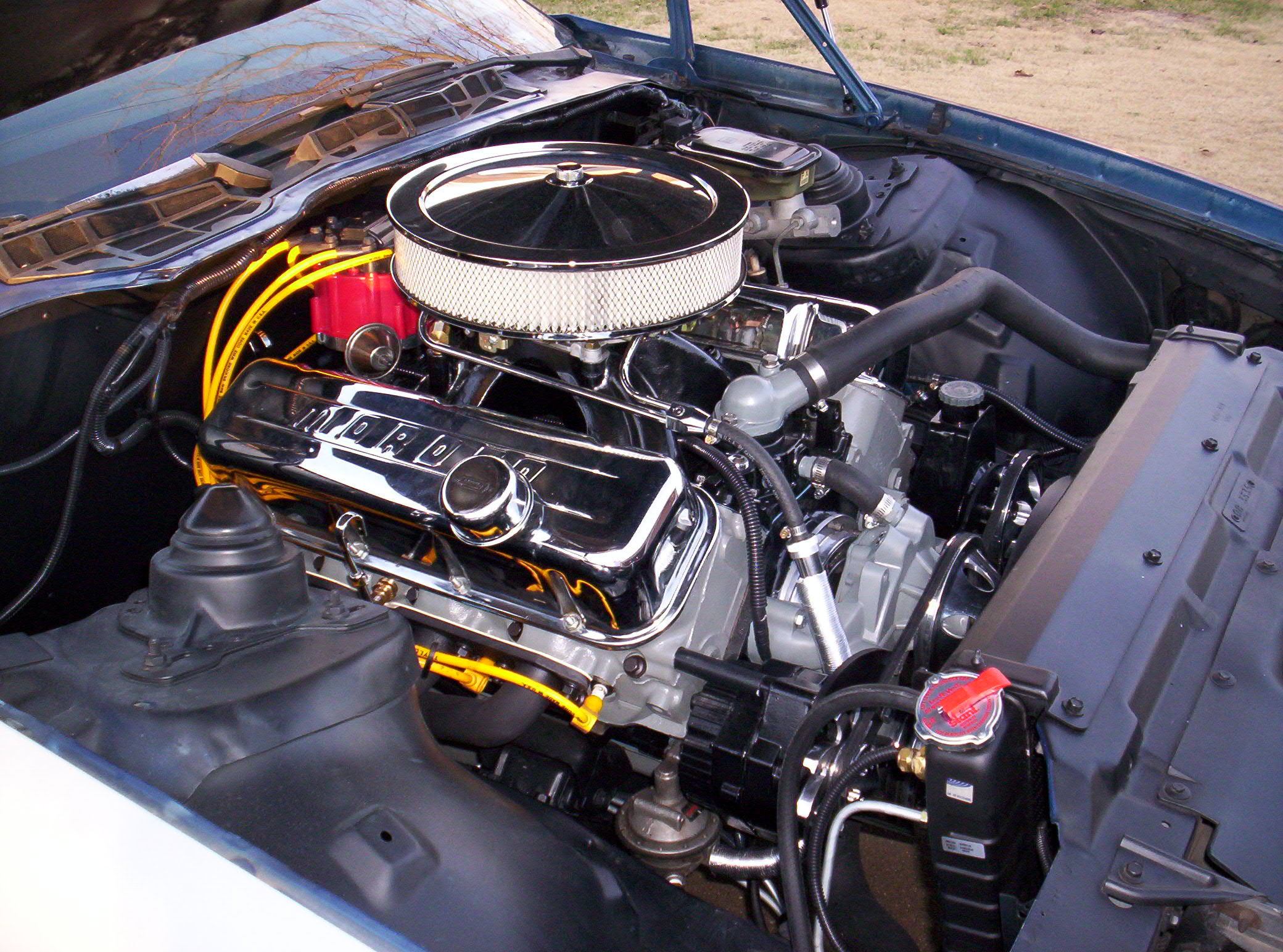

Here's a couple of PICS. One of the engine and one of the exhaust. The other side looks the same. I still need to jack it up and take a couple of pics of the header mod. Started stripping the paint and priming.
Boo.

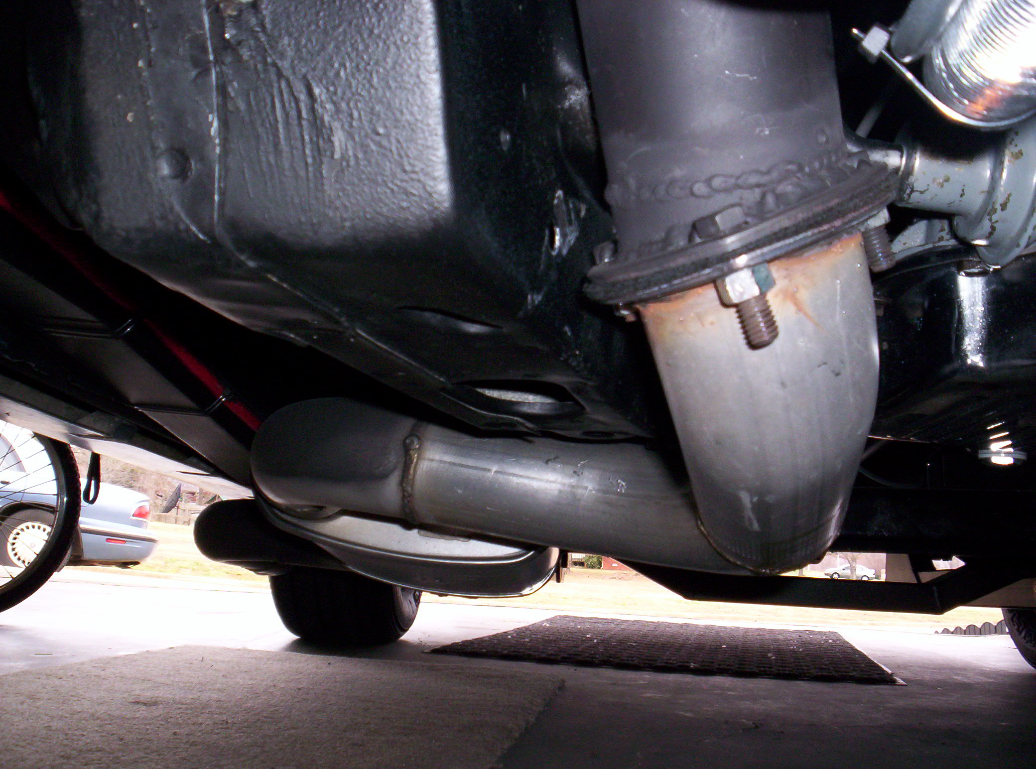

Everyone else...sorry this has taken so long. I got some pics under my car of the pass sied header mod I made to make the exhaust system a little easier to fab. I threw in one of the driver side just to give an idea of how to reu the exhaust.
Later,
Boo.
Attached Thumbnails BB Engine Swap Header-100_0803.jpg   BB Engine Swap Header-100_0804.jpg   BB Engine Swap Header-100_0805.jpg
