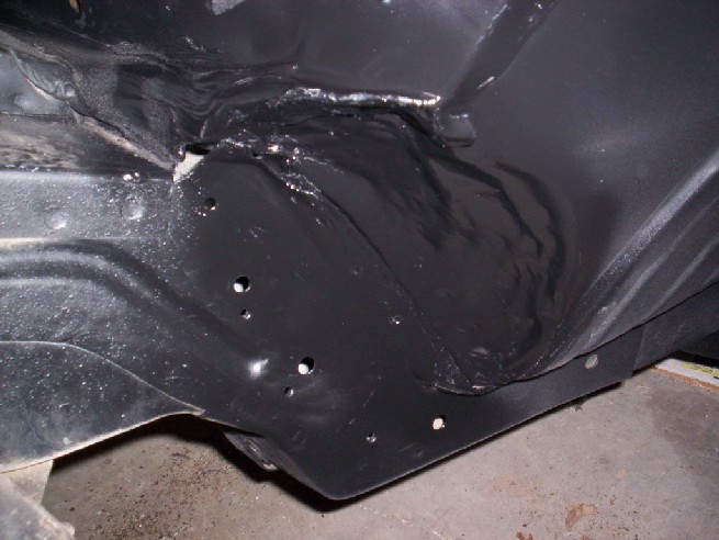

Old Feb 16, 2005 | 04:51 AM
booboosean's Avatar
Posts: 161
From: Harvest, AL
Car: 1989 Camaro RS
Engine: 396 BBC
Transmission: Turbo 400
Axle/Gears: Moser 9 inch/4.56 gears
It depends on how much weight you are going to remove off the front end. In my case, I will not gain any weight with the big block because I removed the entire A/C and Heater system, and moved the battery to the back. If you do not remove anything, you will gain between 150 and 170 lbs depending on your combo.

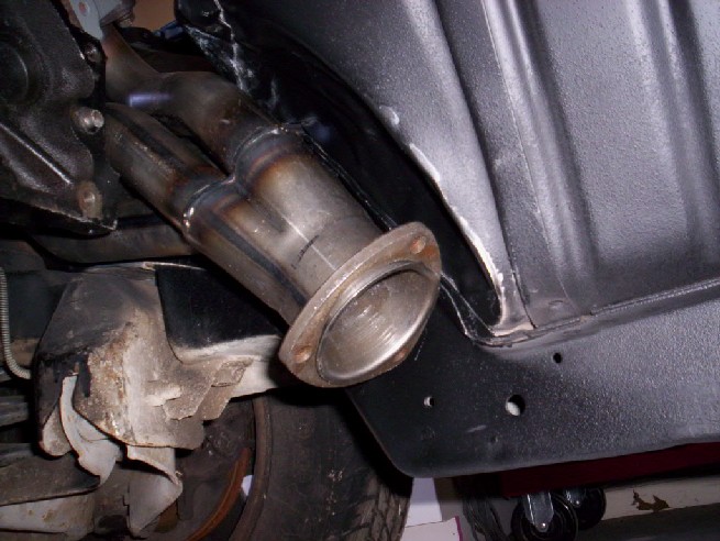

Attached Thumbnails BB Engine Swap Header-h-my-documents-driver

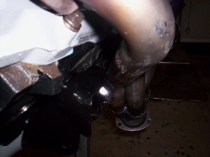

Old Feb 16, 2005 | 04:52 AM
booboosean's Avatar
Posts: 161
From: Harvest, AL
Car: 1989 Camaro RS
Engine: 396 BBC
Pass Side. Note the flange location. This is where it's hitting the fire wall a little.

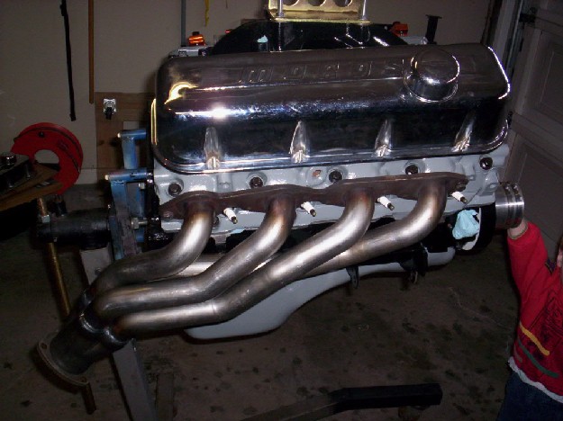

Old Feb 16, 2005 | 04:53 AM
booboosean's Avatar
Posts: 161
From: Harvest, AL
Car: 1989 Camaro RS
Engine: 396 BBC

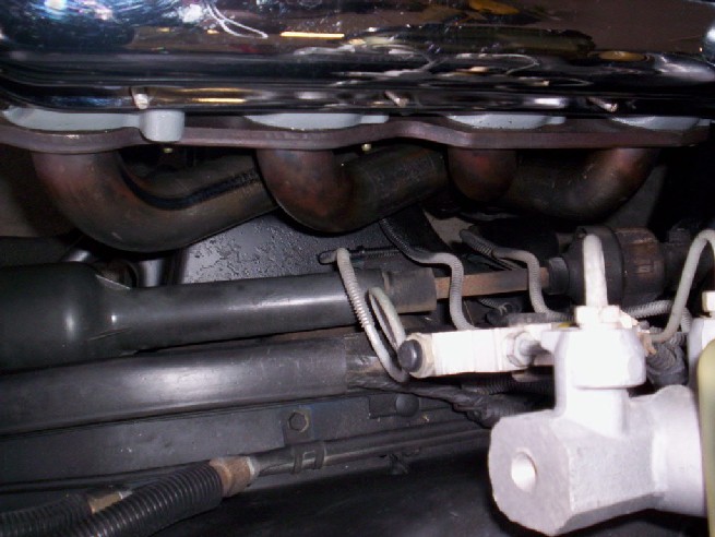

This is the driver's side motor mount after a little grinding and repainting.
Attached Thumbnails BB Engine Swap Header-h-my-documents-mount

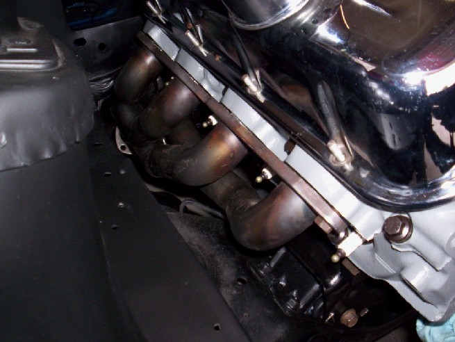

Old Feb 16, 2005 | 06:21 AM
booboosean's Avatar
Posts: 161
From: Harvest, AL
Car: 1989 Camaro RS
Engine: 396 BBC
This shows the header installed and where the tube runs next to (through) the modified motor mount.

I think you've come up with something here. Considering the modifications required just to put headers on a small block, grinding away that much of the engine mount is nothing. And, considering the amount of hammering I did to the transmission hump of that '75 Vega just to get a V6 in, the passenger side interference seems insignificant.
The Exhaust forum should see this, too.

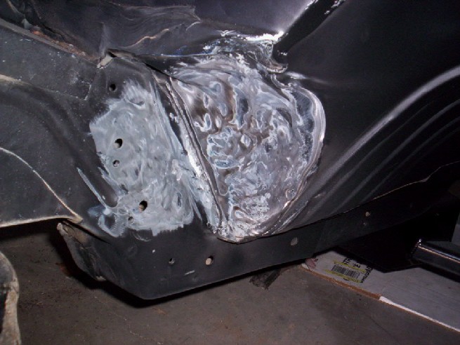

Old Mar 10, 2005 | 07:03 PM
zrotten's Avatar
Posts: 45
I spent the big bucks and went with the big tube
LEMONS HEADERS. I do have to mention that you have to cut the wheel wells open for two tubes to run down and under to the slip on 4 inch collectors. It took about two hours to make the opennings look show quality(even and deburred). After fitting and double checking all was good , off to JET-HOT!
If any onewants some pics send me your email
OH the best part about these headers, each pipe is seperate and can be installed while the BBC is in the car!!!!
Attached Thumbnails BB Engine Swap Header-c-documents-settings-administrator

Ok, I finally got time to work on my car this weekend. I ended up putting the motor in and taking it out a couple of times. The first pic is one of the dent under the firewall on the pass side after about 10 minutes of "careful" metalwork (hammering).
Attached Thumbnails BB Engine Swap Header-c-documents-settings-swballar

Here it is painted (paint still wet). in case anyone was wondering, you can't see it from the top.

I put the motor back in and put the header in from the top. Very easy without the spark plugs. Just drops right in.

Here's a shot from underneath without the transmission installed.

Here's a shot of the driver's side. The only mod here was to the motor mount (in an earlier pic). As you can see, there is plenty of clearance for everything. The lower control arm mount has about an inch and the steering shaft about the same. It slid up from the bottom.

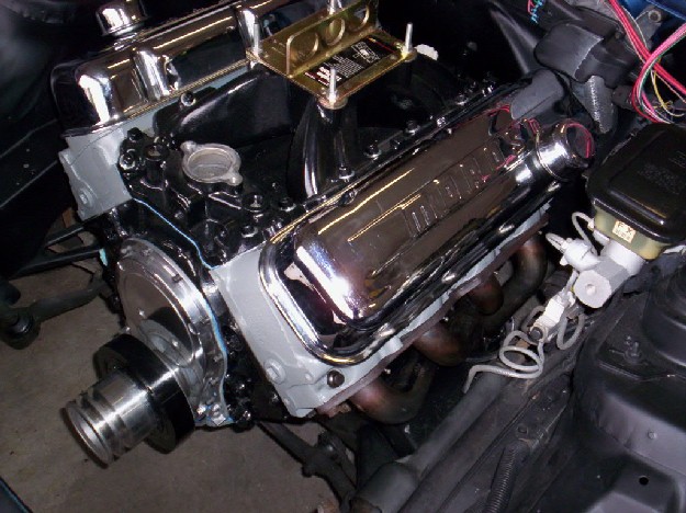

For anyone who hasn't had experience with them before, I installed some poly motor mounts while I had the motor out, and they raised the motor about a half inch. The directions in the package said to check hood clearance before closing the hood. I didn't think much of it, then realized as I work on this car, every half inch counts. I don't need the "duhs"!!

wow, so no modifications to the headers themselves?

WOW that looks great i know which headers i get for my bbc when i finish it. that just made my decistion about which ones to get and yet ill still be able to do what i wnat with my car now. sweet.

No, I haven't had to change the headers at all. I bought them "raw" in case I had to cut them and it turned out that I didn't have to. Of course you've noticed that I do not have an A/C box, so I don't know about clearance in that instance. All Patriot would have to do to make these fit is turn down the exit on the pass side. I think I'll send them pics too. Maybe they'll take it seriously (especially since I've already made mine work) who knows.
good info!!..Did you measure the clearance between the firewall and the flange.Also the clearance on the frame reails/tubes.Im thinking what would happen once it settles,engine shake/vibrations or body twist..

Are those poly mounts? If they are, that clearence is to close.
You might want to use a set of Moroso solid SBC mounts.
Thats what I used for BBC. Also take the torches to the k-member and cut a small slot for a box wrench to slip right in there, makes the job go real fast.
Rotten

Yes they are poly "inserts" and I have no concerns about the tubes being too close to them. The pics are kinda deceiving, there's more clearance there than you think and they are protected by the metal housing they reside in.
I had solid mounts in a street car once------once and never again.
There's enough room to get your fingers between the flange and the subframe rails. The flange can also be turned to the optimum position. Unless the engine settles up, the tubes aren't in any danger of hitting the firewall. Also, the engine torque should be the opposite direction lifting the driver's side up. If this turns out to be an issue, I guess I'll get my hammer back out. Hey, it can be as tight or loose as you want it. I noticed that after I dented the subframe rail and installed the header, it wasn't really necessary. The firewall/floorpan were the real issue.

Those headers worked out great. So all you had to do is massage the floor on the passenger side and trim the motor mounts right? I never heard you mention were you could get these headers.
