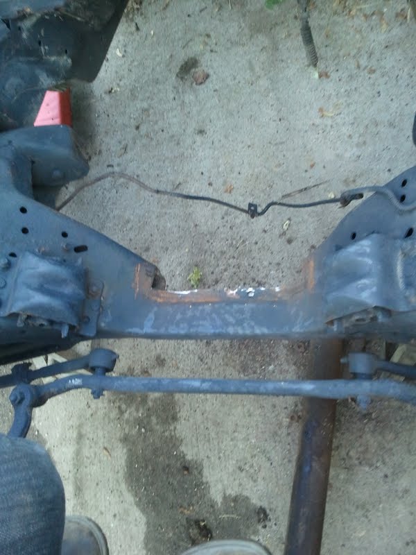

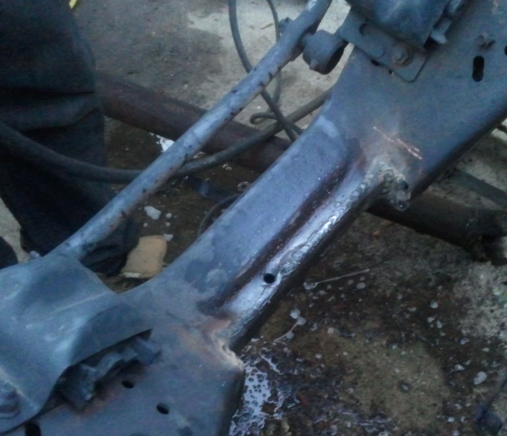

Re: BB Engine Swap Header
Last edited by 92 BBC Z; Sep 3, 2010 at 06:57 PM. Reason: left out text: "You mean like this?''

Yeah, with solid mounts, kick-out pan and two(2) pair of sfc's, it takes a little bit of gumption to make it fit, but no BadAss car is easily built. If there's a will(with skill's) then there's a way.

By the way, I was able to install them with the motor in place, from the bottom, but the front tire's removed, and jacked WAY up off of the ground, then sort of 'twist' them in place. Still took a substaintial amount of messaging(read hammering&trimming) to fit without touching everywhere.

i went with the h8012s on my 496, they might be a bit small but i bought them when it was still a factory headed 461. i had the typical issues with the drivers side mount(2 minutes with a cut off wheel solved it). i had a much bigger problem with the passenger side because i'm running dart heads with raised exhaust ports. hammering wasnt quite enough for me with the frame rail, so i cut reliefs in the floor and frame rail. also i used a truck pan with the stock k member by cutting an an inch or two out and useing the peice i cut off to fab a cap and welded it over the slot.
the car isnt on the road yet but i'm hopeing i'll have time to finish it before port huron michigans cruise night a month from now.
Attached Thumbnails BB Engine Swap Header-slot.jpg   BB Engine Swap Header-capped.jpg
