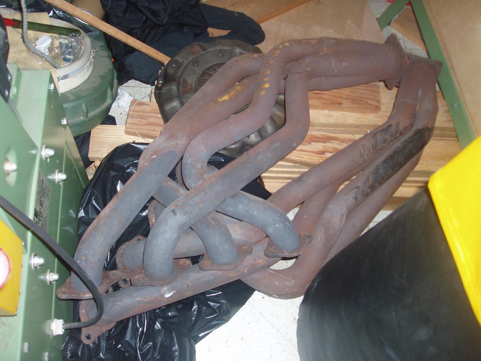

If you go with a 396 or other BBC and are going to use the Hooker 2226 swap headers go with inboard sfc's. The outboard sfc's are right where the Hooker 2226 collectors come out.

I have a question about headers for a big block and figured id post here since a lot of members with big blocks look at this thread - not trying to hijack your thread. Im building a 468 and for my heads i ordered gm performance aluminum rectangular port heads and the exhaust port is a d shape. I just looked on summit and saw that hookers full legnths and the Patriot H8012s both have round exhaust port shapes. Will these headers work on the heads? is the round exhaust port larger than the d port so that it would cover it
I`m using the merlin rectangles and the exhaust ports are D shaped too, I did a little port matching to make them perfect but used them a year or two as delivered before I did that even, but yes they `ll work.

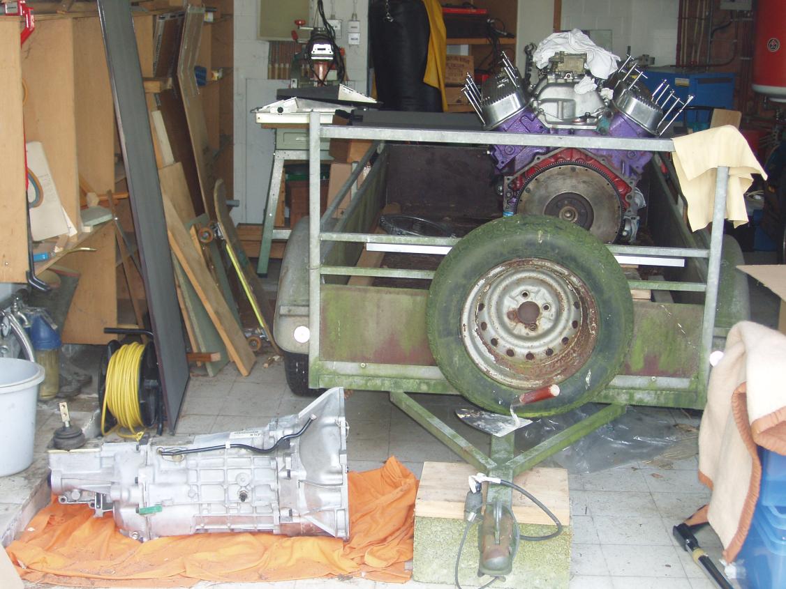

Axle/Gears: 10 bolt 3.42
Hi all. I'm new to this board. Lemme briefly introduce myself : live in Brussels, Belgium. Am driving one of about 15 (only fifteen!) third gen camaros in the country. you couldn't wrestle me in another car anymore even if you were the governator himself :-) Just bought me a 4-bolt 454 big block and a T-56 gearbox. I just hope I didn't bite off more than I can chew :-) I love this thread and will certainly post my adventures with the bbc build shortly. In the meantime, I'm learning by reading about your experiences. Cheerz, and it keep it up !

thanks , Scott !
Where I live almost no-one knows what a camaro is, when I drive in the city people are looking and staring, and you can tell the question mark on their face : what the hell IS that ? They think it's a Ferrari, but something isn't quite right. It's funny. Even most "car people" here don't know what it is. Here they're all into japanese and german cars. I think it has a lot to do with : FUEL CONSUMPTION :-) Gas is very expensive here, 1.2 euro per liter. I'll try to convert that to your dollars-per-gallon, but it's tricky. I hear there are "imperial gallons" and "us gallons" and they're not quite the same. Anyone who's got some good conversion tables will be able to tell you : gas is EXPENSIVE in Europe. And here I go putting in a big block. Ow yea :-))) Cheerzz

BBC 454 in 1989 camaro
Hello guys, I finallt found a competent mechanic who will assist me in the engine swap. (Here in Belgium, there aren't too many usa-car skilled mechanics around) Anyway, his major concern is with the headers. Which would be the least complicated to install ? The Patriot headers ( I've read booboosean's posts) , The hooker 2226 headers ( I read on greezemonkeys cardomain page that they arent all that easy either ??? ) , or the Hedman headers ( couldnt find any real info on those ) ... or can anyone recommend something else ? Thanks !
BTW it was quite complicated mating the 454 to the T56 sixspeed transmission. If anyone likes to know more about this, just post a reply, I'll be happy to tell my "adventures"

If I were buying new headers,which I assume you will be,I'd go with the Patriots.I just installed the Hookers on my car,and from what I saw in BooBooSean's post,I don't think there is any more modification to make the Patriots work than Hookers.The only drawback I can see is maybe a small sacrifice in performance using a 3/4 length header as oposed to full length.I would love to see a head to head dyno test of these two sets of headers.

Thanks for your reply Irockz , well Greezemonkey called them (on his cardomain page) a "cruel joke" that Hooker sells. Would you agree ? I mean, if I spend $500+ on a set of "engine swap" headers , I would like them to also actually FIT without headaches. Thats the only main objection of my mechanic, he wants to help me make the swap but he says he does not want to start cutting up and welding headers anymore. Maybe he's getting burnt-out , I dont know :-) Since I have spent already quite some time and $$$ making this monster happen, I would like to get the maximum horsepower possible from my headers , so I am leaning towards the Hooker headers more than the Patriot ones. Even tho they seem to cost only a fraction of the Hookers.

Well, thier not headers but anyone looking to put a BBC in a f body can use 2003` 8100 avalanche truck manifolds, A member "496chev" used them in his conversion and they fit without issues. They are tubular stainless steel and remind me of old flathead V8 headers here`s the thread...
https://www.thirdgen.org/forums/engi...ot-my-big.html
pictures are somewhere but not in this thread, but he did post them in one of his, I remember seeing them installed.

thanks for the reply greezemonkey. Love what you did with your camaro :-) Actually I had two questions for you : that strut tower brace , what brand is that ? I was thinking I would need to fabricate one because of the BB. And my other question is related to your cardomain page. You have a very clean looking dual exhaust there. On Hooker headers website they claim to offer a complete exhaust for the F-body that goes together with with their super comp headers. I'll contact them about it, because I doubt they actually do (never heard of it) If they dont , could you be interested in fabricating a duplicate of your fine exhaust work for me ( in exchange for some bling-bling off course ) seeing as you already have done it before. I am mainly asking this because I cant weld myself, and my mechanic, as mentioned above, breaks out in a cold sweat at the thought of cutting and welding. I think it must be some childhood trauma :-)) He agreed to build the swap IF he wouldnt have to do the ... yes, exhaust fabrication. So I'll be trying to hand it to him on a silver plate :-) cheerzz.
oh yeah, about the exhaust manifolds ... thanks , but I am really going for every possible horse that's in there !! ;-) Will be using some kind of headers

Thanks for the compliments, That strut tower brace (3 point) is the edelbrock carb or TBI brace...I had a 2 point on there that I made, I may actually still have it somewhere but, the three point made the car feel like stock again after the coil overs went in.
You know if they had offered an exhaust when I started I would have bought it, I never heard of them making one but I`d probably stay away in fear it would fit like the headers. In all honesty I gotta give them a fair shake, I have merlin heads which have raised exhaust ports (caused alot of the misery) but aside from the headers just being higher up in the chassis, they also were all over the sub body on the passenger side and they really leave you up the creek for using subframe connectors and any kind of street exhaust with the way they exit, I mean they should at least give you a clue as to what they look like before you drop what?...425 now? ( they were 375 when I bought them ) My collector`s were both pointed out board once installed... at least 5 degrees off! which led to heating the collectors and twisting the whole 3 inch tube. What ever you do do not coat them before fitting / using them for a few miles first.
I`ve been asked to duplicate the exhaust in the past and I have even considered it, but man, Belgium? shipping would, well, I don`t even want to think what they would rob you for that. I`d be happy to help you out but you may find it less expensive to have a welder put it togethewr over there, all of the parts are avaliable from any exhaust supplier, mandrel bends in 90 degree and 45 degree and three inch staight pipeing, couple of mufflers and custom made chrome tips..I`ll put a list together of the parts if you want. but yea..3 inch is the way to go even with the tiny 1 7/8 primarys. Oh yea..better port match those hookers too, there`s alot of extra material in the port entrances. Made a nice difference in power after the porting.

thanks for the reply ! I've filled out a tech assistance form on the hooker website, so I'll have to see what they say about a complete exhaust setup. Will off course keep everyone here up to speed. I dont really believe they offer complete exhausts, so for the moment I'll assume one will need to be fabd. Yes greezemonkey, youre right, shipping would be hell , and in fact I do know a competent welder here. If there are any pointers you can give about making this dual exhaust, please let me know, I will tell him. cheapest place I found the hookers is jegs , at $429. Actually, when I bought the 454 the guy threw in some headers , he said "99.99% chance they wont fit, because they're from a truck" but I'm keeping them near , hoping to install the BB within a month's time and hey , who knows , maybe these will fit ... you never know :-))) Here's a pic of those headers , and of my beloved 454 and T56 blocking the entire garage. :-) Cant wait !
Attached Thumbnails 396 BBC Swap Questions on 90 Camaro Street car-454-t56-002-s.jpg   396 BBC Swap Questions on 90 Camaro Street car-454-t56-003.jpg
