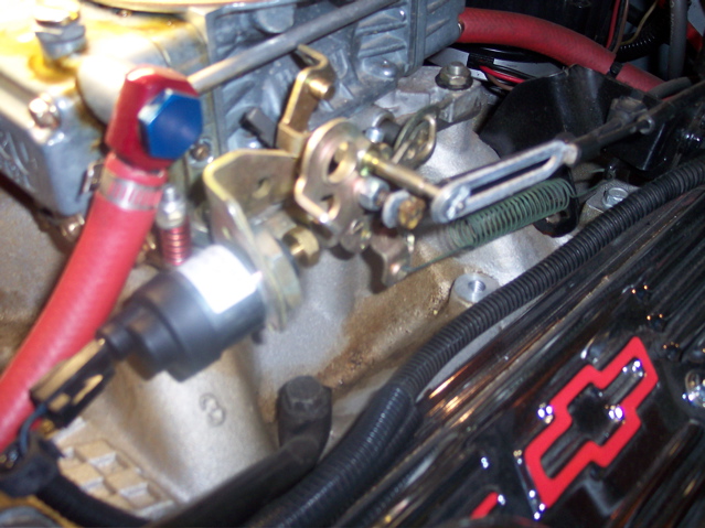

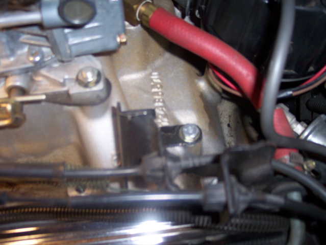

Could you take a picture with your air cleaner off?
Any other picture would be appreciated too.

Originally Posted by Comp788
James, Could you take a picture with your air cleaner off? Any other picture would be appreciated too.
I'll try to snap something in the next few days (ice/snow here). You can check my "car details" below for some pics.

Hey, Comp,
I was going to e-mail you five pics as attachments, but... Anyway, here are three (take special note of the first one):
Attached Thumbnails Throttle Cable Bracket-100_1950.jpg   Throttle Cable Bracket-100_1951.jpg   Throttle Cable Bracket-100_1952.jpg

Re: Throttle Cable Bracket
James.
Thanks!
