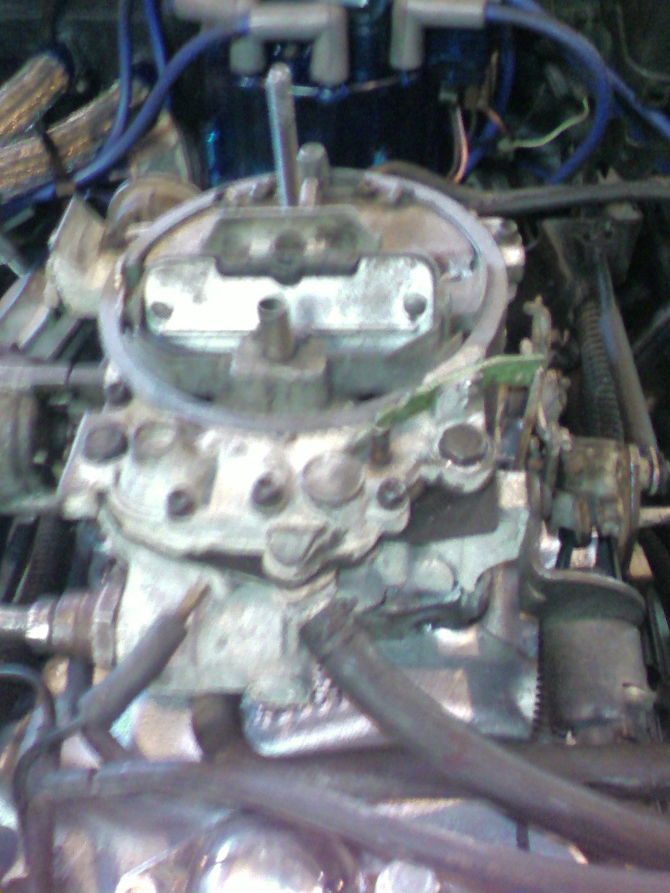

as far as i know the carb is from a 79 1 ton chevy pickup theres also no where to put the kickdown cable even tho the motor was mated to an auto tranny. what does the tvs thing do? am i ok to leave it off? sorry for the quality its a cellphone pic

well they did swap but the "timed" vacuum port isnt on the throttle body according to some searching on the internet the egr is also a ported vacuum source so can i hook my vac advance into there?

Right, the timed vacuum ports are only on the main body.
You can use the EGR port for the vacuum advance.
