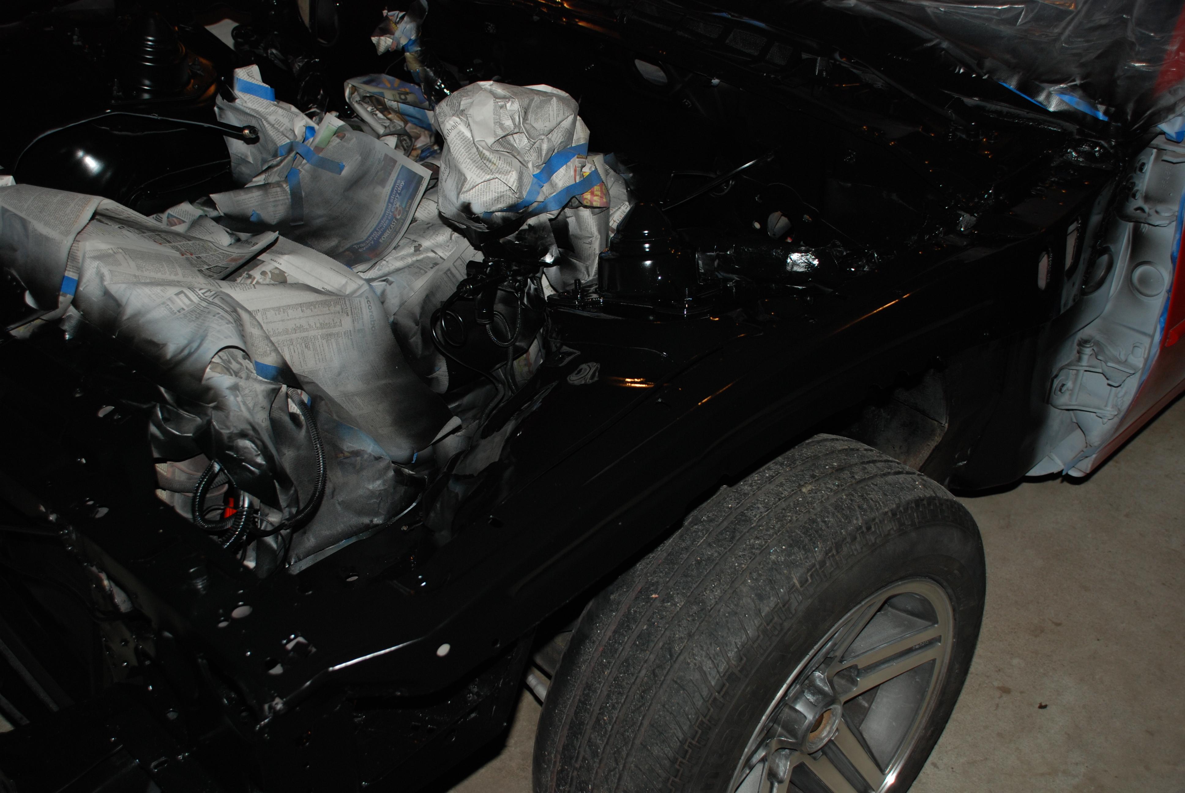

Attached Thumbnails 350 Swap+Build Thread-camaro-49.jpg   350 Swap+Build Thread-camaro-47.jpg

First of all thanks Intrepid and Mark for the help. I really appreciate it, I have a gasless flux core lincon so it's a little tougher than good clean oxygen free welds. I'm thinking of a way to weld the hole and think I found one, I post when I do it. I am not just posting to say thanks though, I'm posting cause the Dac got some serious work done today!!!!! I made a big step forward in my project by painting the engine bay. I gave a single coat with self etching primer. Then two coats of high build primer. Followed by a coat with rustoleam's semi gloss black, all paint layed was with my trusty huskey paint gun lol. So here's the pics boys, and beware that they may look a little glossy because the thing still is drying:
Don't freak out just because you can see some primer, I'm going to recoat tomarrow.

Hey man, I think I have the same welder as you.. with flux core.
Wow the engine bay looks really nice

Yeah I really need to do that to my car...
