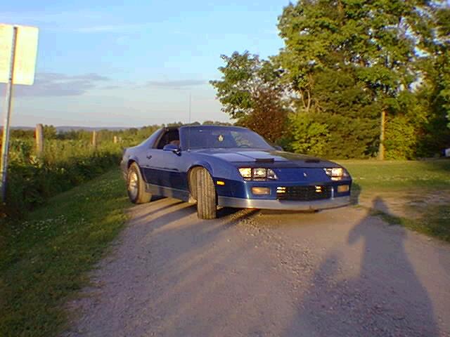

I just got pics from my car ... here it goes

Old Jul 24, 2001 | 11:20 AM
mat89RS's Avatar
Joined: Apr 2001
Posts: 884
From: Québec

Old Jul 24, 2001 | 04:41 PM
multi-tasking's Avatar
Posts: 219
From: ABQ, NM
Looks very nice! The seats look like 3rd gen - are they?
Old Jul 25, 2001 | 12:59 PM
mat89RS's Avatar
Joined: Apr 2001
Posts: 884
From: Québec
seat ares from 4th gen camaro z28, I made a deal with the guy and he gave me the seats with the engine .
