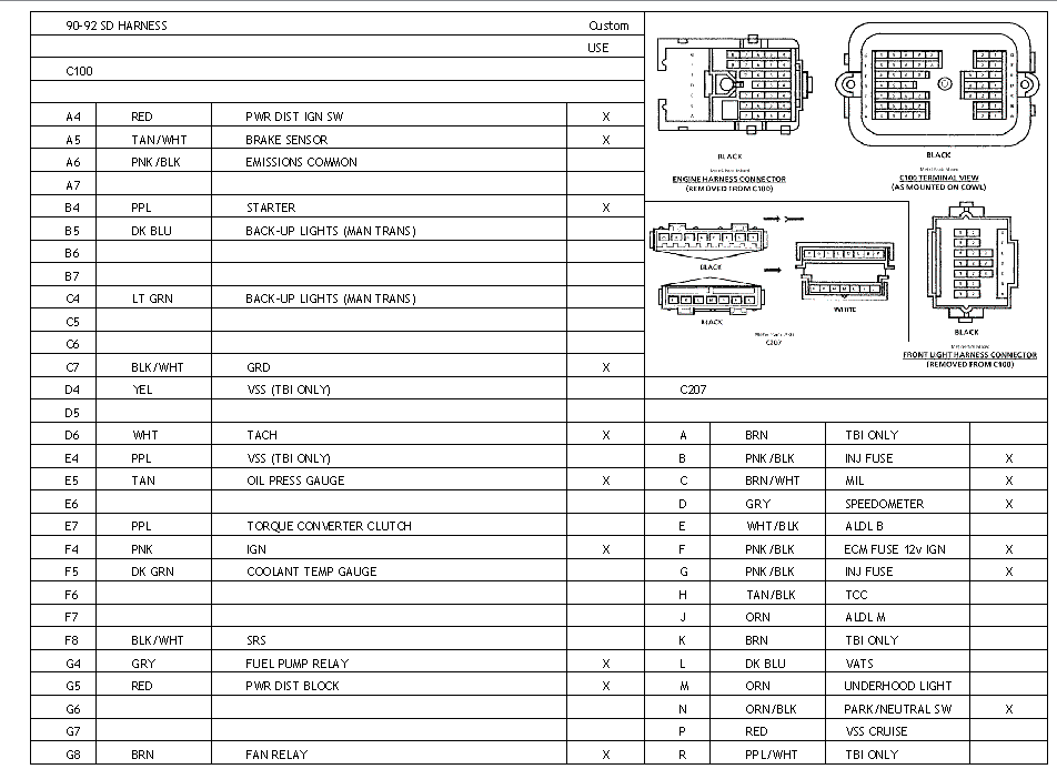

im prob gonna take eletric out n put a basic mechanical pump. only because its quite. if i do decide cut my truck n take it out. What do i put on the top of the tank..to fill the whole....and what kind of hoses go into the pump....but i wanna just hook up the factory one with pump...easier just need to know how to do it! to make it alittle easier to undertand...these are the wires i still have...i went by this chart.
