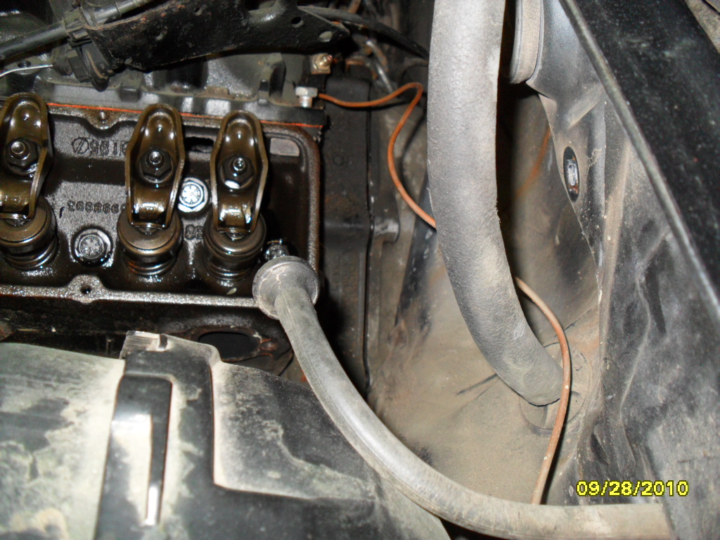

ok some of you might have seen my paint thread i did for this car and I've gone back and forth on if i wanted to keep it.... I'm keeping it i think lol anyway finally to the point of pulling the motor and getting the one I'm building in it. I'll admit I'm not a gear head but i like trying to do things like this. so please don't be to rough on me I'll try not to ask the really really dumb q's just the dumb and not so dumb ones. to start iv never pulled a motor before. i am mechanically inclined and have every tool under the sun just never did this. i have installed one with help(he worked and i watched) lol
i have it all disconnected(I THINK) motor mounts, flywheel(3bolts) trans to motor(5 bolts) and all the hoses and wires. where i'm nervous now is getting the motor and trans to seperate so i can lift. i lift it up and it comes apart about 3/8's and the trans hits the car at the top. is this just a matter of it popping apart and i'm being to careful. I'm going very slow with this and just trying to do it right and not break anything. even bought a cherry picker that WONT GO IN FAR ENOUGH grrr that really sucked lol so now I'm using a come along. anyway please chime in.
thank you

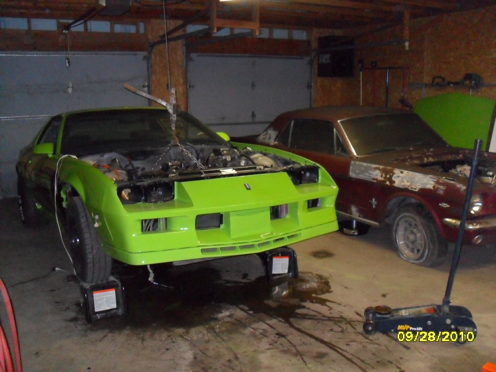

couple more pics just you guys get an idea what and how i'm working with this.

If what you meant was that the trans and engine split apart about 3/8" then likely whats happening is the bellhousing on the transmission is getting hung up ontop of the flexplate(flywheel).. pry them apart a little more and they should come apart. If you can slide the trans back that would help.

i did'nt unhook the trans at all, the cross member or torque arm... should i? again sorry if i ask stupid questions i just don't want to break anything and I'm in no hurry. i even stopped last night so i could post this thread and get some input. i have plans of really making this car nice so i'm just taking my time. i know body work and stuff like that just kinda new to the real wrenching.

yea unhook the trans

ok i'll unhook the trans *sigh* i was hoping to not have to just cuz it looks like such a pain with that torque arm and stuff. oh well i dought if it would have lasted long with the motor i'm putting in anyway. maybe i'll just pull it and go have it built to hold up. thanks for the tips guys.

Yeah unhook the trans and crossmember. Watch out for trans lines and wires. The more stuff you have out of the way the easier the job will be. Go slow and you will be ok. I pull motors all the time and have removed and installed motors in many thirdgens. FYI if the trans is stock I would pull both the motor and trans and have it beefed up now and be done with it. imo

ya i thought about just having the trans beefed up. it is still stock and i dont think it would last long with the motor i'm puting in it. i did get it out last night, i took my time and it went very well. now the cleaning and painting begins. i'll post some pics as the progress happens.
