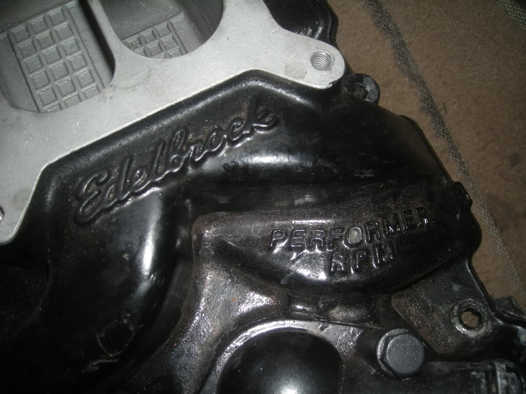

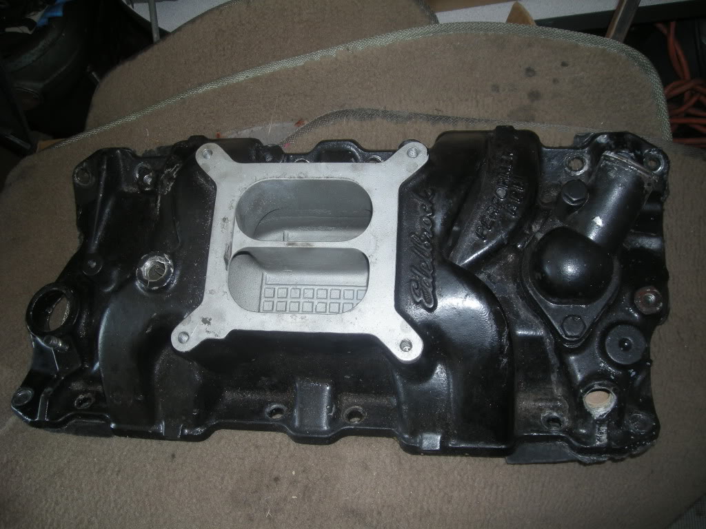

Yeah I never buy from jegs, its always either Summit, Ebay, or craigslist. They're life savers. Speaking of which, check out the deal of the day! I just bought this off craigslist for $30!
Awesome, just saved me $120!

yeah man thats a sweet deal, I got mine off CL too mine was more expensive because it was for vortecs but still a steal @ 75$
