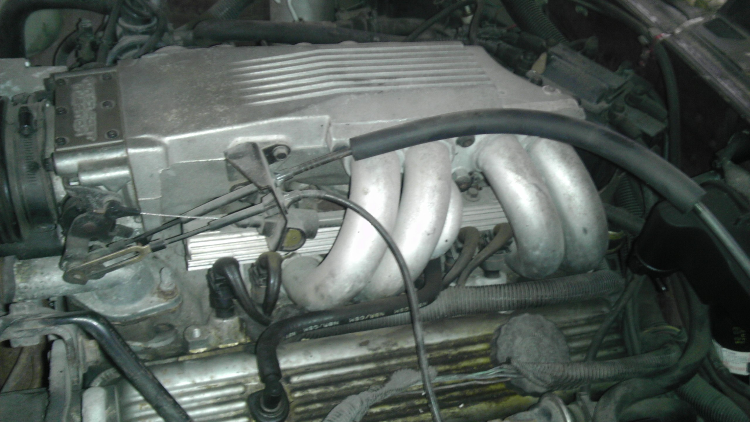

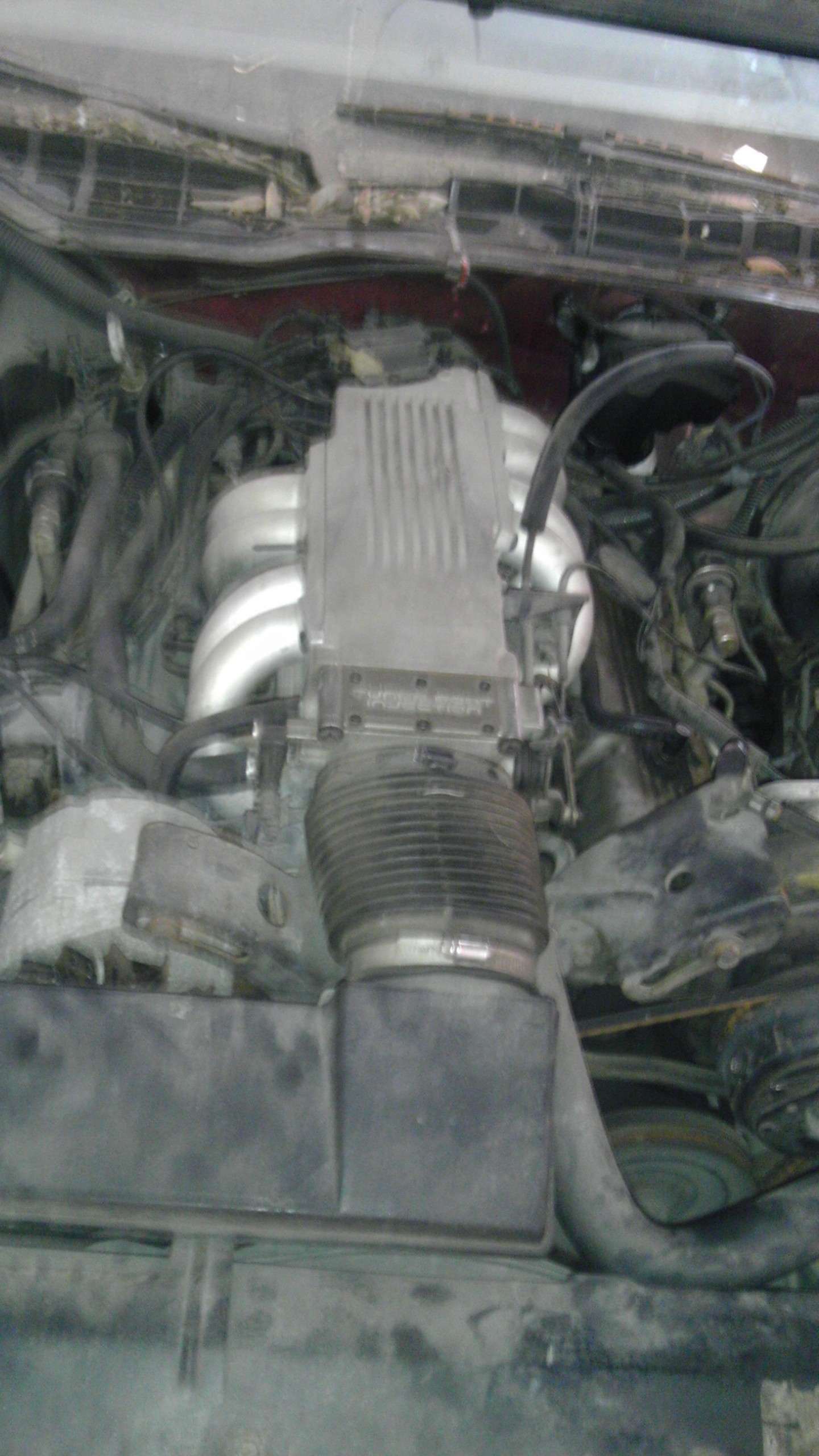

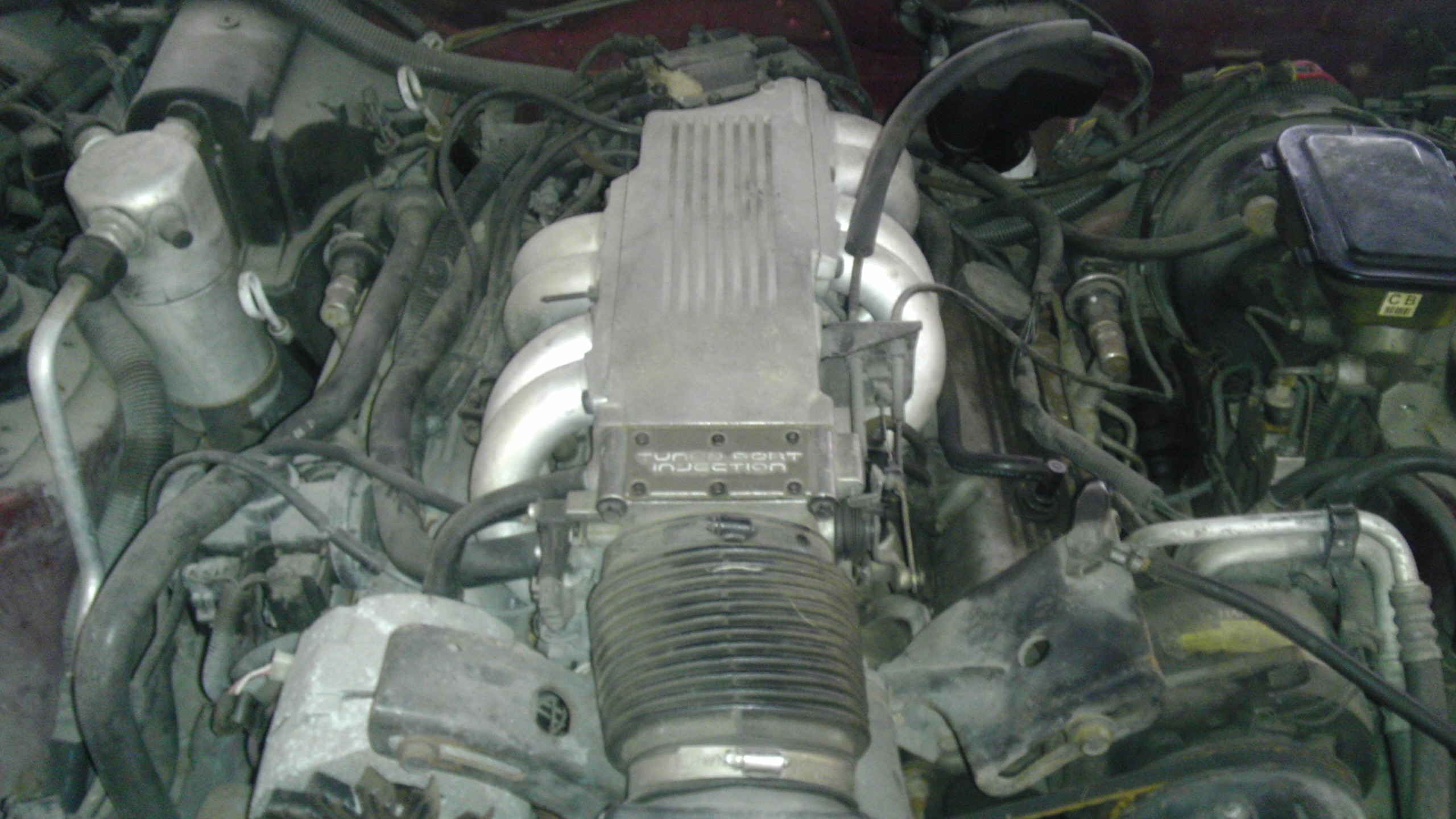

I have an 86 T/A which I drove in high school and after seeing this site, I have been inspired to rebuild the car. I tried searching the engine via vin number only to find it is not the stock motor in it. Can you sages tell me what kind of engine this is or what I have to do to find out which engine I have?

You're sure it's not the original? If it is, it's a 305 LB9.

You really need to check the block castings on the side or the back of the block to know what it really is, but it looks like either an LB9 or L98. If it's the factory engine it's going to be an LB9 305CID TPI engine. They didn't come with 350's (L98) in 1986. What's the 8th digit of the VIN number? This will tell you what engine the car originally came with.
Here is the breakdown of what the 8th digit of the VIN means as far as engines go:
2 = 151ci, L4 (LQ9)
1 = 173ci, V6 (LB8)[1985]
S = 173ci, V6 (LB8)[1986]
F = 305ci, V8 (LB9)[Tuned Port Injection]
H = 305ci, V8 (LG4)[4BBL]
G = 305ci, V8 (L69)[4BBL HO}
