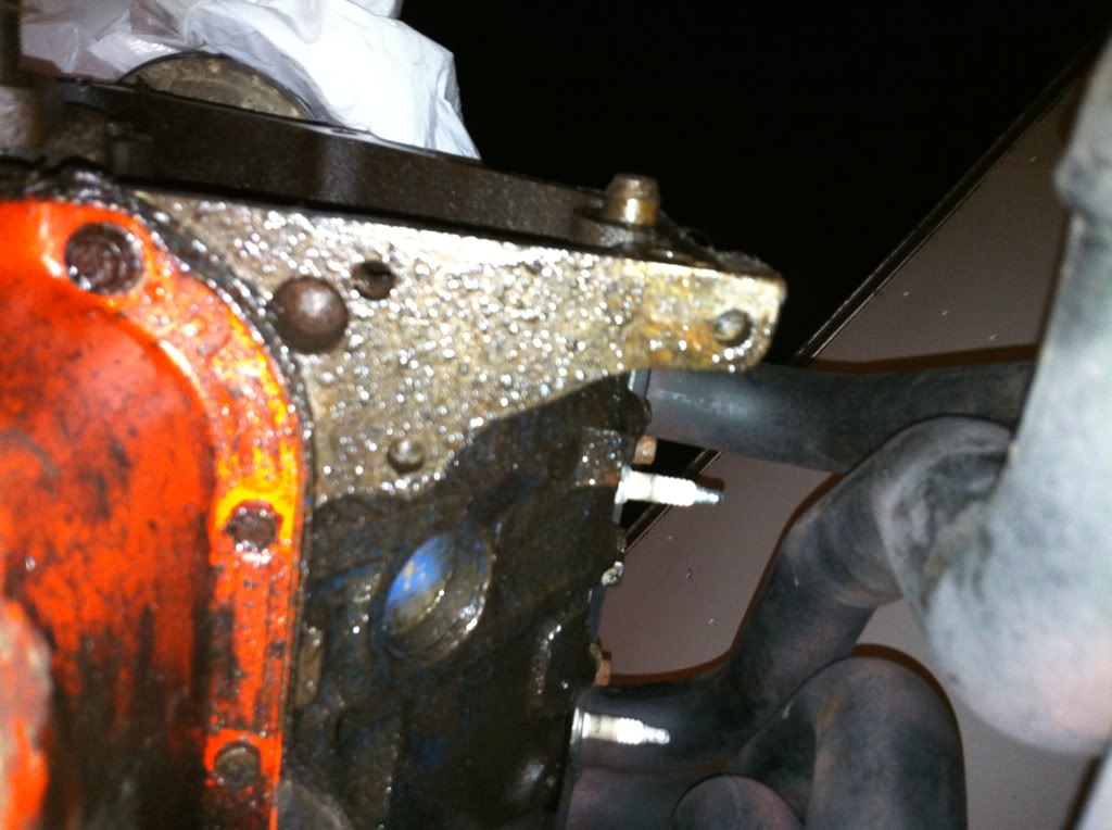

Posts: 219
Re: sbc to t5 problem, need a fly wheel.
Yup, 83 - 85 305 V8 one will bolt right up. You'll find there are 2 choices; 22 lb and 16 lb for the base-model LG4 and the high-perf L69 respectively. You'll probably want the light one.
Make sure your block has the right bolt hole for the starter required to use the small flywheel, BEFORE you install it in the car. Do a search on this forum for my userID and the words "starter bolt hole" and you'll learn why.
Is this right?
Old Sep 26, 2011 | 07:59 PM
travis401's Avatar
Joined: Mar 2007
Posts: 3,525
From: Arlington, Tx
Car: 91 Camaro RS
Engine: empty bay (for now)
Transmission: Built T-56
Axle/Gears: 3.42 stock posi disc
absolutely

Old Sep 27, 2011 | 05:55 AM
Posts: 28,025
Likes: 2,496
Yes that has the correct hole. You're in luck.
Here's a 400 I drilled it in. Blocks from before about 78 or so don't have it; a few have a different one, farther from the crank, where the 2 cyan lines intersect, but that one won't work for what you need (even if it was there) because a bolt that would go through the starter and into that hole, would have to go RIGHT THROUGH THE MIDDLE of the starter drive, because the starter has to be 5/8" closer to the crank for the smaller flywheel, than it did for the larger one.
