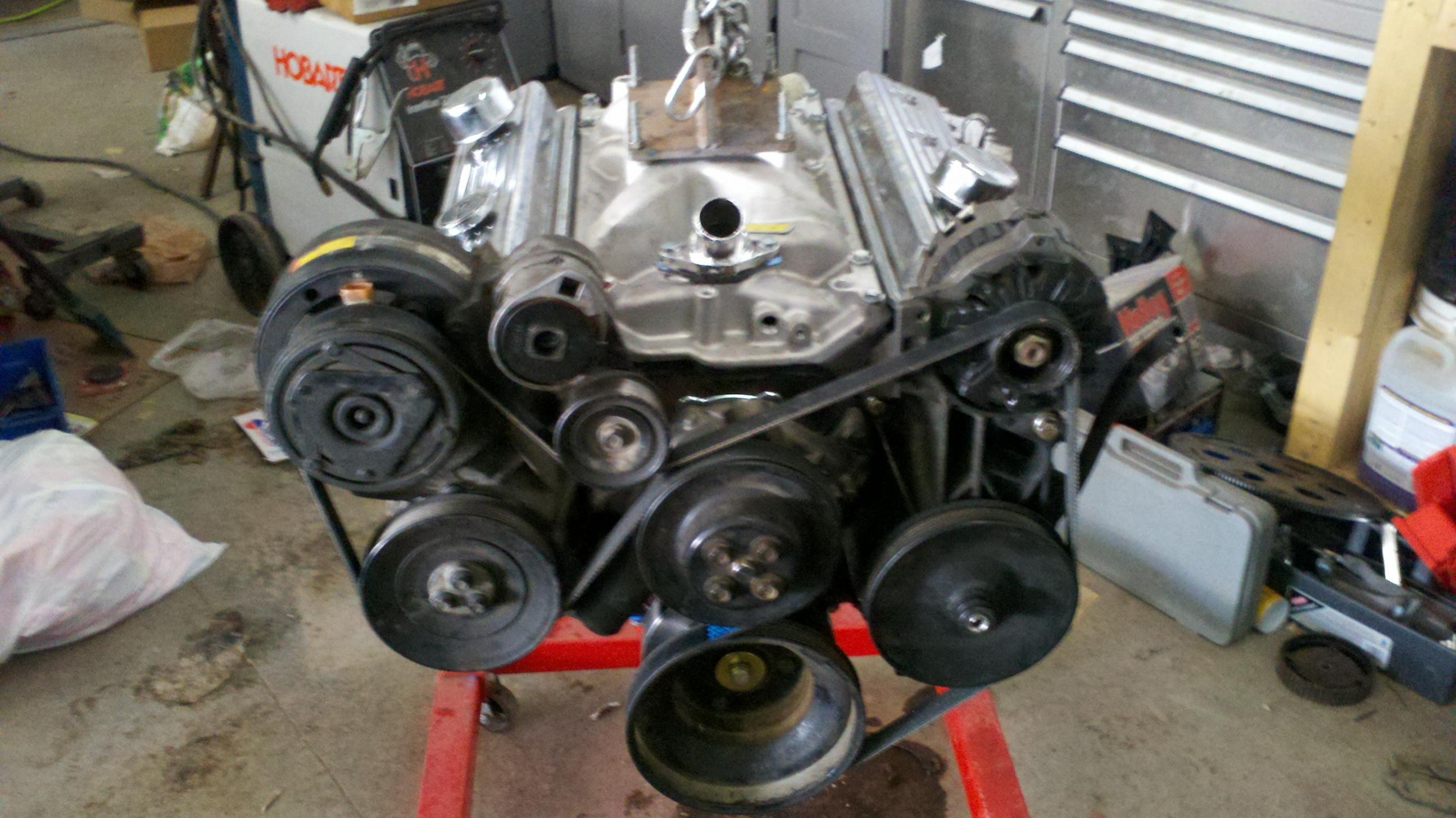

Re: 355 build/install
first pic is old 406 that the 355 is replacing
Attached Thumbnails 355 build/install-2012-03-30_13-23   355 build/install-2012-03-30_20-37   355 build/install-2012-03-30_22-28

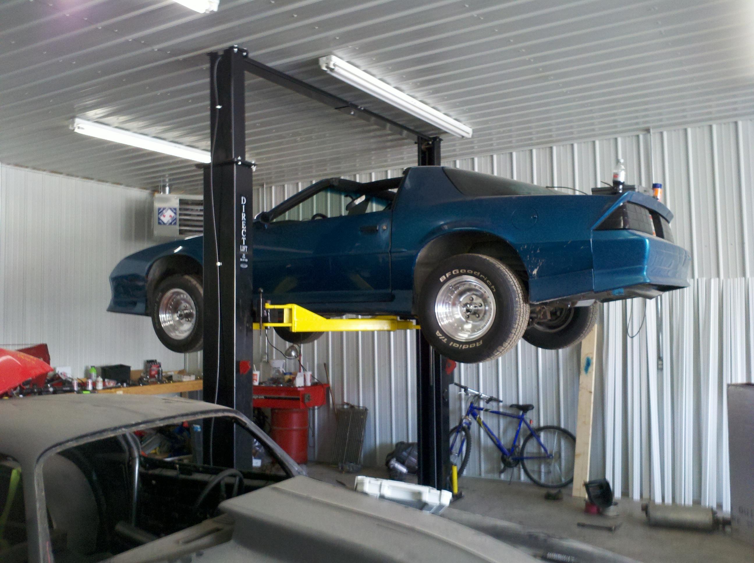

just a pic of the car, get more tomorrow
Attached Thumbnails 355 build/install-2012-04-02_12-07
2 out of the 4 cars in the garage now move under their own power
Attached Thumbnails 355 build/install-2012-04-16_19-16   355 build/install-2012-04-16_19-08
