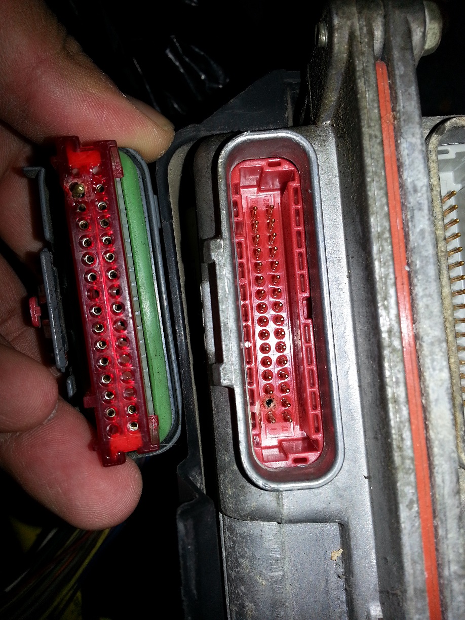

well I just bought this set up for 50 bucks ... and noticed that pin 2 on the PCM side was missing ... well it was in the correct connector but on the harness side? is this a big problem?? its the PCM ground .
the red connector .. and I've been trying to upload but it won't let me ...

i was confused what the question was until i looked really hard at the pic.. the pin pulled out of the pcm.. that means the pcm is junk- get another one.

Yeah I thought the same thing .....I opened the pcm up and the pin was still intact just broke at the bend can it be solder back on to the other half? The rest of the pin is on the circuit board still with no damage

You can always solder yourself a wire to it and just connect it manually to the harness
