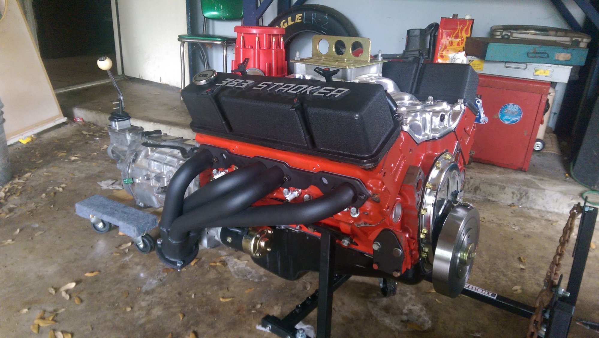

Vortec 383 with the LT1 T56 (the complete T56 came with crossmember, torque arm, pedals, hurst shifter & SPEC stage 4 clutch & pressure plate for $1000!)
Everything assembled.
Under carriage view.

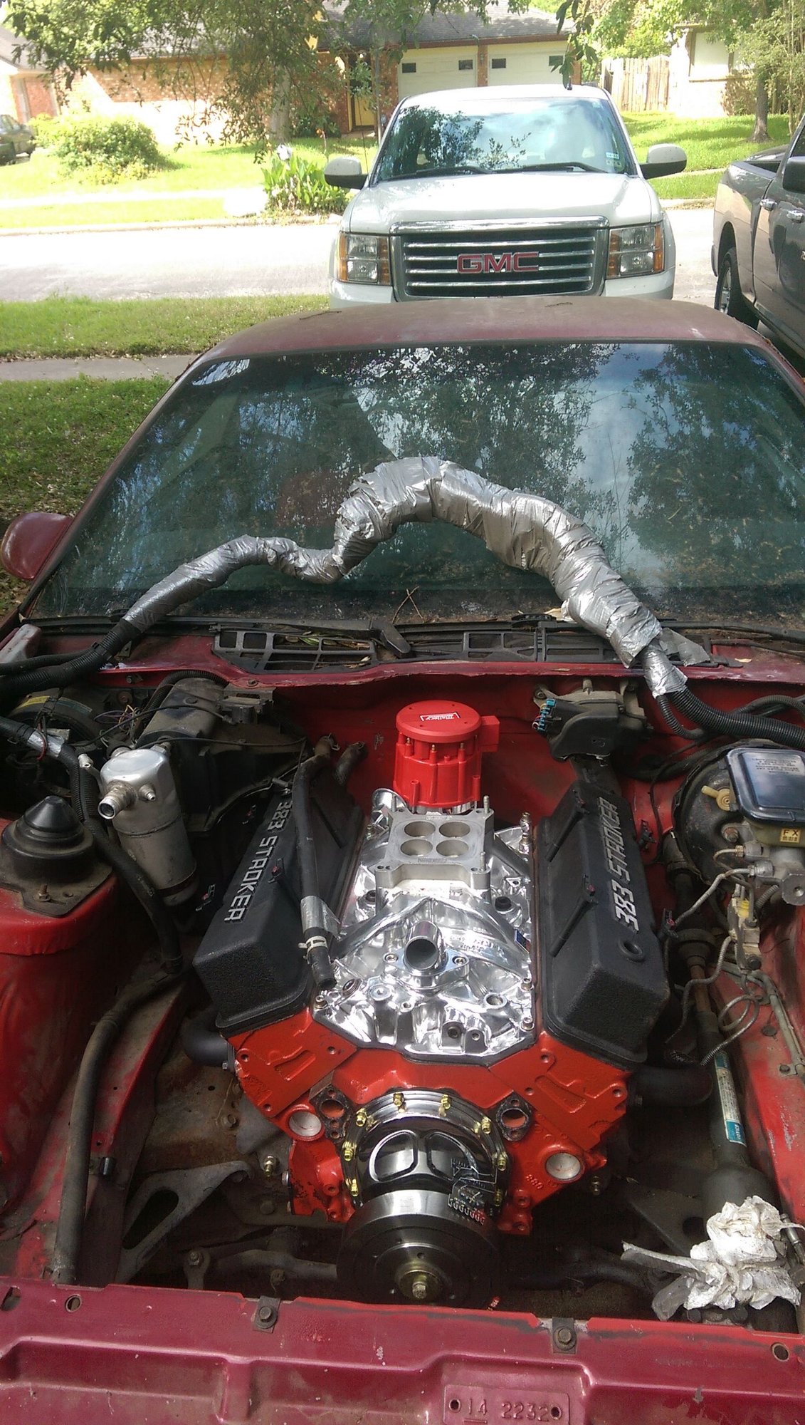

Octopus Plug Wires.
AFPR Setup.

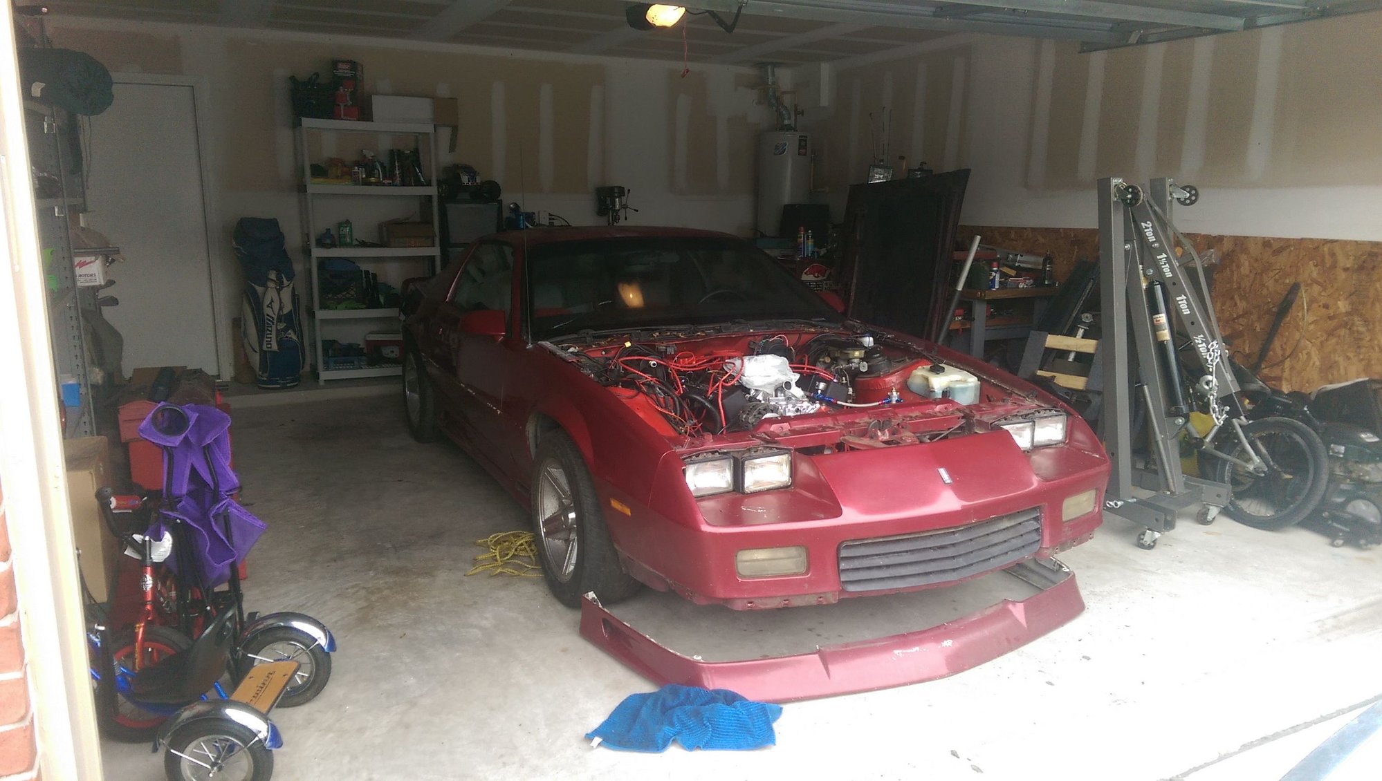

Bought new house. Janelle finally has a home.
Taken last night.
Almost finished. Few more parts are on the way. <br/>The serpentine routing was done according to a (super ultra snazzy belt routing) thread from a few years ago.
This weekend will be the first test run with all the new gear!

What headers r those?
Reply 0
Jul 27, 2015 | 09:01 AM
Re: A few Images of My 383 & T56 Swap.
Hooker 2460HKR.

What's the specs on the 383?

383 Specs
98 Vortec block
Scat Cast 383 Crank
Scat I-Beam 5.7 rods
Speed Pro Pistons 10.5 CR
Vortec heads - PRW 1.6 RR
Comp Cam 282hr
Edelbrock Performer RPM intake
Mallory 85 Series (coil in cap) Distributor
Edelbrock 750 Carb
Was put on the dyno at Owens Racing in Pearland, TX. 400hp & 450tq.

Jul 27, 2015 | 10:14 AM
Got everything together on Friday, Took it out for a spin this weekend. Other than the temp reading a little high, I had no issues.

Aug 22, 2015 | 07:50 PM
Just a note for you, that fuel line from the regulator across to the engine appears in the photo to be a fire hazard just waiting for a little heat from the hedder and the movement of the engine to melt the car down. It looks neat, but I would use several more inches of hose routed differently.
Reply 0
Aug 22, 2015 | 08:41 PM
You are right, it appears that way. But, it's not. It's pretty similar to the stock routing actually. That hose goes all the way to the carb with no hard attachments to the engine. Around 3ft of SS hose was used. A 90° fitting was used by the valve cover, which gives it the look of it being tight.
Unless it's a failure of quality, there won't be any issues.
